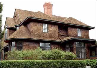

One dormer I frequently use is the "Nantucket dormer" — a sort of hybrid between a shed dormer and a doghouse dormer. We call it a Nantucket dormer because it's rumored to have been developed on Nantucket Island, where it's a common roof feature on many homes. But you can also find this dormer style used throughout New England on old houses.
Figure 1. A Nantucket dormer provides the headroom of a shed dormer with visual appeal of two doghouse dormers. Here, it is used to define one side of an entire house, where a plain shed dormer would have been too boxy.
I like this style because it allows me to get the practical utility of a shed dormer, for enclosing space, along with the visual interest and traditional look of doghouse dormers. From the exterior, it looks pretty much like two closely spaced doghouse dormers. However, the Nantucket dormer creates a larger clear space on the inside, defined by the area under the two doghouse roofs combined with the shed roof that connects them.
A typical use for this method is to open out a piece of usable space in a room over a garage. It's useful wherever you want to build a large dormer into a roof but would rather not have a big, clunky-looking shed dormer. I've even used this element on a grander scale, as shown in Figure 1, in which one whole side of the second story of the home is framed out as a double set of hip-roofed dormers joined by a center shed roof.
