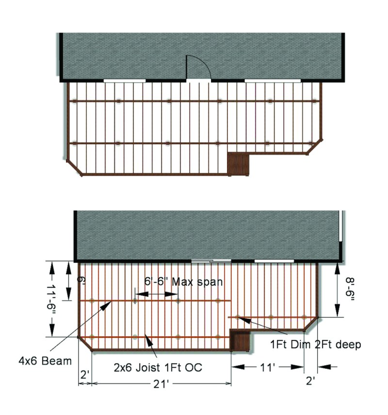

A common weak spot for all the software was the framing drawings. While most do an adequate job automatically filling in the framing, they tend to hiccough when the deck isn’t a simple rectangle. In the drawing at top, the deck bumps out, but the software continued the main beam straight. The drawing on the bottom shows the manual changes that were needed.

With all the programs except SketchUp, you can create construction drawings for simple decks by drawing a perimeter and having the program automatically fill it in with elements like joists and beams. The quality of this feature varies, though. We also found that when the deck had angles or offsets, the automatically placed framing elements didn’t always end up where we would have placed them. For example, most of the programs don’t adjust the location of the main beam if the deck bumps out — you have to move it manually (see drawings, facing page).
At complex framing design, Chief Architect is the best of the bunch. With most of the others, we found it faster to “draw” the members and place them with a mouse click. In SketchUp, everything has to be drawn manually, although over time you can build a library of parts you’ve drawn.

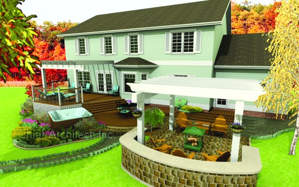

Chief ArchitectChief Architectchiefarchitect.comCost: $2,200
Chief Architect is a comprehensive program geared to residential and light construction and is one of the most popular programs for builders on the market. If you only do decks it might be more than you need, but if you also do additions, porches, and interior work, this software is hard to beat for the money. Chief Architect is better at 3D modeling and is a little more user-friendly than its main competitor, SoftPlan, in our opinion.
For generating framing drawings automatically, it’s the best of the programs we tested. We usually needed to make some changes, but they were easily done. Its out-of-the-box 3D renderings weren’t the best. Used with Raytracer, a free download from Pov-Ray (povray.org), it gives a decent rendering. (The manufacturer also offers its own raytracing engine, Chief Architect Raytracer.)*
Overall this is an impressive program. Chief Architect has a great community of users, and you can ask them for help or just learn by reading the forums. There are also tons of training videos and seminars online. You won’t be disappointed.

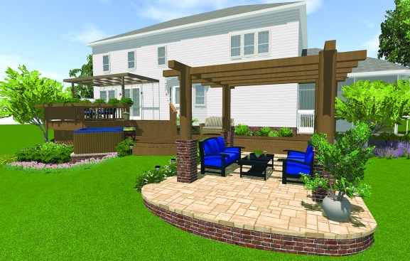

Realtime Landscaping Architect 2Idea Spectrumideaspectrum.comCost: $250
This program is powerful, particularly as a sales tool, at a bargain price. It creates amazing renderings of houses, decks, patios, water features, and gardens. To get a client’s attention, use it to make quick 3D renderings, which you can display as snapshots, a slideshow, or a walk-through movie. You can control shadows, lighting, and flowing water. The library of symbols, trees, shrubs, furniture, and patios is extensive — plantings are specific to your zone. Buildings can be created to show a realistic view of the design, and pergolas or patio covers that obstruct the view of the deck can be edited to make them transparent.
It is a landscape program, however, so the deck options are fairly limited, especially the railing. Some deck builders may find it doesn’t provide enough detail of the actual deck components.
Also, you won’t get a permit with a 3d rendering. Landscaping Architect can create a framing drawing, but we had mixed feelings about the result. Some of us felt it was too basic and switched to a program that’s better at creating construction plans, such as SoftPlan or Chief Architect. Others felt it was adequate, although you need to create your own beams and posts and place them where you want them. And if you don’t like the automatic framing drawing, the only way to change it is to turn it off and draw in your own members.
