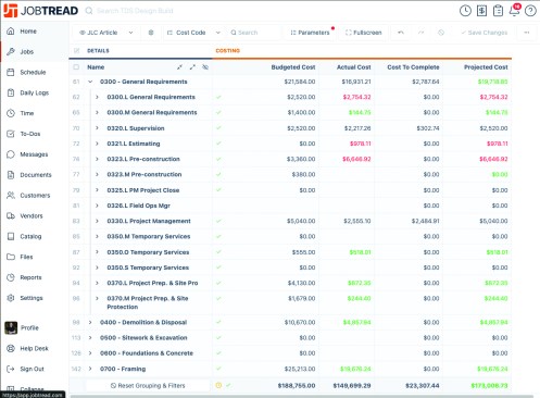

Coded COGS List
A clean COGS list is a prerequisite for clean job costing later. It should read like a ledger broken down by cost codes for your core project tasks. At TDS, we have 25 cost codes, seven of which focus on our self-perform work:
0300-General Requirements
0400-Demo
0700-Framing
1200-Decks and Porches
2100-Interior Trim
2200-Cabinetry
2300-Specialties
We break each cost code into four categories:
.L — Self-performed labor
.M — Materials
.S — Trade partners/subs
.O — Other costs (permits, rentals, testing, etc.)
This structure aligns our estimating spreadsheet with Job Tread’s job-costing system, which means that once a project is sold:
Labor flows into the Job Tread system from time cards.
Materials and Other flow in from receipt and invoice uploads.
Trade-partner costs automatically log from bills and purchase orders.
This screen shot demonstrates how the author’s cost-code structure for COGS aligns with Job Tread’s job-cost system.

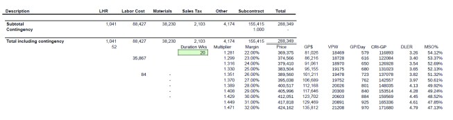

Gross Profit per Day
Next, we run the estimate through GP/day, the metric that ties revenue to the company budget. The formula is straightforward:
GP/day = annual gross profit target ÷ 365 ÷ number of concurrently running projects
Applying this formula effectively requires an understanding of your company’s capacity. While kitchens, baths, dormers, and small additions generate similar VPWs, their varying durations mean they realize different amounts of gross profit if a common gross profit percentage is used. For example, if the following are all priced at the same 32% margin:
A $175,000, 12-week kitchen project yields $667 GP/day.
A $110,000, 8-week bath project $628 GP/day.
A $250,000, 16-week addition project yields $714 GP/day.
A $125,000, 8-week dormer project yields $714 GP/day.
Running these jobs in a consistent loop could generate $2,723 in GP/day, but that requires always having a larger anchor project with a higher GP/day to offset the low GP/day of the smallest project. For us, GP/day is non-negotiable. If the projected duration and projected gross profit don’t meet our GP/day target, the job will choke the business financially. Nine times out of 10, that means the margin needs to increase. Let’s look at these examples again but with an equalized GP/day of $681:
The 12-week kitchen project costs $176,183 at 32.5% margin.
The 8-week bath project costs $112,936 at 33.8% margin.
The 16-week addition project costs $246,272 at 31% margin.
The 8-week dormer project costs $123,136 at 31% margin.
This summary of one of the author’s estimates demonstrates how VPW, GP/day, and other metrics provide data to improve decision making when applying margins.
