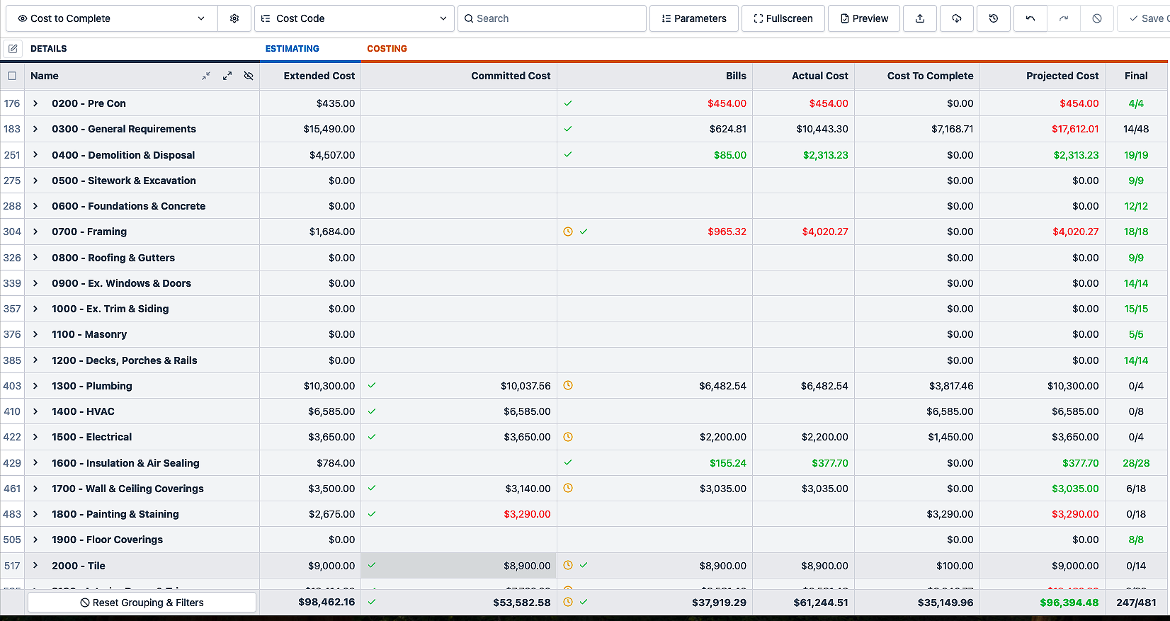

At our company, CTC is owned by the Project Manager. When a PM marks a line item “complete” in our job costing system, they are making a very specific judgment: no additional meaningful costs—only those less than $1000—remain on that scope. That judgment isn’t based on a formula. It’s based on the PM using their knowledge of scope, labor performance, and trade partner invoicing to record costs against an estimate set up with job costing in mind.
Some job costing programs or spreadsheets allow you to give a line item a specific completion percentage, but JobTread, the program we use at TDS, only allows a done/not done input. At first this limited our CTC effectiveness until we devised a system of using internal change orders to add cost to the project estimate. CTC is not about being right at bid time; it’s about being honest as reality unfolds.
Click to enlarge image below.
The JobTread cost to complete budget view provides the cost to complete adjustment for the WIP by subtracting the bills in real time from the estimated project cost. All change orders, including internal ones, are accounted for in the extended cost.
Effect of Change Orders
When we become aware of additional costs we add them to the job immediately. Sometimes there’s margin attached. Sometimes there isn’t. Either way, the job’s cost structure reflects what we now know to be true today, not on the day the project was sold.
I believe that this is where many companies go wrong. They delay acknowledging cost changes in the hope that labor will make it up later. All that does is distort CTC, which then distorts the WIP, which then distorts revenue recognition on the P&L. By the time the job finishes, the financials tell a story no one recognizes.
That’s why internal change orders are important. They keep CTC honest, which keeps the WIP accurate.
