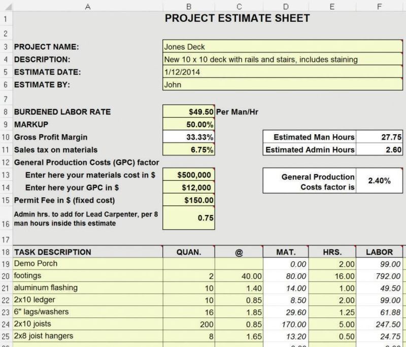

When an estimate is built in a spreadsheet, information such as burdened labor rate can be entered once and used in many calculations. It’s also easy to update totals when quantities or prices change. Free-form “Task Description” fields allow you to organize line items by phase, room by room, or in some other way that better suits the project.

Over time, I incorporated what I had learned from the yellow-pad method into an Excel spreadsheet that I created. The spreadsheet included direct costs to build the project—materials, labor, subcontractors, and equipment. And it also applied the markup I needed to cover labor burden and all of my overhead costs—the expenses I incurred just by being in business, whether I had any work or not. It not only improved the speed and accuracy of my estimates, it also provided most of the information the production team needed to build the job without my being on site—leaving me free to sell more work.
If you believe in design/build as a way of doing business, your estimating system should be a tool that facilitates how you do business, not just a way to get to the price. Typically, a yellow pad and calculator won’t suffice here; you need a computerized system that allows the estimator to concentrate on estimating, not on adding up numbers over and over again. The system should also allow for on-the-spot “what-if” adjustments. The estimator must be able to quickly estimate the effects of changes or suggested alternatives to the project without having to worry about forgetting some component or corrupting earlier versions. This also helps qualify client decisions during design by providing instant feedback about how those decisions affect the project’s budget.

Keep Costs & Quantities Separate
Another formatting consideration is how to break apart the information for each line item within your estimate. Rather than entering lump-sum amounts for materials and labor—such as total cost of wall studs or total cost of flooring and installation—separate the costs from the quantities. By formatting your information in this way, you can quickly apply what-if options for material substitutions, changes in room size, or additional labor requirements. This also facilitates quick pricing updates when a client calls back two years later and wants to go ahead with a project. There’s no need to redo the entire estimate because you’re not sure how the lump sums were determined—the quantities will likely still be the same. Just check for pricing changes.
