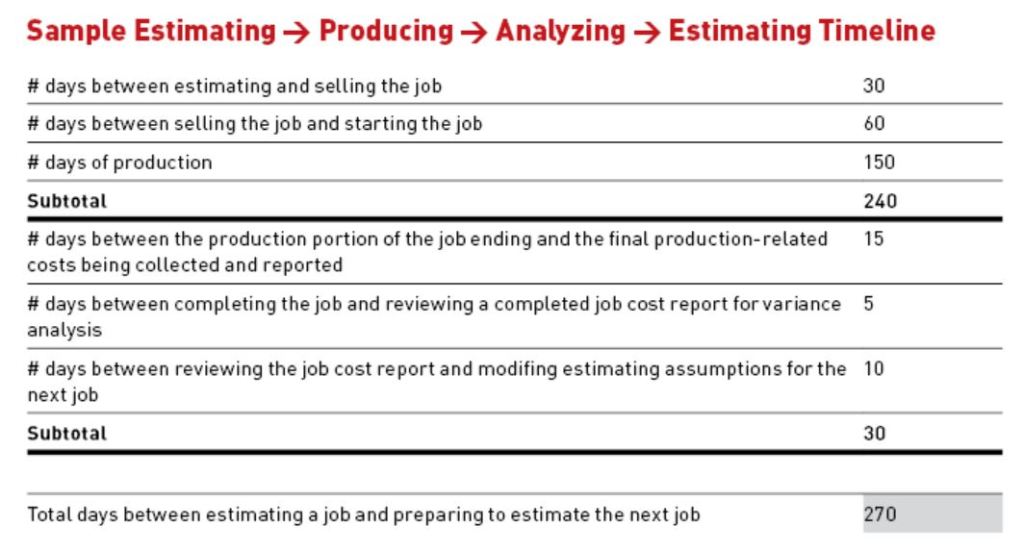

So, how far in advance should you revise your pricing to be sure that by the time your new costs hit, your customers will be paying for them? This requires that you consider the timeline for your company’s sale production process. Let’s look at the example described in the chart below.
In this case, it takes the company an average of 240 days to estimate and complete a job. To that must be added the time required to analyze the job and identify variance. Remember that for this initial job, the new costs haven’t been included. But, they’re coming. Therefore, in addition to the usual job of figuring out where the company lost (or made) money on a project, modifications must be made for the impending labor cost increases.
Let’s assume that there’s an average of 30 days from the day that production ends to the day that all the job costs come in (including those from your painting sub who takes forever to get you a bill) and your production staff can perform the job autopsy, identify slippage areas, and decide how to modify the estimating assumptions moving forward. That means that the entire process takes 270 days.
If the average project length is 150 days, and the first job of the year is sold on January 1, and the revisions to the estimate don’t occur until day 270 (September 27), then the first estimate properly modified to meet the new labor cost requirements would be available no earlier than September 27. If the average job length is 150 days, then that job will be in progress on January 1 of the following year and therefore must be estimated using the new criteria.

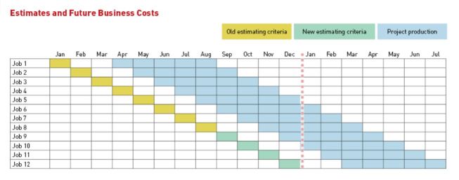

If you work on only one job at a time, there’s no problem. But what’s been going on in the meantime, between that first estimate on January 1 and when you start using your new estimating criteria on September 27? Why, you’ve probably been estimating and selling more jobs at the old rate, right? If you sell one job a month (using the arbitrary project durations in the chart), then you might find yourself in the situation shown in the calendar above.
The red line represents the date on which the new costs go into effect, so ideally all projects that include that date would be estimated according to the new parameters. As you can see, Jobs 6 through 8 extend into this time period but were estimated according to the old criteria. Given the increase in labor costs, these jobs should produce lower-than-anticipated profit.
The key here is not to get hung up on your selling cycle, job length, or job-cost-analysis schedule, but to understand that if you want to cover costs that will occur at a predetermined date, you should be thinking farther ahead when setting prices. And, the longer the duration of a project, the more critical it is that the job be sold at a price that encompasses intended cost increases implemented within the scheduled duration of the project.
