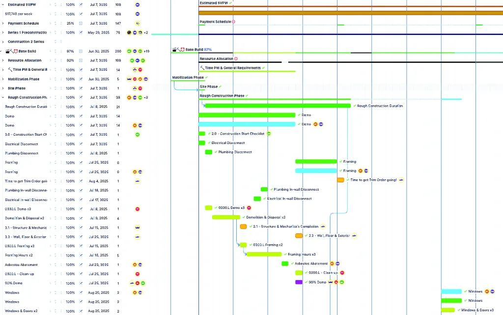

Layer 2: Phase Duration (Owned by the Build Coordinator)
Once overall duration is set, our build coordinator, Phil, uses the Phase Cost Summary from our estimating spreadsheet to break the single duration bar into phases. The Phase Cost Summary allocates cost codes across the project’s construction phases—Mobilization, Site, Rough Construction, Rough Mechanicals, Exterior Finishes, Interior Finish, and Completion—and applies our VPW data to calculate the expected duration of each phase. Phil will introduce buffers based on his perception of how the construction phases may run in parallel.
Phil owns this layer because he lives in the intersection of procurement, cost data, and schedule structure. He knows what a Rough Mechanicals phase costs on projects like this one, and he knows how that cost translates to weeks of production given our trade partner capacity. I don’t carry that level of phase-specific detail in my head, and the lead carpenter shouldn’t have to build it from the drawings alone.
The output of this layer is a high-level Gantt chart in JobTread: one bar per phase, sized to the expected duration, arranged in the sequence the project will run. It’s not a finished schedule. It’s the skeleton on which the next two layers will hang.
Layer 3: Self-Perform vs. Trade Partners (Owned by the Project Manager)
The project manager, Kevin, takes Phil’s phase framework and refines it into a second layer of detail: which work TDS is self-performing and which work belongs to trade partners. This distinction matters enormously for scheduling because the two types of work have fundamentally different scheduling constraints.
Self-perform work—our demo, framing, and interior finish carpentry —is scheduled around our own crew’s capacity, which Kevin manages directly. Trade partner work—mechanical rough-ins, drywall, tile—is scheduled around the trade partners’ availability, lead times, and sequencing requirements, which Kevin has developed through the preconstruction buyout process. Kevin further refines Phil’s buffers and introduces additional buffers within the phases.
By the time Kevin hands the schedule to the lead carpenter, the project has a phase structure and a clear map of who is responsible for each scope of work. What’s still missing is the day-to-day detail of how the self-perform work unfolds onsite. That’s the one piece Kevin can’t build with confidence, because he won’t be on the site.
Layer 4: Boots on the Ground (Owned by the Lead Carpenter)
The lead carpenter builds the final layer: a day-by-day task sequence for the self-perform work, fitted inside the phase containers Kevin established. This is the schedule the crew runs.
