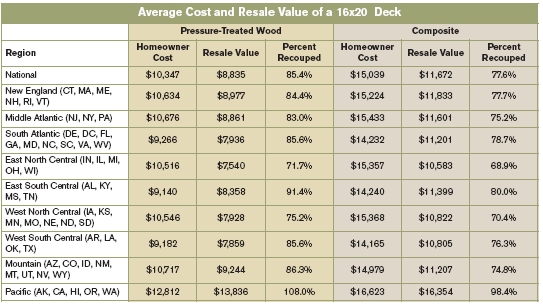

Some homeowners are hesitant to invest in home improvements in today’s uncertain housing market, worried that they would be pouring their money into a black hole of depreciating real estate. But the “Remodeling Cost vs. Value Report 2007” (www.costvsvalue.com) offers some numbers that could help win over this group.
The study compares the homeowner’s cost for 29 remodeling projects with what those improvements would add to the resale price of a house. Both wood and composite decks fared well in the latest version of the report, which was released in November by Remodeling magazine, a sister publication to Professional Deck Builder.
In the previous version (2006) of the report, researchers had looked at only one deck project: a 16×20 deck supported by 4×4 posts on concrete piers, constructed with pressure-treated joists and composite decking and matching railing. Other features included a three-step stair, as well as a planter and a built-in bench made with the same material as the decking. The deck was classified as a “midrange” project because of its simple design and small size.
Recognizing that pressure-treated decking is more common than composite decking, the designers of the 2007 study added a second deck project, exactly like the one described above except with pressure-treated wood substituted for the wood-plastic composite. It was classified as a “midrange” project and the composite deck was then reclassified as “upscale” because of its relatively higher cost.
Nationally, adding a pressure-treated-wood deck beat out most of the other remodeling projects examined in the study, as homeowners could expect to recoup, on average, 85.4 percent of its cost at resale. Upscale fiber-cement siding replacement had the highest national cost-recovery rate (88.1 percent). An upscale composite deck had a somewhat smaller return nationally, at 77.6 percent. For comparison, a homeowner could expect to recoup 78.1 percent of the cost of a major midrange kitchen remodel.
Regional averages vary depending on climate and market factors — and it’s important to keep in mind that within regions there may be variations between states and even neighborhoods. For both pressure-treated wood and composite decking, the lowest average return was in the East North Central region (71.7 percent and 68.9 percent, respectively). The highest return was in the Pacific region (108 percent and 98.4 percent, respectively), where some homeowners can even make money from adding a pressure-treated deck.
The cost estimates for the various projects were provided by Bethesda, Md.-based HomeTech Information Systems (www.hometechonline.com), a designer of estimating software for remodelers. Costs for labor, material, subtrades, and contractor overhead and profit — adjusted for regional differences — were included in the estimates.
The estimated resale value of the improvements is based on information collected from more than 2,700 surveys returned by Realtors nationwide; respondents were directed to assume the remodeling project had been completed recently. — Laurie Elden
