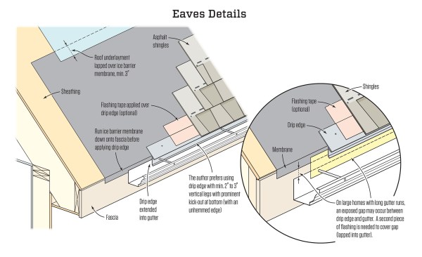

We use an ice barrier membrane at all eaves and in all valleys. At the edge of the roof, we call for the membrane to be folded over and adhered to the fascia board, lapping down onto the fascia about an inch. Depending on the manufacturer’s spec, some roofing materials may require an ice barrier membrane on the entire roof.
By code, the membrane has to extend inboard of the exterior wall by 2 feet. As a rule of thumb, we expect to use two courses of membrane if the roof overhang exceeds 8 inches.
Click to enlarge image below
If ice barrier membrane goes down before fascia, some types can be run wild over the plywood edge and bent down later. Others are too flexible, so the release paper needs to be left on to protect the last few inches of adhesive. It can be carefully sliced and left attached, or pieces of it can be re-adhered to the bottom edge of the membrane.
Tim Healey

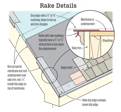

Drip edge is installed along the rake to keep out wind-blown rain. In Virginia where the author works, installing it isn’t required by code, so roofers have to be specifically instructed to install drip edge.
Tim Healey

Underlayment and Drip Edge
Ideally, fascia board will be installed before the ice barrier membrane to facilitate adhering the membrane to the fascia. Our practice is to install the membrane next, then install the drip edge over the top of that. As an option, we may specify a strip of peel-and-stick flashing tape over the top edge of the drip edge.

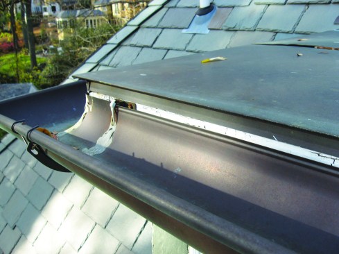

Drip edge that doesn’t hang into the gutter can direct water behind the gutter and soak the fascia and soffit, as shown above.
Our standard gutter install is to tuck the gutter under the drip edge, and place the fasteners straight through both on the back edge. But on our larger houses, long runs of gutter sloped at 1/8 inch per foot may run out from behind the drip edge. In that case, we call for an additional strip of metal to bridge the gap between the drip edge and the gutter.

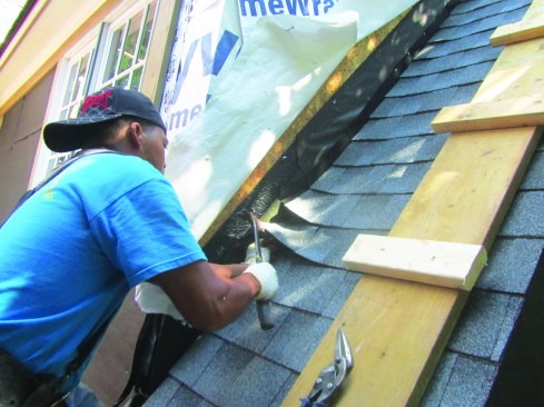

Wind-driven rain and snow can penetrate between step-flashing pieces and wet the sidewalls and the roof. So we instruct our roofers to run the ice barrier membrane and the roof underlayment up the sidewalls. We ask for 6 inches up the wall. Four is adequate, but asking for 6 allows for a bit of imperfect utility-knife work, and it’s easy to check if it’s been done even with the code-required 4-inch-tall step flashings.
To keep the roof and the wall dry, drainage-plane fabric (housewrap) on the wall needs to lap down over this roof underlayment, not run behind it. If the wall housewrap is already in place when the underlayment is installed, we instruct the roofers to slit the housewrap and pull it back, then reattach it over the roof underlayment.
A roofer has cut the housewrap at the joint between the roof and the wall, folding it back so that he can lap it down over the underlayment and step flashing, as the author recommends.
Synthetic underlayment and ice barrier membrane readily fold at this wall-to-roof joint. But the heavier asphalt felts have a tendency to crack if you try to fold them like this. So if we’re installing felt paper, we back it up with a peel-and-stick membrane at the corner.

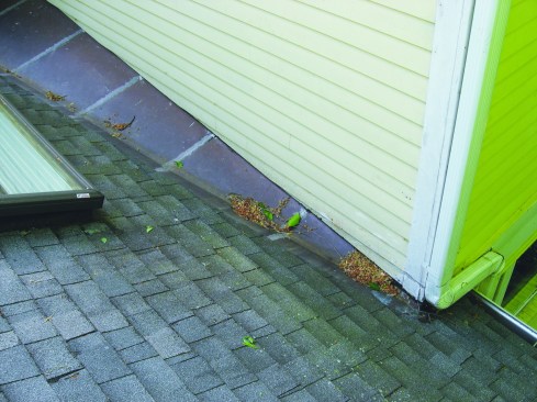

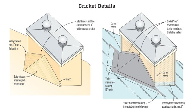

Frame cricket valleys (and valleys abutting walls) a minimum 2 inches from final finishes at corners to avoid trapping leaf debris at trim and flashings. At larger crickets and valleys, the distance from corner should be increased to accommodate increased volumes of water.
Tim Healey
Above, a cricket valley is trapping leaves and debris. Framing to allow more space at this location could help keep the valley clear.
Crickets and Valleys
Architect plans for crickets behind vertical elements such as chimneys often show the cricket terminating right at the corner of the wall. It looks good on paper, but in practice, this creates a trap for leaves and debris, blocking the flow of rainwater coming down the valley downslope of the cricket. So we coordinate with the framers to construct the cricket so the valley misses the wall intersection by a couple of inches, allowing a freer flow of water. This also makes it easier for the roofers and siding contractors to keep the valley flashing and the sidewall step flashing disentangled.
