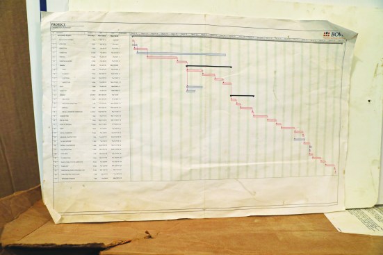

It’s the production manager’s role to create a master schedule for each job. We use Gantt charts, which we usually create using Microsoft Project (though for simpler projects, other methods are fine).
This Gantt chart from a long-running gut-rehab and structural remodel shows the wear and tear of daily use on the job. Down the left-hand column are listed job phases and tasks. In the field to the right are bars indicating the time each step will require. Start and stop times for job steps are staggered to indicate the order in which tasks have to be performed.

Gantt charts show the phases of a project as they progress through time, and they illustrate which ones need to finish before another starts, so they make a great visual guide to the whole project. For typical construction projects, calendar days are set out left to right. Construction activities are written in order down the left edge. The days we plan to do each activity are shown as a line or block on the calendar days, so a long activity will have a long bar, and a short one a smaller bar. When one activity has to finish before the other starts, they don’t overlap, so the “Foundation” bar ends before the “Framing” bar starts. The result is a set of lines generally running from top left (first activities at the beginning of the project) to the bottom right (punch-out at the end).
Normally, our activities are defined by the work that a crew or trade will do at one point, such as “plumbing rough-in,” “tile kitchen floor,” “main roof shingles,” and so on. The plumbers will be on a schedule more than once: “Ground works” is its own line because it happens separately from rough-in and final trim, which each get their own lines as well.
The “critical path” is the chain of all the activities that have to finish before each other to get the whole project done, and these tasks are the ones that need the most attention as we work the project. Of course, everything needs to be done by the end, but there are often a few activities that can happen in a wide window of time, because other tasks don’t depend on them; these are not on the critical path for the project.
