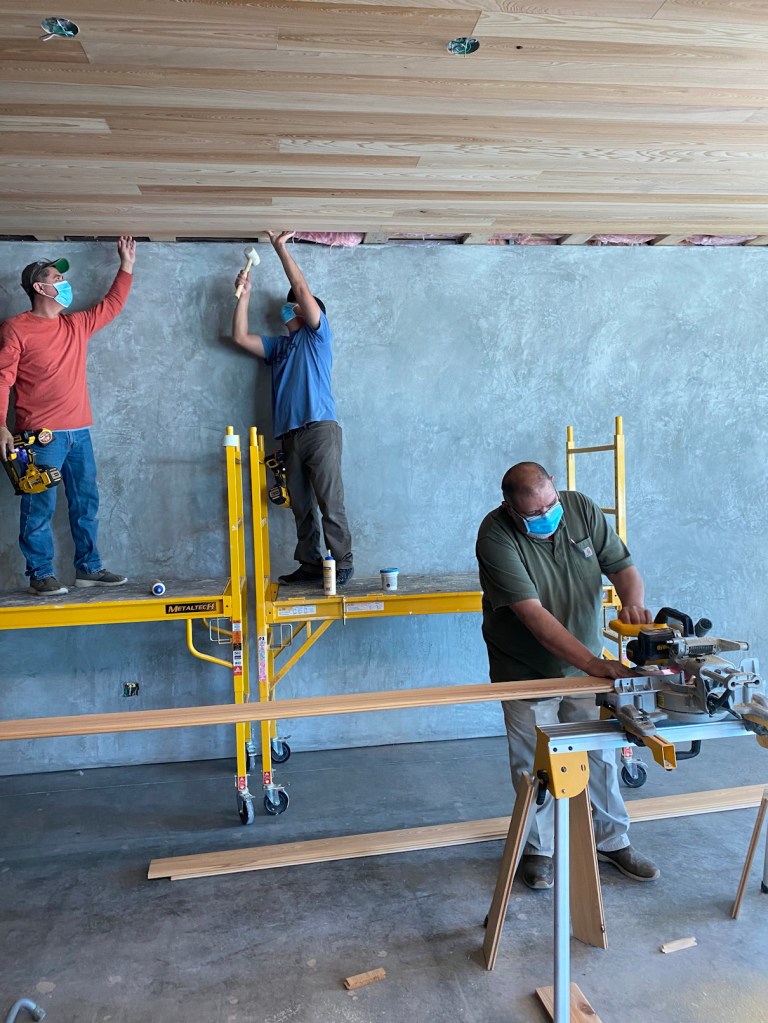

Workers for Risinger & Co. keep their distance when possible, and wear masks on the job, as distancing is not always practical.
