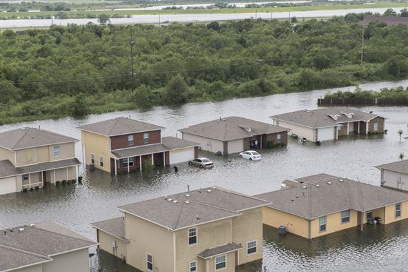

Hurricane Harvey made a second landfall on the Texas coast as a tropical storm this week, obliterating flood records and devastating coastal communities like Port Arthur. The New York Times had this report on Wednesday (see: "Port Arthur Faces Harvey Flooding Disaster: ‘Our Whole City Is Underwater’," by Jonah Engel Bromwich). As the storm finally moved inland, Houston caught a glimpse of the sun, but the city's flood crisis continued unabated. With access to the city still blocked by floodwater and with emergency responders still struggling to handle rescues, stockpiles of emergency supplies waited outside the disaster zone.
The damage toll is heavy. "Harvey flooded an estimated 136,000 structures in Harris County, or 10% of all structures in the county database, according to the flood-control district," reported USA Today on Friday (see: "In Houston, small signs of normal emerge from submerged city," by Bart Jansen. "The Texas Department of Public Safety says Harvey has heavily damaged or destroyed more than 55,000 homes."
