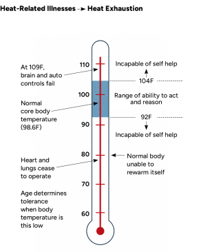

The human core body temperature is around 98.6 degrees F. That can vary slightly between individuals but in general that is where your body wants to be. When you start to get warmer than that, either from physical activity, the ambient temperature, or a combination of the two, your body will try to cool itself down in the following ways. You will start sweating and the evaporation of the moisture on your skin will release heat. Your heart rate will also increase, which helps pull heat from your core to the extremities. Connected to that, your blood vessels will dilate, resulting in increased blood flow. This, in turn, helps release heat by radiating it away from the core and aids in the sweating and evaporation process.
This all works well so long as nothing impedes the process, and so long as the exposure is not for long. The things that can get in the way of this are: high humidity that reduces the effect of sweating; restrictive clothing that constricts blood vessels and traps heat (creating a feedback loop where you keep getting hotter); and being poorly hydrated (if you don’t have enough fluids then your body can’t produce the sweat to cool you). In addition, poor cardiovascular health will make that increased heart rate difficult to maintain.

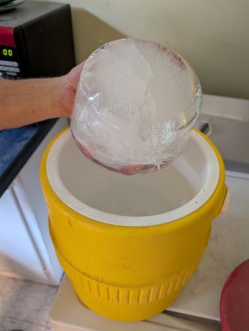

John freezes a pot of water and puts the block into his cooler for the day. A solid piece of ice like this lasts much longer than a few ice cubes.

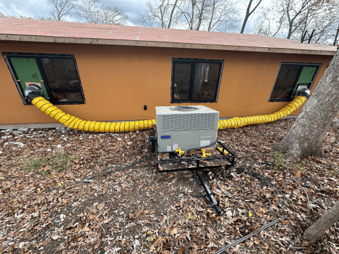

Jake’s onsite AC not only improves conditions for the crew but also helps productivity.
At my company we have a few ways to help our crews get through the summer months. On each of our work trailers we carry a pop-up tent for shade. This one took a while to become standard practice, but once one of our younger guys started putting it up the older crew members saw the value and made it a regular thing. We also carry box fans that the crews can set up on site. That can either be outside to give them a breeze or blowing up from the basement inside a home. In either case, it helps.
One of the bigger things we do is have air conditioning units mounted on landscape trailers. We put these on site and run temporary ductwork into the home (see photo). Since our homes are usually weathertight with ZIP sheathing, we can get the temperature in the house down from say the mid to high 90s to around 80 degrees F. This makes a big difference to our crews and helps bring in subs. When we can tell our subtrades that they will be working on an air-conditioned site they will generally prioritize our jobs. This has worked out well in keeping our jobs on time even during the hottest periods.
