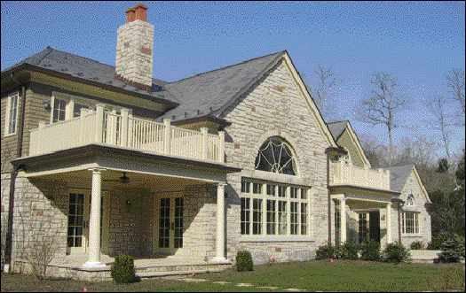

A $2.8-million knockdown: The Murphy residence — an 11,500-sq.-ft. home in Rumson, N.J. — exemplifies the work of Tim Cross (top) and the crew of Merrick Construction (bottom).
