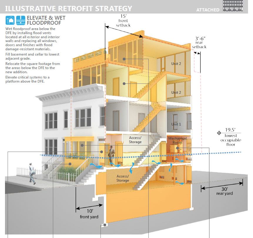

One option New York City authorities contemplate for attached housing is an “elevate and wet floodproof” strategy, indicated by the drawing at top. The idea is to relocate living activities to new stories added to the upper part of the building, while adapting the stories below the flood elevation with water-tolerant materials and assemblies.

Take, for example, the document’s section for “Attached” housing, typified by the classic New York City brownstone row house. The report shows a cutaway drawing of a building whose lowest occupied floor is four feet below street level. The flood elevation for the area is a dotted line two feet above the second floor — leaving the entire first floor, and the cellar below that, under water in case of a flood. The document suggests several options, including “elevate” (which in this case does not mean lifting the building, but simply adding two stories on top of the existing roof), “wet floodproof” (which involves essentially moving out of the lower two stories and putting an addition on the back to replace the lost square footage), and, audaciously, “dry floodproof” (an option which would somehow make the second floor, below grade first floor, and fully subterranean basement completely water-tight in the event of a 12-foot-deep ocean storm surge). With regard to the “dry floodproofing” strategy, the document offers this dry advice: “Add reinforcement to roof, party-walls, exterior walls, and foundation walls and slab. Ensure changes to party-walls do not impact neighboring property’s structural integrity.”
