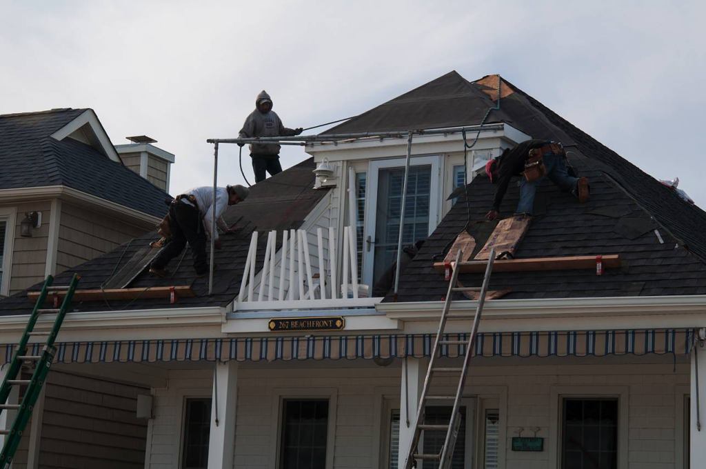

A Brielle New Jersey home receives a new roof post Hurricane Sandy. While flood damage predominated in shore communities, some wind damage did occur. But careful case-by-case inspection may be required to determine how much damage can be attributed to which factor.
