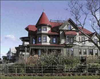

The Corbin-Norton House is the grandest of a cluster of Victorian-era summer homes encircling scenic Ocean Park in the heart of Oak Bluffs, one of the six towns on the island of Martha's Vineyard. When software entrepreneur Peter Norton bought the home in 1991, neglect and a series of remodeling nightmares had erased much of its original look, but he was determined to restore the house to its former grandeur. Architect Christopher Dallmus of Design Associates in Boston worked with local contractor Neal Galligan, president of Doyle Construction in West Tisbury, Mass., to return the house to its glory days. The completed project was an exact replica of the house as it stood in 1891. "The Corbin-Norton House stands out among all restorative renovations I've worked on because the result was largely museum quality," says Dallmus.
Then disaster struck. In February 2001 a short circuit in an electrical wire set off a blaze that reduced the unoccupied home to cinders. The home's smoke detectors malfunctioned, letting the fire quietly smolder in one room for approximately four hours, until it got hot enough to melt the windows. When that happened, the rush of oxygen caused the room to burst into flames, which then spread quickly throughout the house. Firefighters made a heroic effort to keep the fire from spreading to adjacent homes, but that was the best they could hope for. The blaze was unstoppable.
Without hesitation, Peter Norton decided to rebuild. Galligan's crew completed the second Corbin-Norton House in the fall of 2004. The new incarnation is identical to the original except for one big difference: It now includes the ultimate in burglar and fire protection, including a commercial-grade sprinkler system.

Shortly after the renovation of the Corbin-Norton House on Martha's Vineyard, a fire sparked by an electrical short circuit reduced the unoccupied home to cinders. Faced with the ruin of the once-grand Victorian, its owner decided to restore it immediately — adding a state-of-the-art fire and security system in the rebuild.
