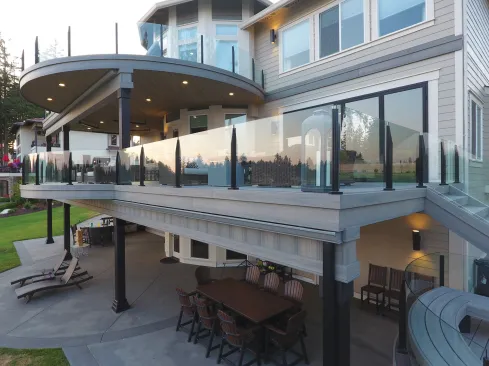

In pre-COVID times, one of my largest and most challenging projects was a 2,500-square-foot deck and matching dock system, part of an extensive outdoor living project for a home on Lake Tapps, in Washington. For the deck’s multiple levels across the home’s lakeside elevation, one of the organizing design elements is a pair of stacked, semi-circular balcony-style projections extending from the home’s central turret.

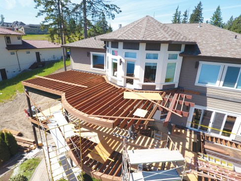

The framing for the second-story curved balcony was straightforward, with 2x12 pressure-treated (PT) hemlock joists cantilevered over the deck’s 6-inch-by-24-inch dropped PT glulam beam. Forming the curve was a simple matter of swinging an arc across the cantilevered joists and cutting them to length. On the third story, however, the curve circles all the way back to the house. Figuring out how to frame this section—an unsupported 4-foot-deep curved cantilever—without installing another support post or interfering with the planned underdeck drainage system was a head-scratcher.

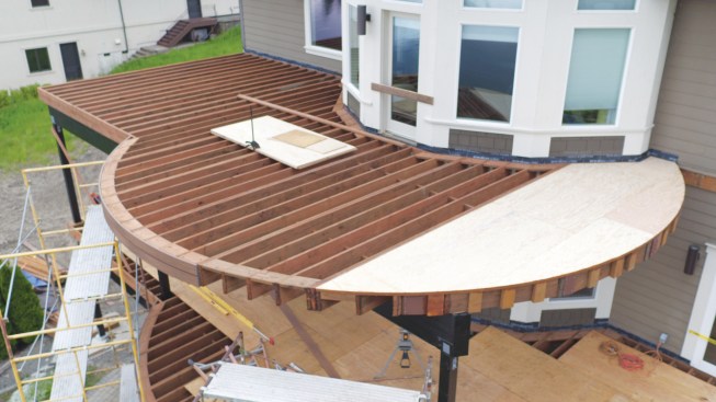

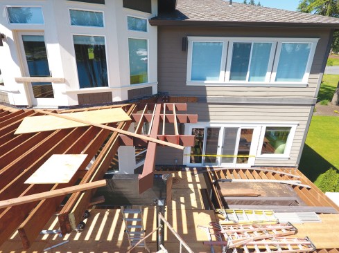

The custom-fabricated engineered steel girder shown here was needed in order to complete the curved detail on the top level of this multi-level deck.
The solution that our engineer devised for this framing problem is my favorite feature on the deck, but one that is hidden from view: a 1,200-pound steel girder hidden inside the third-story deck framing. Fabricated primarily from 2-inch-by-10-inch and 6-inch-by-10-inch rectangular steel tube, the assembly is bolted to the deck framing, the dropped glulam beam, and an existing glulam rim joist inside the house framing.

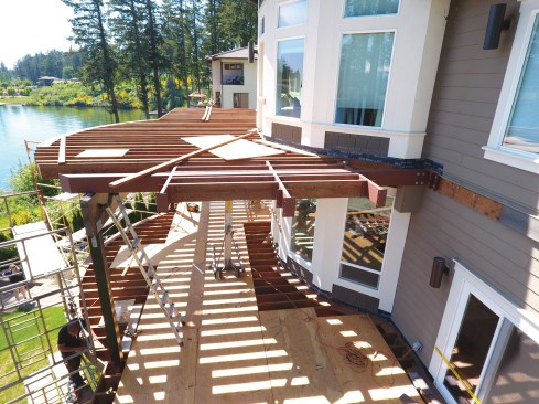

With no crane available to lift the massive girder into place and only a two-man crew, installation required a bit of Egyptian-style ingenuity. I began by flipping the forks on my skid steer upside down and used those to carefully hoist the girder up onto the lower deck. From there, my helper and I leveraged the girder into position, then set up two Genie manual 650-pound-capacity lifts (one that I own and one that I rented for this project) and began cranking away.
The 1,200-pound girder was bolted to the house framing, the dropped glulam beam, and to a triple 2-by deck joist.

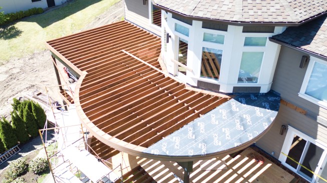

With the girder assembly installed, the author used composite deck boards to create the smoothly-curved rim joists.
After the girder was lifted into position and bolted to the deck and house framing, we installed two layers of 3/4‑inch treated marine plywood over the steel to match the 11 1/2-inch height of the wood deck framing and provide a fastening base for the decking’s hidden fasteners. On top of the plywood, we laid down sheets of Grace Ultra self-adhering roofing membrane.
The installed girder assembly was covered with two layers of 3/4-inch marine plywood to provide a nail base for the decking fasteners.
Then to waterproof the assembly, the author covered the plywood with a layer of self-adhering butyl roofing underlayment.
Instead of trying to kerf PT lumber to create curved rim joists, I like to use composite deck boards, which conform to a curve more smoothly. On this project, I installed an upper and lower rim board, with a 1/2-inch gap between them so that they were flush with the tops and bottoms of the 11 1/2-inch-wide joists. Then I covered the rims with a two-piece fascia detail.

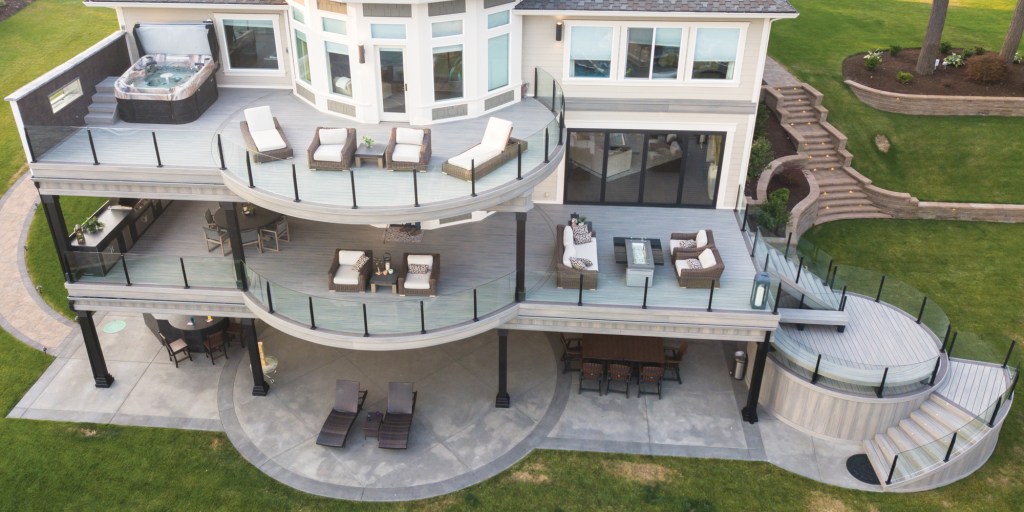

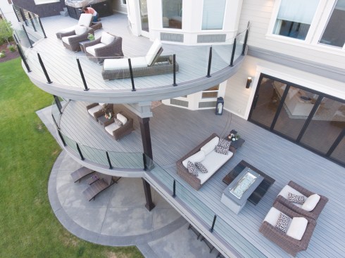

With the steel girder hidden in the framing, a minimum number of support posts, and an elegant glass railing, the homeowners enjoy unobstructed views out over nearby Lake Tapps.
The entire structure rests on four engineered 4-foot-square footings and PT glulam posts specced by our engineer (standard 6x6 posts weren’t quite strong enough). Most of the sawn framing is evenly spaced on 14-inch centers, but under the hot tub on the upper level, the joists are spaced 6 inches on-center. It took two of us about seven months to complete the project. ❖
