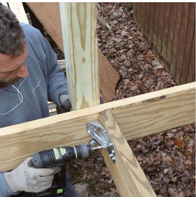

For years, the IRC has required that deck top railings be strong enough to resist 200-lb. concentrated loads applied at any point and in any direction along the top of the top rail. The purpose of the 200-lb. load requirement, of course, is to prevent someone from falling from an elevated deck for any number of reasons, including simply tripping on the deck surface. Unfortunately, despite efforts to introduce prescriptive guard post connection details into the code that would meet the 200-lb. outward load requirement (see Looking Ahead to the 2018 IRC, by Chuck Bajnai, PDB September 2016), the 2015 (or 2018) IRC doesn’t offer guidance for builders or inspectors on how to connect the guard post to the deck structure, meeting the IRC requirement.

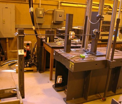

Here is the simulated deck joist/band/guard post configuration tested by the team at Virginia Tech. A chain was attached 37.5-inches (36” code required+1.5”) above the joists, over to a pulley, and up to a load cell. The test was conducted by raising the test machine load head which produced a horizontal force on the guard post.
Our team at Virginia Tech University tested stress-rated 4×4 guard post connections from 2004 through 2008. Our lab test specimens were “perfectly fabricated” using new No.2 Southern Pine lumber for the framing, and 4×4 guard posts. Over the 5-year period of our research, the tests were witnessed by hundreds of continuing education course participants, about a quarter of them code officials, inspectors, or plan reviewers. What we found is that common guard post connections typically would fail at loads between 20 percent and 75 percent of the target test load of 500 lbs.

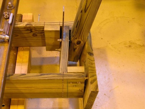

This post detail - which relies on blocking, ½-inch bolts, and screws - failed the load test. In fact, the only post details that passed the authors' testing were ones made with load-rated metal connectors. Without the connector approach, the deck band “peels off” at load levels between 20-75 percent of the test requirement.
This post detail – which relies on blocking, ½-inch bolts, and screws – failed the load test. In fact, the only post details that passed the authors' testing were ones made with load-rated metal connectors. Without the connector approach, the deck band “peels off” at load levels between 20-75 percent of the test requirement.

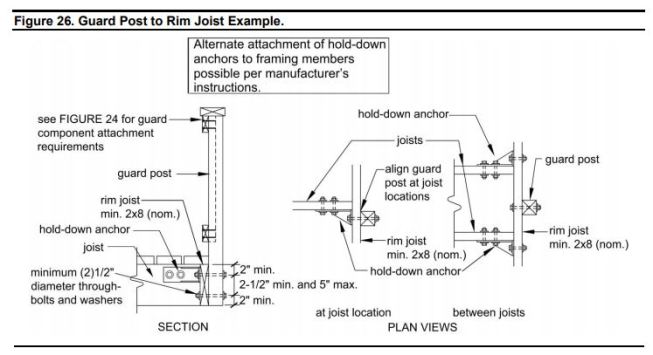

After a long series of unsuccessful test configurations, we finally figured out a way to build a guard post connection that could resist the 500-lb. test load at the top of the post. The solution was to use load-rated connector rather than a “fasteners only” approach. The “connector solution” for attaching a guard post to decks has been widely published in contractor magazines and engineering journals. In fact, the American Wood Council’s popular DCA-6 includes a detail for connecting a 4×4 post to a deck, which is based on our published research on guard post connection testing. This is a resource that often is used by deck builders, building code jurisdictions, and by homeowners, many of whom rely on its deck post connection recommendation. To our knowledge, at least three manufacturers now market metal hardware specifically designed to be used for connecting guard posts to decks. However, despite these efforts, none of these solutions are in the IRC code.
The AWC's DCA-6 guard post connection detail, which is strong enough to meet code requirements.
