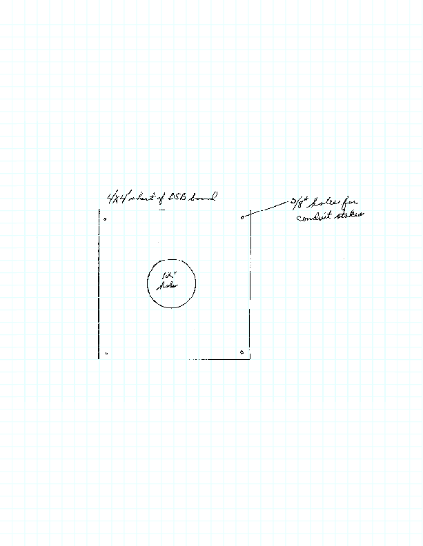

A year or so into the business, I came up with a solution. I purchased a 4-foot by 4-foot sheet of 5/8-inch OSB, and in its center, cut a round hole with a diameter 2 inches larger than the auger I was using. Two inches from each corner, I drilled a 5/8-inch hole. Then I coated the OSB with a water repellent to protect it from the elements.
Now when I dig a hole, I center the OSB over the hole location and secure it at each corner with stakes made from 1/2-inch pieces of EMT conduit 24 inches long. This prevents the OSB from drifting off-center during the digging. As the dirt is augered out, wet or dry, it gathers on top of the OSB, and is easy to shovel up and into a wheelbarrow. Additionally, the OSB provides a flat and stable base to work from, and when it’s removed, the area around the hole is clean and free of any muddy build-up. What an improvement!
