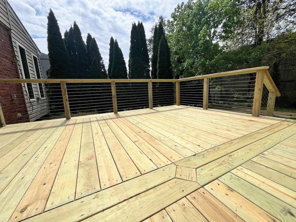

Now, though, I have a new option to offer to customers: RailFx’s Express Mount Bracket System, the cable railing used on the project shown in this article. It’s designed for wood decks and is a bridge between the nosebleed prices for standard cable railing systems and more modest wood-deck budgets. At about $3,500 (my cost, no markup) for a 16×20 deck with three-tread stairs, it’s around double the cost of the powder-coated aluminum balusters I often use but still one-third the cost of a full-fledged cable rail system—and I don’t have to drill a million dead-on-accurate holes in 4x4s. The secret to the sauce is the system’s surface-mounted brackets.

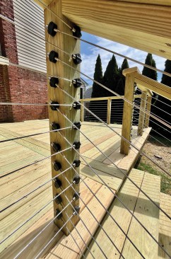

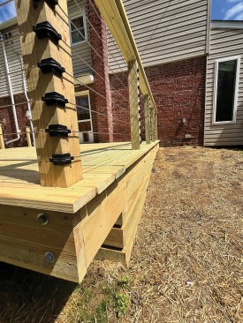

With most cable railing systems, posts are drilled to accept cable, whether they are wood posts drilled on site or metal posts drilled in the factory. On one end, the cable is slotted into a toothed fitting; on the other end, the cable is mounted with a turnbuckle-type of hardware. RailFx also makes that kind of hardware, but the Express Mount brackets install to the exterior face of the guard posts for the cable to run through instead of drilled holes. Easy on the eyes from the yard and invisible from the deck, they’re a low-risk, high-reward install.

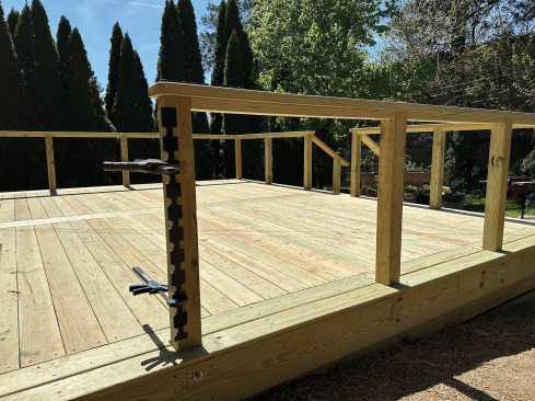

Layout. Express Mount brackets require 4-foot post spacing; for greater spans, the system requires a cable brace centered between posts. Because the configuration will affect budget and process, that’s a decision that needs to be made in your permit application and materials order. On this deck, 4-foot post spacing worked fine with a single corner post in each corner.

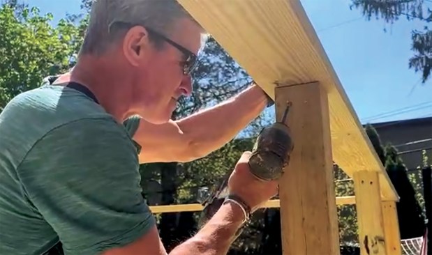

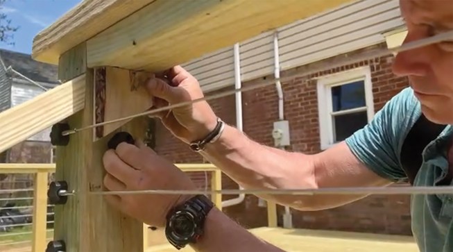

Takeoff. The lumber order differs a little when Express Mount is used, too. Because the tensioning force of the cable fittings is massive, a 2×4 needs to be placed between the posts, under the typical 2×6 cap. No bottom rail is needed. (I also like this look and, to add shadow lines, I may install the 2x4s on other deck rails that don’t require them.) In this case, I installed the 2×6 cap first, toe-screwing up through the post. I then used it as a stop to install the 2×4 underneath it (see slideshow, below).
Installation
Bracket installation is guided by a drilling template. I prepped the template for a 36-inch guardrail by cutting 8 inches off the end using a miter saw. Plastic doesn’t act like wood and tends to jump when being cut, so make sure that it’s secure and held tight to the saw fence. Be mindful that the template now has a top and bottom, and you’ll need to register the top to the underside of the 2×4 post spacer every time.

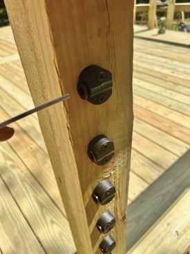

End-post brackets. Mark the center of the post, 1 3/4 inches. Then, opposite the cable run direction, mark a 1/2‑inch offset from the centerline (2 1/4 inches total). Clamp the supplied drilling template here. The instructions show C-clamps, but I have bar clamps. It didn’t take long to figure out the bar end of the clamp should face the deck, not my face.
Code language says that railing infill may not allow a 4-inch sphere to pass through it. That applies to cable railing but, because properly installed cable can deflect, the RailFx drilling template provides tighter spacing at 3 1/8-inch centers.

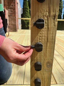

Intermediate and corner post brackets. For intermediate posts, you’d think that you would align the drilling template flush to the edge of the post. In reality, however—and I don’t know why—when the template is correctly placed so the brackets are centered on the post, the template’s outside edge runs 1/4 inch past the edge of the post.
The corner brackets require a particular fastening sequence. Place a bracket using the template as a guide, then snug up a screw but don’t set it until after you have set the screw on the other side. The brackets are durable, but make sure not to overdrive the screws.
I also noticed a difference between using a cordless drill and a cordless impact driver. The drill set softly but with enough force to crush some wood fiber on the 4-by posts. Everything threaded through, but another 1/16 inch or so and I would have been backing out a lot of screws. The impact driver was easier to goose in just right.
Inside corner posts. The installation instructions have a provision for inside corners for deck rails that have them. Each side of an inside corner post is treated as an end post, and the drilling template needs to be offset down 1/8 inch on one side so the cables can pass by each other.

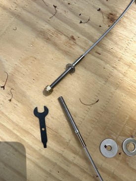

If there was ever a project that called for setting up a large worktable, this is it. Once the cable, cable parts, and hardware come out of the boxes and bags, there are suddenly a hundred pieces, parts, nuts and washers, and other spare parts. My guess is that the same hardware bags are packed in with all the RailFx models, so there are mystery washers and parts not needed for Express Mount installation. All these pieces need to be organized in the same place. Two sawhorses, three 2×4 struts, and a sheet of 5/8-inch plywood do the trick for me. Call it a really big stand-up desk.

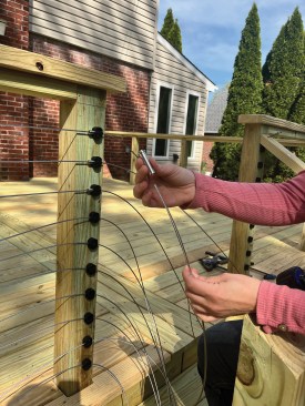

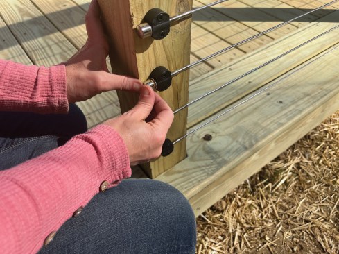

To set a cable, the threaded stud spacer first needs to be inserted into the post bracket (see slideshow, below). Next, at the table, we install a washer and nut on the threaded end of the cable. This assembly is then fed through the stud spacer in each intermediate bracket.
At outside corners, pull the cable all the way through one side of the corner fitting, then horseshoe it into the other side of the fitting. The cable will have twisted as it has been passed through the various fittings. While the last gesture of snaking it through the corner post is kind of a snap fit, make sure the cable has very little play and is untwisted before doing so, or you risk putting a kink in the cable. We didn’t kink any cables, but I can see a newbie yanking the stuff—like cranking all the stretch out of a nylon line with a trucker’s hitch—and things going sideways fast. You can’t just run out to the lumberyard and get another piece of cable, so it pays to be mindful of what you’re doing.

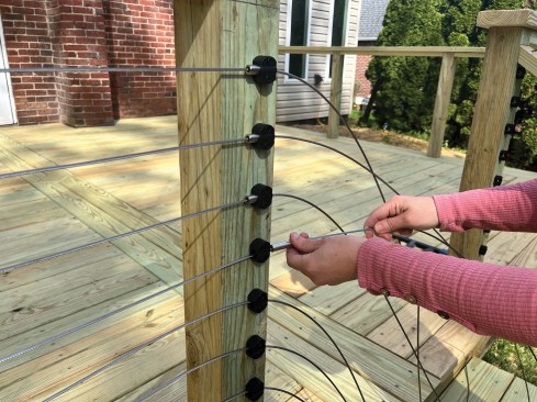

At the end of the run, you’ll have excess cable. Sleeve the pull-lock fitting on to it. This is unidirectional, so make sure the flared end is toward the end of the cable. The fitting is similar to a zip tie: Once it’s in, it’s in. And while that’s a little all-or-nothing, if something does go wrong—for example, we had a strand of cable unspool a little that we needed to get past—the kit includes a tool that disengages the teeth such that the fitting can slide freely along the cable. Then it’s a matter of hand-snugging the cable and fitting.

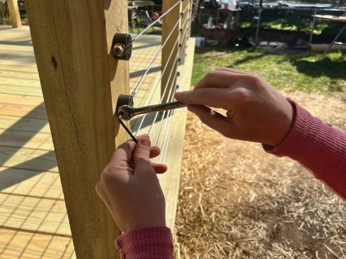

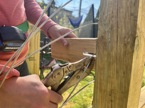

Pre-tension cable. RailFx sells a product for pre-tensioning cable, but one didn’t come with my order. Making a tool out of a piece of strapping (or furring strips, something I usually have on hand for making jigs, braces, and other assemblies) was easy. Give the cable ends a quick crank to snug them up (see slideshow, below).
Tension the cable. RailFx calls for 225 pounds of tension and, while there are tension testers out there, I’m happy with about 1/4-inch deflection—tight but not too tight. RailFx also calls out a tensioning sequence, starting with the center cable, then moving up one, then down one until all cables are snugged up. We found that we still had to tune individual cables to make all the cables the same tension. If you’re installing the cable in cold weather, it might be worth putting a line item in the scope of work to return when temperatures warm up to readjust the cables, which, technically, will elongate when it gets hot. It might also be worth mentioning to customers that this condition is possible, and that there’s nothing wrong with the system. It might not happen, but if it does, you’re covered.

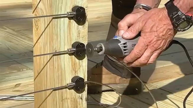

Cut the cable. My kit shipped with what appears to be an abrasive grinder wheel and mandrel-like thing for use with a cordless drill. I couldn’t get it to work. I’m sure it’s my fault—one of those glitches between the instructions and real life, but no matter; I already had a Dremel rotary tool with an abrasive wheel out anyway, and it works great for zapping the cable ends. I don’t wear safety glasses all day, but for a task like this, I always wear them. That thing is spinning a billion rpm, and it doesn’t have a guard to catch a fleck of abrasive moving at light speed toward your face.
