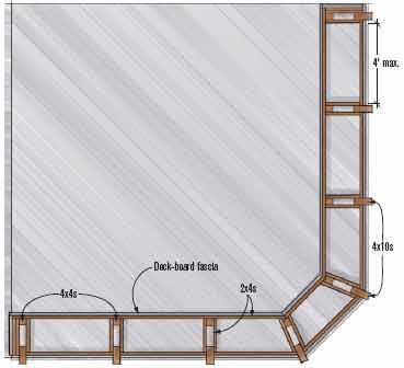

The first step is to make a pattern on a piece of 1/2-inch plywood. You can either use the dimensions in the drawing (Figure 1) or trace a comfortable chair. If you plan to build benches regularly, paint the plywood and seal its edges to make it last longer.
Figure 1. The secret to a comfortable bench is getting the height and the angles right. The author's design is based on that of a comfortable chair, the shape of which he traced onto a plywood template.

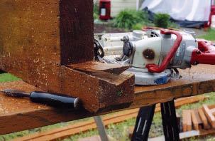

After cutting the posts for the straight run, I turn to the corners. The deck shown here has a 45-degree corner, and the corner posts are notched to fit the angled rim joist (Figure 4). (If it were a 90-degree corner, the main difference would be in the angle of the notches.) The notches are made with blind cuts — that is, they stop before reaching the end of the workpiece — so one circular saw can’t make both cuts. You’d have to start one side with a plunge cut or back the saw into the second cut — both dangerous maneuvers.
Figure 4. Two circular saws — one right-tilting and one left-tilting — are used to notch the back posts to fit the angled rim joist. A chisel cleans out the waste.

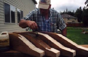

A better way is to use two circular saws: one that tilts left and one that tilts right. Set the saws at 22 1/2 degrees and cut the notches. Remove the waste with a sharp chisel. Cutting 4x10s can expose un­treated wood (Figure 5) — preservatives rarely reach the center of large timbers — so you’ll need to treat the cuts with an end-cut preservative such as Jasco Copper Brown Wood Preservative (The Homax Group; 800/?729-9029, www.homaxproducts.com).
Figure 5. Cutting timbers usually exposes an untreated core. For longevity, coating all cuts in pressure-treated wood with an end-cut preservative is crucial.
Frame the Seat With 2x4s
To support the seat boards, I attach two 2x4s to each back post (Figure 6). For all the seat supports except those for the end and corner posts (which I’ll get to shortly), I cut the 2x4s 17 1/2 inches long with a parallel 5-degree angle on each end. Then I mark the posts just below the first angled cut — which, when the posts are installed, will be 141 3/16 inches from the deck surface — with lines slanting 5 degrees down to represent the top of the 2x4s. The 2x4s will extend 3 inches onto the back posts, leaving plenty of room for the long 2x4s that will eventually be fastened to the back of the seat supports, between the posts.
Figure 6. Seat posts shaped from 4x10s are placed no more than 4 feet apart to support the 2x4 framing of this bench.
Figure 6. Seat posts shaped from 4x10s are placed no more than 4 feet apart to support the 2×4 framing of this bench.
I preinstall the seat supports on the posts. To start with, I attach the 2x4s with construction adhesive and one nail (Figure 7). Before locking them in place with a second nail, I set the 2x4s at 5 degrees to the bottom of the post, verifying the angle either with a layout square or with a framing square set at a 1-in-12 pitch, which equals 5 degrees. When I’m certain of the angle, I drive a second nail to lock it in place. It’s important to accurately place the 2×4 seat supports, as they must all line up when the assembly is installed on the deck.

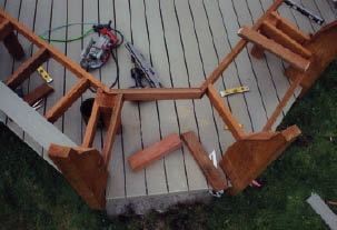

To install the back posts, I notch the decking as needed and fasten the lower part of the post to the deck’s rim joists using two 51/2-inch FastenMaster LedgerLoks. Once all the posts — except the corners — are in place, install the 2x4s that run the length of the front of the seat, allowing them to run long at any inside corners (so you can measure from them to size the seat supports).
Next I fasten the corner posts to the rim joists with 5 1/2-inch LedgerLoks, as I did with the other posts. Then to determine the angles and lengths of seat supports for the corner, I measure from the corner posts to the 2x4s that I let run long for this purpose (Figure 8). I cut 2x4s to my measurements and fasten them onto each side of the corner posts.
Figure 8. Allowing the 2x4s that join the front of the bench to run long made figuring the angles and lengths of the corner seat support 2x4s a matter of measurement, not complicated math.
