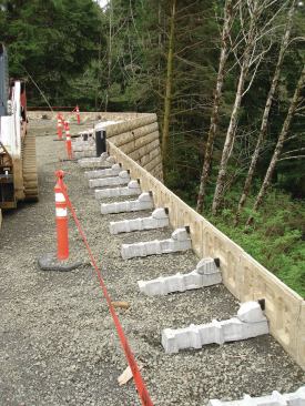

In Lock+Load’s retaining wall system, face pieces are attached…
In Lock+Load’s retaining wall system, face pieces are attached to separate anchoring components called counterforts.
Lock+Load
The counterforts work like geogrid fabric, anchoring each pane…
The counterforts work like geogrid fabric, anchoring each panel to the soil mass behind the wall.

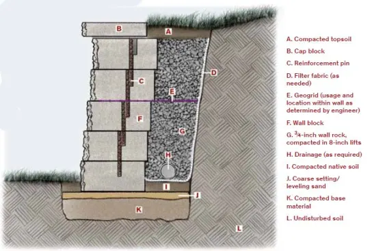

Versa-Lok
Segmental retaining walls don’t require a concrete footing but…
Segmental retaining walls don’t require a concrete footing but do require a solid base of compacted crushed rock.
Versa-Lok
Some manufacturers recommend adding a layer of coarse sand to ma…
Some manufacturers recommend adding a layer of coarse sand to make leveling the first course of block easier.
Versa-Lok
Synthetic geogrid is used when retaining walls are built on soil…
Synthetic geogrid is used when retaining walls are built on soils containing a lot of silt or clay, or when wall heights exceed 4 feet.
Versa-Lok
The geogrid reinforces the soil mass behind the wall and helps a…
The geogrid reinforces the soil mass behind the wall and helps anchor the block courses in place.

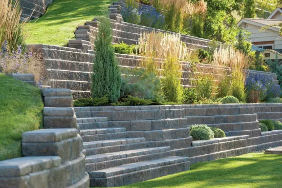

Allan Block
The first segmental retaining wall you build likely won’t look…

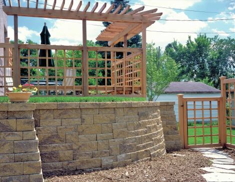

The first segmental retaining wall you build likely won’t look like this, but the photo illustrates the design possibilities offered by these versatile systems, including curved walls and planting areas.
Stuart Bish

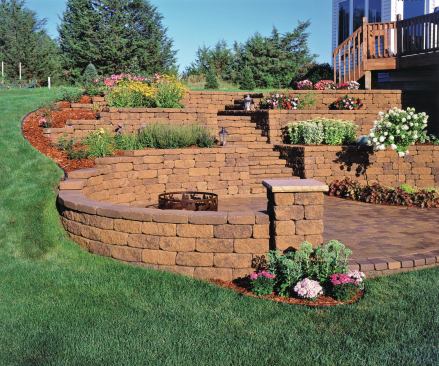

Segmental retaining walls can be used to create planting areas o…
Segmental retaining walls can be used to create planting areas on a steep slope.

Instead of spiking together landscape timbers for your next retaining wall, maybe it’s time to expand your hardscaping repertoire by offering modular concrete-block walls to your clients. Walls made from interlocking concrete blocks — called segmental retaining walls, or SRWs, in the industry — have the appearance and durability of stone, but they don’t require a big investment in tools, equipment, or training to install.
First introduced in the 1980s, precast-concrete-block walls are relatively simple to build (although not always simple to engineer) and lend themselves easily to curved shapes. Unlike poured-concrete walls, block walls don’t require a below-grade concrete footing, and they can be placed in hard-to-reach spots where a cast-in-place wall would be much tougher to form and pour.
Versatile Design
Highway engineers planning 75-foot-high retaining walls love giant SRW components — panel systems and gravity wall blocks that weigh as much as a car and require heavy equipment to place. But 90% of the retaining walls built in the U.S. are 4 feet high or less, and there are plenty of smaller-scale SRW systems useful to deck builders who want to move into hardscaping. These low walls often require little engineering, and many blocks are small and light enough for one person to move and set manually.
Residentially scaled SRWs rely on mass and the friction between blocks to resist tipping forces from the soil they’re containing. But details between brands vary. Some systems, such as Versa-Lok and Keystone, align the blocks with glass-reinforced nylon pins that slip through holes in one course to engage slots in the next course. Other blocks, such as those made by Anchor, have integral lips that align one course with the next. The pins or interlocking profiles that join the blocks together keep courses straight while automatically establishing a cant (the angle of the wall off perpendicular), which helps the wall resist the push of soil behind it.
Not all SRWs are made with blocks. Lock+Load’s two-part system consists of precast facing panels that attach to counterforts during wall assembly. The counterforts anchor and reinforce the large (16-inch by 32-inch) but relatively lightweight (110-pound) panels.

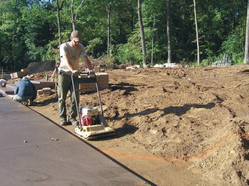

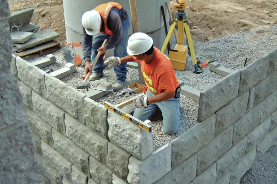

A segmental retaining wall is typically built on a base of compacted 3/4-inch washed angular rock, or “wall rock.” Even in areas where frost gets deep into the ground, the mortarless construction of the wall gives it enough flexibility to cope with minor frost heaves.

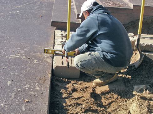

While details will vary from manufacturer to manufacturer, the general idea is to excavate a level trench 4 to 6 inches deep, compact the soil with a plate compactor, and then add wall rock. After being compacted again, the base is ready for construction of the retaining wall.

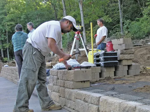

The first block course is set in place, and backfilled with a 12-inch layer of wall rock followed by on-site soil (or fill approved by an engineer), then compacted. The base course should be checked carefully for level in both directions.
Each remaining course is handled the same way: Set the block, check for level, backfill, and compact. At the top, cap pieces, usually glued in place with concrete adhesive, finish off the wall.

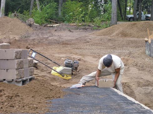

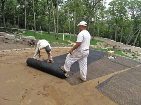

When an engineering plan recommends installing a reinforcing geogrid for more strength, the material is added at specified levels — between the first and second course, and then every other course, for example. Typically, geogrid is placed between block courses, set back from the face of the block (it’s very difficult to trim later), and rolled back into the excavated area. Then the installer adds fill and compacts it over the grid to lock it in place.
There are different kinds of geogrid; when an engineer calls for it, the plan may specify the brand and the tensile strength. The kind of soil on the site and the height of the wall will help the engineer determine the specifics of geogrid placement.
Using geogrid increases the cost and complexity of the job. Besides the cost of the material itself, a larger area needs to be excavated to allow room for the grid to be buried, so there’s more fill and more compaction involved. Josh Peterson, a field superintendent for Villa Landscapes in Oakdale, Minn., estimates that incorporating geogrid can double or triple the cost of a wall. He uses it only where it’s really necessary, which he says is on 10% of the retaining walls he builds.
At the other end of the spectrum is Mark Tompkins, the owner of Total Grounds in Monmouth County, N.J., who uses geogrid on 90% of the walls he builds, because engineers in his area typically call for it. It’s a cheap insurance policy against wall failure, Tompkins says. “If you have a wall failure, it doesn’t matter who manufactured the block,” Tompkins says. “It doesn’t matter who the installer is. It puts a big dent in the whole industry in that area. It puts a red light up. The engineers are more cautious, and they review the plans more.”

Managing on-site water so it can’t get trapped behind the wall is an essential part of retaining-wall design. Hydrostatic pressure from trapped water can easily push a wall off its base or cause it to topple over. Fortunately, one of the main advantages of an SRW is that the blocks aren’t mortared together, which allows the face of the wall to remain porous.
“Water is the biggest enemy of any wall,” says Versa-Lok’s Singer. Even in the perfect scenario for a 4-foot-high wall (no slopes, good soil, and no surcharges), 12 inches of wall rock should be placed behind the face of each course of block to allow for drainage.
Because PVC drain pipe is relatively inexpensive, many builders routinely incorporate a drain line into the base of their walls. The line is then run to daylight or to an underground water-retention basin. In either case, the goal is to allow water migrating through the soil behind the wall to eventually reach the compacted wall rock and then exit through the front of the wall or down the drain line.
Singer explains that if the face of a block retaining wall isn’t wet after a big rainstorm, the wall isn’t draining properly. “If you have five days of rain and the face of your retaining wall never gets wet, then I would be concerned,” he says. “Unless there’s a great drainage system taking the water immediately away from the back of the wall, this would indicate that there’s something behind the wall that’s holding the water back.”
