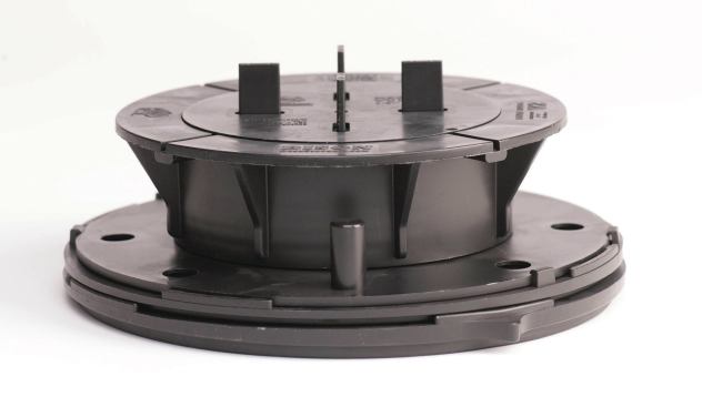

Bison makes both fixed and adjustable-height pedestals, along with adapters and installation accessories for different types of deck surfaces. The Versadjust pedestals we used here are made of high-density polypropylene and have a weight capacity of up to 1,250 pounds. Their design features an adjustable screw thread that allows them to be set to a predetermined height; they come in four different sizes, ranging from the V-1 (with a height range from 2 1/4 inches to 2 3/4 inches) to the V-4 (with a height range from 5 3/4 inches to 9 3/4 inches). Extensions are available to increase the height of a pedestal assembly to up to 24 inches, though bracing, available from the manufacturer, must be added to the assembly.
Versadjust pedestals also have an adjustable slope. Rotating the bottom can adjust the slope up to 5 degrees, which is useful on some of the roofs that we work on. At the top of the pedestal, a four-way tab automatically spaces the grids or tiles while preventing them from moving around. Screw-in anchors are available that can be used to lock certain wood tiles in place after installation (the anchors aren’t required for heavier stone or concrete pavers). If maintenance is necessary, the anchors can be unscrewed, allowing individual tiles to be removed from the pedestals for access to the roof deck underneath.

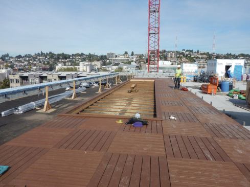

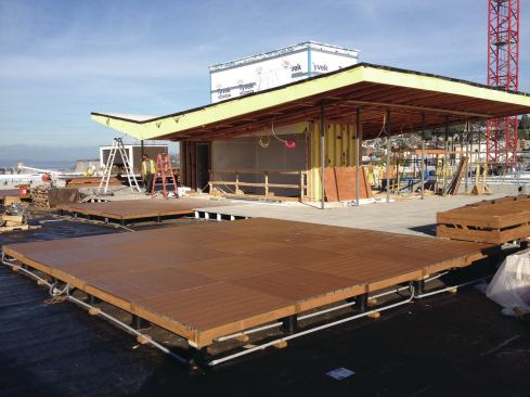

When we’re working on top of a commercial roof, we need to carefully control and monitor weight distribution so that we don’t damage the roof during construction. On this job, we preassembled 4-by-4-foot grids, which we framed with pressure-treated 2x4s and finished with Trex Transcend decking (in the “treehouse” color) installed with hidden fasteners. Each of the assembled grids weighed about 100 pounds, making them fairly easy to handle.

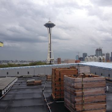

We needed to build about 150 grids to cover the more than 2,400 square feet of deck that the project called for, so we saved a lot of time by constructing the grids production-style in our shop. After trucking the prefab grids to the jobsite, we stacked them 15 high on pallets, and strapped them together so that we could lift them onto the rooftop using a crane. Each pallet weighed about 1,500 pounds, so we were careful to evenly distribute them across the roof. From there, it was simply a matter of placing each grid on the adjustable supports, with each corner of the grid supported by a pedestal.

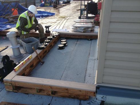

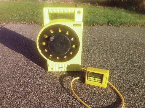

Layout. Working from a square layout that we snapped on the roofing, we marked the location of the supports using a can of white marker paint. Using our trusty ZipLevel (see “A Tougher Jobsite Level”), we checked the rough height at each support location to determine which size pedestal would be needed. Then we dialed in the rough height of each support by spinning it up or down. Later, as we set the grids, we fine-tuned the heights so that our deck surface was perfectly flat.

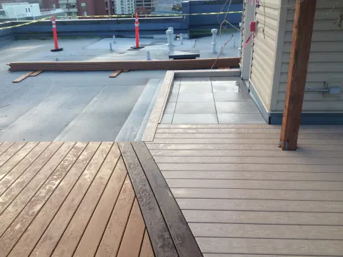

Installation. On most of our commercial jobs the roofing is completed before we arrive on site, with the base sheet and torch down ready for us to place the pedestals. The pedestals aren’t fastened to the roof structure, but are just held in place by the weight of the deck, so the roof system doesn’t require any additional waterproofing. Still, there are a few extra steps that we take.
When we cut any PT framing, we carefully seal all exposed ends with Copper-Green Brown Wood preservative, a 10% copper naphthenate solution. In addition, we take care not to leave joist hangers, screws, or any other metal products that could damage the roofing surface in contact with it. As we work, we carefully sweep or blow debris out from below the installed deck to keep the understructure clean. Finally, we protect the roofing by placing each pedestal on top of a 5-inch-diameter rubber mat.
Once our grids were installed on top of the pedestals and leveled, we screwed them all together with structural screws. Using long bits, we drove the screws through the gaps in the decking. Then we installed Trex 1×8 and 1×12 fascia around the perimeter to help lock the panels together. The weight of the deck is sufficient to resist typical wind uplift loads in this area.
