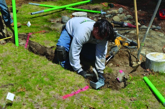

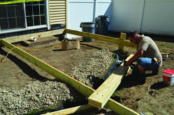

Trenching a beam requires more than just digging a long hole. The beam needs space underneath to prevent frost from pushing it up in winter. Over time, dirt would fill in that space, so we over-dug the trench, lined it with landscape cloth, and surrounded our below-grade beam with loose, clean stones. Those stones drain well and will move aside if frost threatens the beam. The landscape cloth prevents soil from infilling the spaces between the small stones.
Footings

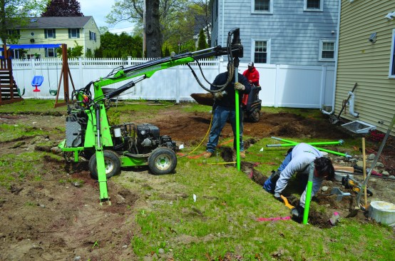

For the deck footings, we used helical piles instead of concrete poured into Sonotube forms to avoid damage to the existing stone patio. Digging for piers would have been dangerous so close to the patio, and properly compacting the soil around the 4-foot-deep piers would not have been feasible: The soil would settle over time and cause the patio to sink.
After digging a trench for the carrying beam, the crew used a hydraulic machine to drive helical piers into the soil until the required pier bearing strength was verified by the machine’s on-board torque gauge.
Adjustable-screw beam brackets were set onto the steel-tube piers.
A big advantage of the helical piles is that they can be screwed into the ground by a compact hydraulic machine without disturbing the surrounding soil, and the machine’s torque gauge tells us exactly when the required bearing capacity has been achieved. We twisted each 7-foot helical footing into the ground below the frostline, and cut the end off once it exceeded the required bearing capacity. We then attached adjustable brackets to support our beam.

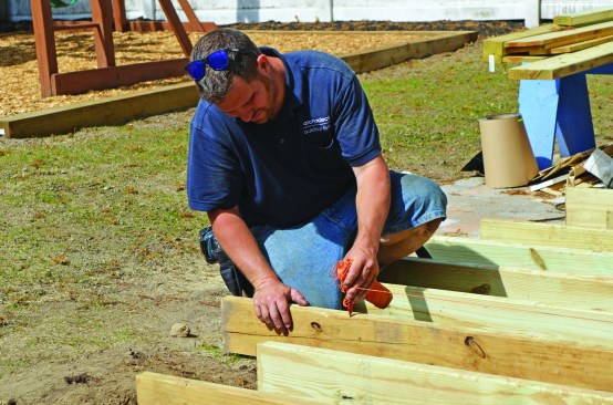

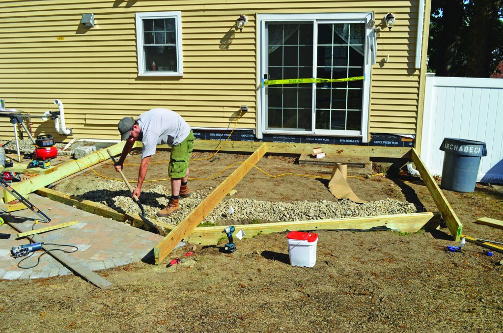

The crew squared the end joists to the house and established the desired pitch for the deck.
Framing
The initial deck framing was fairly conventional. After leveling our two reference joists, we inserted the beam below. The helical-pile footing bracket adjusts easily on its screw, so setting the beam height was simple. Once the beam was set, we flushed the top of each joist even with our carefully leveled house ledger, shot nails to temporarily fasten the joist, then installed joist hangers.
PT lumber rated for ground contact was used for the triple 2x8 carrying beam.
The beam had to be carefully cut into the stone patio rather than rested on it.

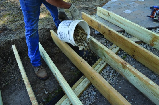

Crushed stone was placed around the beam to provide drainage.

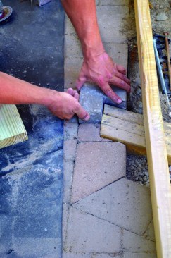

An interesting issue arose on the left side of the deck. Our design called for the deck to extend a few inches over the patio to hide its edge and provide a clean look. We could not let the side joist merely rest on the patio, because the patio is not a structure and is subject to frost. We had to support that side joist like all the other joists. Thus we had to extend our beam into the patio.
The solution was obvious, but somewhat tedious: We carefully notched the patio stones and reset them around the beam. It’s too bad the finished deck hides this craftsmanship.

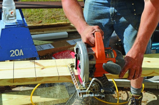

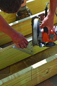

Since we had separated the beam structure from the edge of the deck, building a smooth, evenly curved rim became easy. We marked the curve on the joists using a string-and-pencil compass and cut the joists to length, finishing each cut near the ground with a recip saw.
After the joists were installed, a simple string-and-pencil compass was used to lay out the deck’s curved edge.

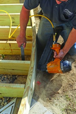

Workers then cut the joists to length with a circular saw, finishing the cuts with a recip saw where space was tight.

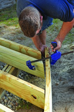

Carefully selecting and scoring the rim joist was crucial to creating an evenly curved deck. The rim joist could have no large knots, and a smooth curve demanded evenly spaced relief cuts. But the long radius (11 feet 6 inches) allowed our rim joist to easily bend into shape. Clamps on the ends and two screws in the middle held the curved rim in place. Leaving the joists loose over the beam allowed us to adjust any joist left or right until it tightly contacted the rim. We then aligned the height and nailed the rim to each joist.
The band joist was framed with a pressure-treated 2x8 that was kerfed to allow it to bend and follow the curve of the deck.
With the joists resting loosely on the carrying beam, the crew clamped the band joist into position.
Then, they nailed it to the joist ends before finally fastening the joists to the carrying beam.

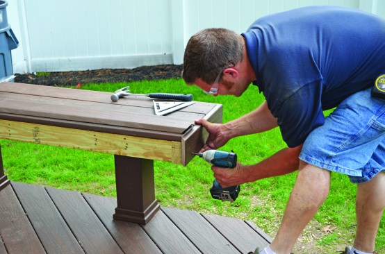

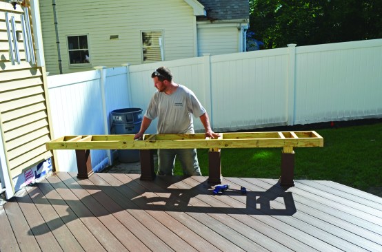

The Safety Bench

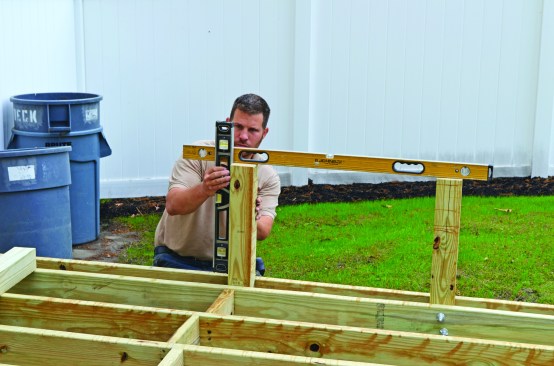

As planned, the step down from the deck to the patio was about 8 1⁄2 inches, but sloping ground on the right side increased that drop to almost 16 inches, making the deck on that side far too tall to comfortably or safely step down from. We addressed this hazard by building a bench along that edge of the deck.
Along the high side of the deck, 4x4 posts support a bench, which serves a safety function in addition to providing seating.

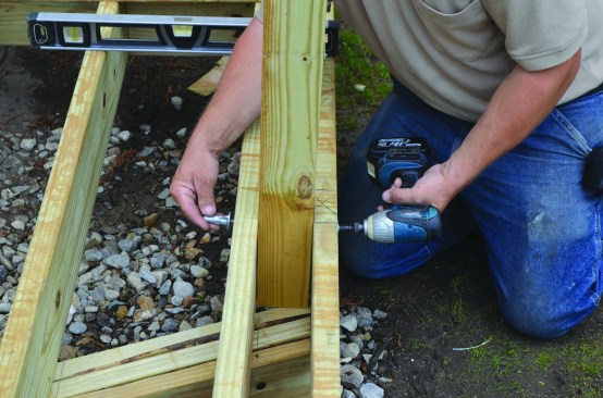

After the posts were plumbed and fastened to the deck frame with ThruLok screws.
A ladder-framed bench structure was fastened to the post ends.
The bench was finished using the same Fiberon material used for decking and deck trim.
A standard bench with pairs of legs might have looked too massive for this small deck. We opted instead for a “floating bench,” which employs single 4x4 legs that extend down into the deck frame. The key to making the bench solid and stable is to through-bolt each leg between two joists below and between pairs of cross supports on the upper frame. We clad the bench frame with Fiberon’s synthetic ProTect fascia, ripped to height, and softened the bench edges to improve sitting comfort by holding the trim 1⁄4 inch below the seat.
Treated wood shrinks considerably as it dries during the first months of its exposure, and the initially tight joints in our bench may become loose and wobbly in six or nine months. Fortunately, this shrinkage eventually stops and the wood remains moderately stable thereafter. So we’ll return within a year and tighten our connections.

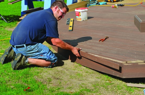

To hide the framing, we covered the rim and side joists with more Fiberon trim material. At 3⁄4 inch, it was thin enough to easily follow our curved rim joist.

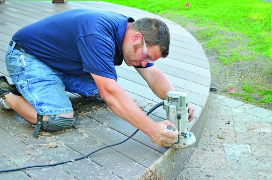

For decking, we used grooved Fiberon ProTect Advantage 5⁄4x6, fastened with hidden clips. We ran the deck boards diagonally and left them long, hanging past the trimmed rim. Cutting the decking straight along the side trim was easy using a circular saw.

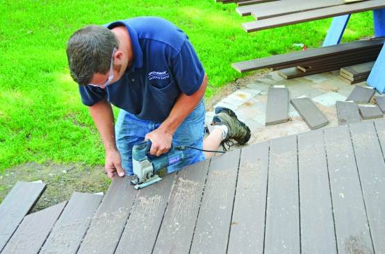

A worker laid out the curved portion of the decking, then carefully cut to the line with a jigsaw.
Next, he smoothed the edge with a router equipped with a flush-cut bearing bit.
The exposed end cuts were covered with a second trim piece.
Cutting the decking around the curve took two steps. We first used a jigsaw to roughly cut each board about 1⁄4 inch beyond the trim. We finished the curve with a router and a 1⁄2-inch-diameter flush trim bit. The bit’s bearing ran smoothly along the curved deck trim and guided the blades to create a flush, even edge.
To cover the exposed ends of the decking, we installed a second trim piece, flush with the top of the decking. We ripped a piece of the same fascia material to 2 1⁄2 inches and fastened it with stainless steel trim nails through the lower trim, and with clear silicone and stainless steel pin nails into the ends of the decking above.
The layout of the diagonal decking left one small sliver that demanded some care (and an extra face screw), but the results were worth that effort.
