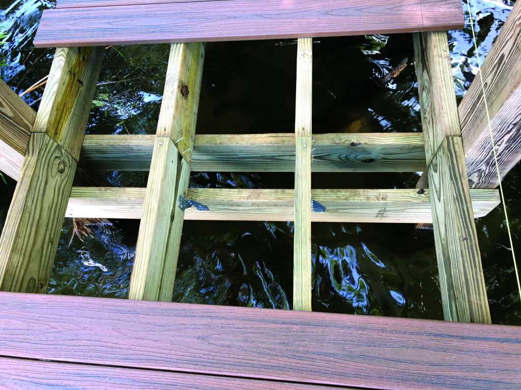

Hurricane clips tie the intermediate stringers to the 2x8 cross beams.

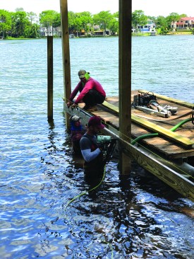

A water jet is used to set 6x6 PT pilings into the lake bottom.
A water jet is used to set 6×6 PT pilings into the lake bottom.

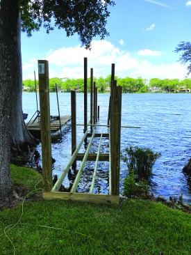

Then 2x8 stringers are nailed to pilings a minimum distance above the water level, per state and local codes.
Then 2×8 stringers are nailed to pilings a minimum distance above the water level, per state and local codes.

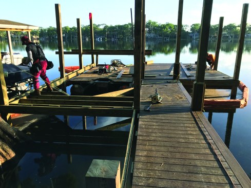

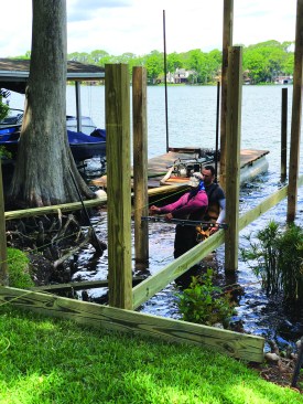

The crew sets a maximum of seven or eight pilings per side, then starts to frame the structure to stabilize them.

Because the majority of the soil in our area is soft, we usually are able to use our jet pump—which is just a trash pump operated in reverse—to set the pilings. We feed the outflow from the trash pump through a reduced-diameter pipe to blast a stream of water into the lake bottom at the point where a piling is to be located.
While one worker holds the piling upright and in position, a second worker uses the wand on the jet pump to open a hole underneath it. As the water jet scours out the hole, the weight of the piling sinks it down into the excavation. Once the piling has sunk a few feet, we remove the wand and check the piling for plumb and location along the string line.
It seems like pilings never end up exactly in the correct location, though. To correct this, we bring back the wand, situating it to provide directional jetting at an angle toward where we want to move the base of the piling. We also angle the piling as needed to provide the desired lateral shifting as it continues to drop in the lake bottom. It’s much easier than moving a hole in dry ground.

After setting several pilings in a row (working out from shore), we set up a second string line parallel to the first and, working back toward shore, set the mate for each of the pilings in the first row. Setting seven or eight pilings per side before stopping to frame up the structure allows for a convenient way to move materials out to the proper location, and it ensures that the pilings don’t shift due to settling or wave action. We try to keep all spans to less than 10 feet in all directions, though we can stretch that, if needed, to work around a tree root system or a submerged obstruction.
Hurricane clips tie the intermediate stringers to the 2×8 cross beams.

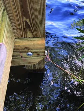

10-inch-long-by-5/8-inch-diameter HDG through-bolts fasten the cross beams to the pilings.

With the specified height marked, we snap a chalk line to mark the intended locations for the top of the stringers at each piling. Then we nail the outside 2×8 stringers in place.
Once we’ve secured the outside stringers to the pilings, we again check the pilings for plumb and adjust as necessary. Then we measure and cut the double 2×8 beams that will connect each pair of pilings and support the stringers. We through-bolt the beams to the pilings with 10-inch-long-by-5⁄8-inch-diameter HDG carriage bolts.
With the beams installed flush under the stringers, there’s now a framework ready for installing the intermediate stringers. We space them depending on the width of the dock and the span rating of the decking being used, and tie them to the cross beams with Simpson Strong-Tie H2.5A hurricane clips to prevent uplift due to wind or wave action. Once the framing is structurally secure, it’s time to begin laying the decking.

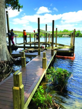

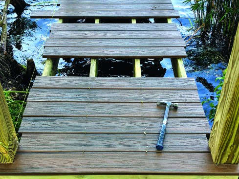

The crew dry-lays the decking to check the layout, spacing the deck boards with 16d nails to make sure water will drain off the dock quickly.
To provide support for a picture-frame border, the crew installs extra stringers between the pilings and adds blocking.
We start by rough-cutting the decking to size and dry-laying the deck boards, using 16d nails as spacers. Once the boards are spaced and in place, we snap lines to mark the locations of the outside stringers, screw the decking down, and then cut to the lines. Later, we snap lines (always with erasable blue chalk) for the intermediate stringers before installing the rest of the fasteners.
This dock happens to have a picture-frame border. To provide support, we installed extra stringers between the pilings and additional blocking as needed.
Unlike with deck construction, we station a person with a net to collect the offcuts when we cut decking in place. Otherwise, the scraps will float down along the shoreline or sink to the bottom.
Once the decking is complete, we install “pretty boards” around each of the pilings. These boards—basically 2x6s with a 45-degree bevel at the top—aren’t really that pretty, but they do add some visual definition to the pilings and are a great place to hide wiring for lighting as well as splices needed for any pilings that were too short.

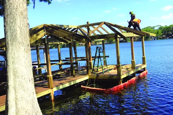

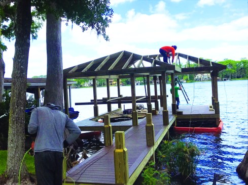

When plans include a boathouse or other roofed structure, the crew installs longer pilings to support the framing.

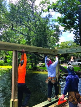

To create the box beams that support the roof, the crew fastens 2x10s to the inner and outer faces of the pilings, then fills the gap between the 2x10s with a 2x6 filler, making a convenient wiring chase.
To create the box beams that support the roof, the crew fastens 2x10s to the inner and outer faces of the pilings, then fills the gap between the 2x10s with a 2×6 filler, making a convenient wiring chase.
Our reference for squaring the boathouse platform is the line created by the final two walkway pilings. With the pilings set, we frame the platform structure in much the same way as the walkway, again working outward into the water and installing the necessary components prior to relocating our workboat, ensuring ease of access later.
Once we’ve installed the platform decking, we shift our focus to the roof structure. For our headers, we like the look of a “boxed” beam, so we sandwich our roof support pilings with pairs of 2x10s fastened to the inside and outside the piling faces. This leaves us with a gap between the headers the width of the 6×6 piling, which we fill with 2x6s that are flush with the bottom of the headers. Creating a box beam around the perimeter of the structure adds quite a bit of strength and rigidity to the roof system and gives us a convenient trough to set down tools during installation, as well as a place to conceal wiring after installation is complete.
When the crew is working over water, care must be taken to collect offcuts. The orange turbidity curtain is a requirement for containing construction debris.

We use typical roof construction practices for placing the ridge beams, corner ridges, rafters, and collar ties. The trimming of the rafters and the installation of the fascia can get a bit tricky at times without solid ground to work from; other­wise, the process is identical to conventionally framing a roof over a gazebo.

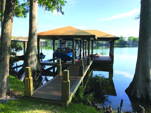

Finishing Up
Finally, we call in the subs to complete the roof installation (shingle, tile, or metal) and the electrical installation (115 VAC and 12 VDC), and we schedule a surveyor to come out to survey the dock to verify its location and elevation for permit compliance. By this time, we have relocated our workboat and turbidity barrier and moved on to our next project.
It took our four-man crew five days to build this dock, which had a project budget of just over $30,000. Other than the need for longer pilings and the increased insurance requirement for working over water, costs don’t vary much from those of a standard deck.
