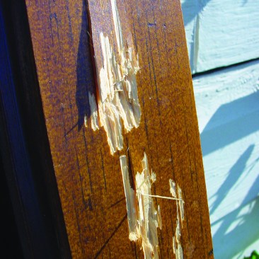

The film-forming finish on this white-cedar decking and PT rim joist is starting to fail.

Clear finishes preserve the bright “natural” look of new or newly brightened wood, but clear finishes also have the shortest working life. Clients will need to refinish every year if they want to maintain the look of fresh lumber, with deck brightening necessary as the deck ages. Currently, the best clear product in my testing is Olympic Wood Protector Clear Waterproofing Sealant.
Soak-in stains add color to wood, but without a surface film that has the potential to peel. Lack of peeling makes refinishing easier, but it also reduces the ability of the finish to prevent surface cracking. Soak-in stains typically deliver for two or three years before they need to be reapplied. Wear from foot traffic and abrasion is what typically kills soak-in stain finishes. Cetol SRD is currently my favorite finish in this category.
Tinted film-forming finishes are like a varnish for decks. The protective film can look fabulous because it imparts color while also letting wood grain show through. If your client is aiming for a rich-looking deck, a film-forming finish is the way to go.

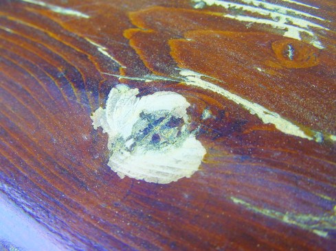

This was particularly true around knots.

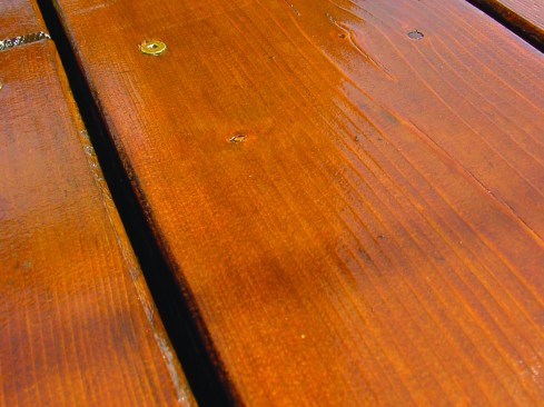

After removing the old finish and refinishing with Cetol Dek, the cedar decking looks just like new.

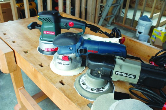

Sometimes a light sanding with a random-orbit sander is enough to prep decking for a new finish.
On large decks, you may want to rent a walk-behind drum or orbital sander.

In those small areas where the finish has peeled down to bare wood (usually around knots), sand off any loose frazzles of finish. Nothing can be left loose. Vacuum up the dust, then recoat with the original product used previously. If the finish is still mostly in good shape, only one coat is necessary. If more than 20% of the surface is bare wood, apply two coats. Don’t coat more than twice since too much deck finish can encourage peeling by trapping moisture in the wood. In fact, over-coating is a common cause for deck-finish failure.

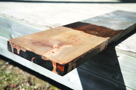

By the time most deck owners get serious about refinishing, the decking is already suffering from a complete finish failure. To make the wood look good again, you’ll have to remove all traces of the old finish and gray wood. After that, the finishing process is the same as if you are dealing with new lumber.
Exactly how you strip off the old finish depends on the size of the deck and the equipment you have available. You could simply sand to remove the old finish, but the fastest approach usually involves a water-soluble chemical deck stripper, such as Extreme Solutions EFC-38 or Restore-A-Deck. Neither of these work perfectly, but they are relatively benign (especially compared with strippers that contain methylene chloride) and are about as good as strippers get. I apply these strippers with a brush or a roller, then clean them off with a pressure washer.

You’ll still need to finish up with sanding, and the end result should look pretty much like a deck made of new lumber. The only difference might be if there are deep cracks caused by weathering. If the gray color runs deep and persists after sanding, a traditional deck brightener can be used. In many cases, you’ll need to use a neutralizer afterward to balance the pH, as most brighteners contain oxalic acid. I’ve had good luck with an oxygen-based mold-stain remover called Duo Blast, which works exceptionally well on weathered wood with no need for neutralizing. It also poses no threat to plants, making it a good choice when the deck is surrounded by expensive landscaping.

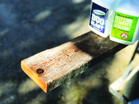

After removing the old finish, you may need to use a deck brightener to return color to weathered, gray
decking.
After removing the old finish, you may need to use a deck brightener to return color to weathered, gray decking.
Some brighteners contain oxalic acid and need to be neutralized afterward, but the author recommends Duo Blast, which isn’t harmful to plants and requires only a water rinse.

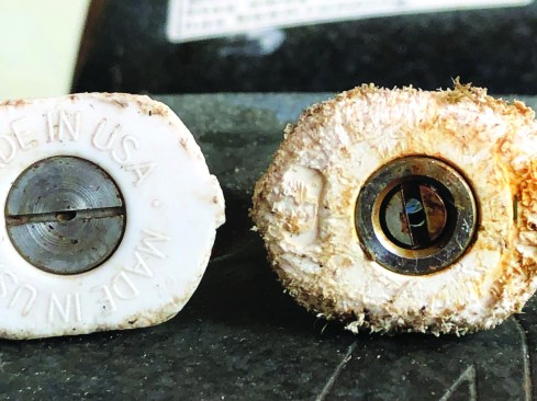

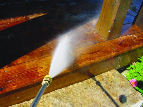

A pressure washer is a nice tool to have for preparing a new deck for finishing, but it’s virtually mandatory for stripping an old deck finish. Gasoline-powered versions speed up the work considerably because they deliver a greater volume of water at considerably higher pressures than electric models. At minimum, the pressure washer should put out at least 2,000 pounds per square inch (psi) of pressure; 3,000- to 4,000-psi units are even better.
Pressure washing is effective at removing dirt and failing finishes.
Be sure to match the tip size to the operating pressure of the unit.
John Paulin
Otherwise the wood could be damaged.

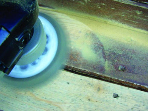

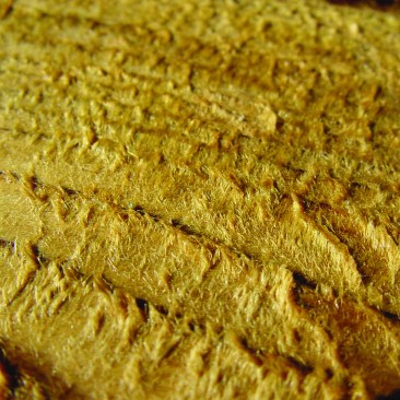

After power washing, use a sander to remove the fuzzy wood fibers that have been raised during the process.
Pressure washers can easily damage decking if you let the tip come too close to the wood. I recommend using the largest and lowest-pressure tip at first, holding the spray wand at least 18 inches away from the wood, and changing to a more aggressive tip incrementally and only if more power is needed.
Pressure washing removes grit (on old decks) and sawdust (on new decks). It also helps break down surface burnishing and repellent treatments that could impair finish absorption.
After pressure washing, a light sanding ensures full absorbency and gets rid of fuzzy wood fibers that might have been raised by the washing. For final cleanup after sanding and before finish application, a gas-powered leaf blower is a great tool.

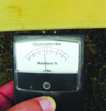

Moisture Testing
Once upon a time, common wisdom said to wait a year before finishing a new deck, allowing time for even the wettest lumber to weather and dry out. But why wait when you don’t have to? Moisture meters are relatively inexpensive and effective at determining the moisture content of wood. Besides reducing the risk of premature finish failure, using a moisture meter makes you look more professional in the eyes of clients.
If you’re dealing with an older deck, a moisture meter will tell you if you’ve waited long enough after pressure-washing or wet weather to finish the deck safely. If you’re finishing a new pressure-treated deck, a moisture meter is even more important. Get the kind with pins that penetrate into the wood, and measure the moisture content on the fresh face of newly-sawn lumber samples. Wet wood can dry superficially and register an appropriate moisture content on the surface (15% or less), while excess moisture might still remain deep within the wood, ready to migrate out and cause finish failure.
Measure, don’t guess. A moisture meter should be used before applying any finish to make sure the moisture content throughout the decking is within an acceptable range, typically less than 15%.

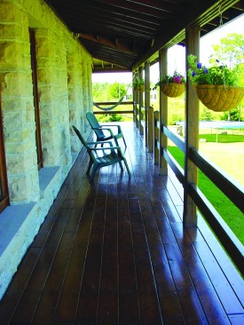

After being refinished with two coats of Cetol Dek, this decking has the patina of fine furniture. The first coat was with dark oak, while the second coat was a natural finish.

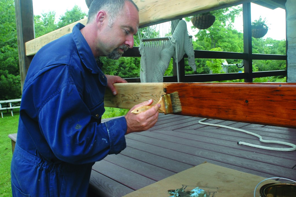

As you work, maintain a wet edge if you’re applying any sort of finish that forms a surface film. This prevents brush marks and lap marks where one area meets another. The only exceptions to the “wet edge” rule are for Eco Wood Treatment and Minwax Exterior Teak Oil. Both can be applied in full sun, as temperature doesn’t seem to matter much, and there’s no need to maintain a wet edge.
All else being equal, brush application of deck finishes results in longer life because the brushing action drives the finish deeper into the wood pores. This is especially true with any kind of film-forming deck finish.
