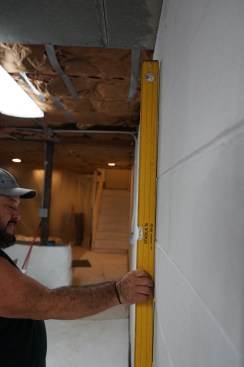

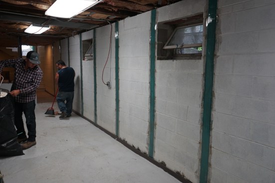

Our company specializes in structural restorations, and we are regularly called on to repair basement walls. I have covered a number of techniques we employ for this in past articles; here, I cover the use of structural strapping to reinforce the interior of a basement wall that has bowed inward.
Structural strapping is made from several different materials. The type we’re using on the job shown in this article is a woven grid of carbon fiber and Kevlar, which is bonded to the foundation wall with a two-part epoxy.

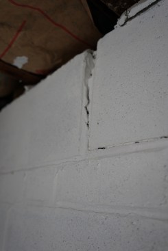

Foundations fail for many different reasons; typically, the walls are underengineered. Often, the walls lack enough rebar or were otherwise not built as stoutly as originally designed.

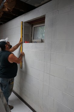

With this project, we were asked to first verify the floor slab thickness in several locations and notify the engineer of our findings. He determined that the slab was thick enough to restrain the bottom of the foundation wall. We also pulled the insulation out of the joist cavities to verify that the sill plate was anchored to the foundation wall, checking for anchor diameter and spacing. We relayed these details to the engineer to verify the sill-to-foundation connection, which he determined was acceptable. However, in some areas, he did ask us to add angle brackets to reinforce the floor-joist-to-sill-plate connection.

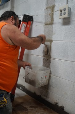

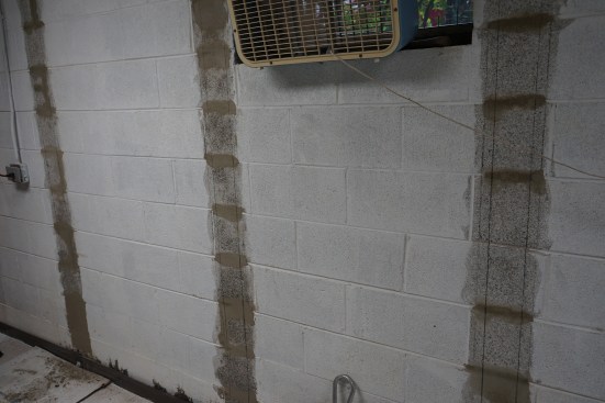

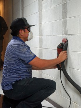

After setting up the site with temporary lighting, painter’s plastic, an air scrubber, and drop cloths, we laid out the project. On this specific job, the engineer specified strapping “not to exceed 4′ 0″ on center.” We laid out the strap locations on the wall and began to prep the wall by removing the paint with a grinder so we had a clean surface. (If there’s no paint present, we usually still go over the strap locations with a surface grinder to ensure a good epoxy bond.) We also pointed the mortar joints and any horizontal cracks so we had a flat surface at each strap location.

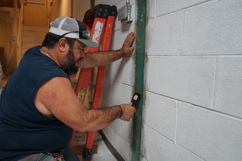

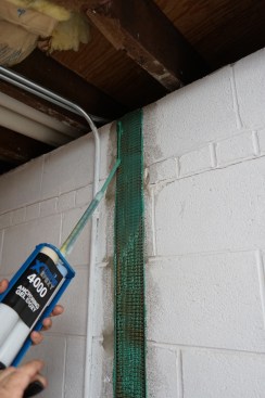

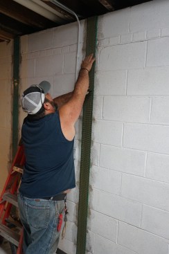

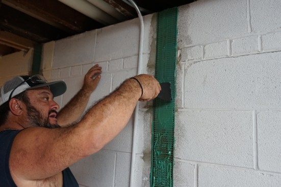

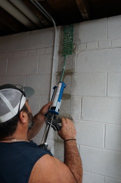

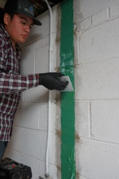

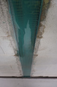

With the wall fully prepped, we were ready to lay down a bed of epoxy, spreading it out to ensure complete coverage. We then applied the strapping, pressing it firmly into the epoxy. The goal is to have the strapping fully saturated and encased within the epoxy. To achieve this, we needed to add epoxy to the outer face of the strap and smooth it out with a plastic applicator. The manufacturer of the reinforcing strap used here requires covering it with a thin sheet of plastic and pressing out any air bubbles that are trapped within the assembly. The thin sheet of plastic must stay on until the epoxy fully cures. We left it on, but it can be removed after the epoxy cures if you wish to paint over the repair.
