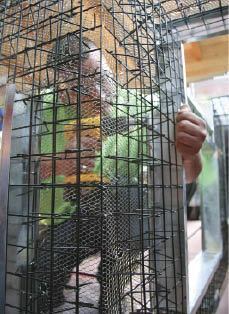

On this job, though, I discovered a great alternative to more traditional methods: Galvacore’s structural panels (775/843-6900, galvacore.com). Each panel consists of two galvanized-steel welded-wire sheets with a wire truss in between (Figure 1). The panels can be formed into a wide range of shapes, and they’re lightweight and relatively inexpensive ($160 for a 3-foot-by-8-foot panel, either 1 1/2 or 3 inches thick; 4×8 panels cost $200). Installed vertically as a wall, they can curve around a radius as small as 18 inches. Installed horizontally as a countertop base, they can cantilever up to 18 inches without additional supports, and span up to eight feet. Once in place, Galvacore panels are covered with wire lath. From that point, adding the masonry finish materials is the same as with a stud or block cabinet.
Figure 1. Structural panels made from heavy-gauge galvanized wire form the skeleton of this outdoor kitchen.

Building with the panels is easy. Once the deck is built, spread construction paper to protect the decking from damage during the stuccoing, chalk out the kitchen’s footprint, and screw the mounting brackets supplied by Galvacore to the deck (Figure 2).
