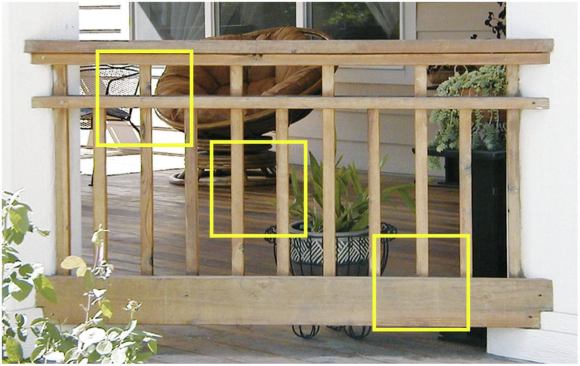

Each of the yellow squares drawn on the photo above depicts one square foot. Guards must be able to resist a 50-pound load applied over any onesquare-foot area between the guard’s top and the deck floor. In practice, this means that no single baluster has to resist the load alone.

The infill region — the area between the deck floor and the guard’s top — is required to resist a load of 50 pounds applied over a one-square-foot area, as detailed in footnote f of Table R301.5 of the IRC and chapter 16 of the IBC. The load and area are based on the American Society of Civil Engineers‘ Standard 7, which provides minimum design loads for buildings and structures. Similar to the safety factor built into the load testing at the top of a guard, a safety factor of 2 or 2.5 is applied to infill load testing, resulting in test loads that actually reach upward of 125 pounds.
The significance of the 12-inch-by-12-inch square is that a single baluster is not expected to withstand the load by itself, as that area will include at least two, if not more, balusters (see photo, above). Rumor has it that some inspectors have combined checking for 4-inch spacing with checking for load resistance by forcing balusters apart to see if the resulting opening measures more than 4 inches. I’ve heard other reports that a 50-pound force has been applied to a 4-inch sphere in an attempt to push it through guard infill, such as steel cable rails. But those practices are not supported by the IRC or IBC, as only the load resistance described above is required.
