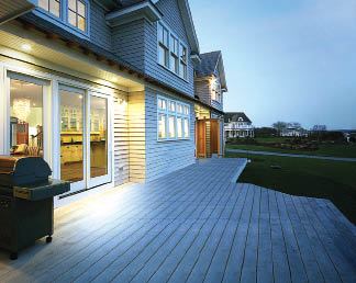

Accoya wood is guaranteed for 50 years in exterior use and 25 years when used in the ground (Figure 4). Impressive. It’s made from sustainable Radiata pine – another plus from a green perspective. However, it’s grown in New Zealand and shipped to the Netherlands for treatment; from there it’s shipped to the U.S. for sale as rough lumber. Thus the wood travels farther and requires more energy to transport than South American hardwoods.
Photo by Accoya
Figure 4. Acetylated wood has had a European market for several years.
Kimberly Lancaster-Hageman didn’t object to that, though, when she was choosing decking for her ocean-front house in Rhode Island (see photo on page 46). Her location is subject to periods of horizontal, wind-driven rain and brutal sun. “I researched it to death,” she says, “and I knew I wanted decking that wasn’t a food source for insects and mold.” She considered composite decking but decided she wanted wood that would turn silvery grey. “The Accoya cost a little more than [composite lumber] and a little less than ipe.” Her decks were installed in early 2009, with TigerClaw invisible fasteners. “The decks have performed fabulously,” she says. “No splitting, no splintering.”
Acetylated wood is currently available from only five distributors in the U.S., although Accsys Technologies says it plans to increase distributorship, and earlier this year it announced it was increasing wood production by 50 percent.
