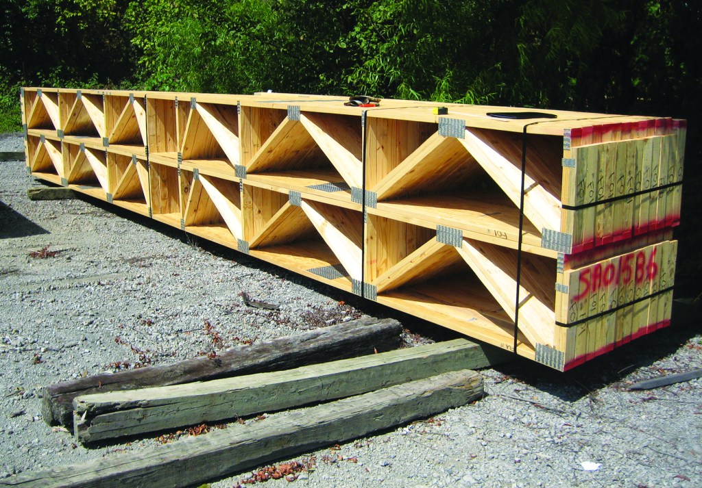

In a typical floor system framed with truss joists, a nonstructural ribbon board is attached to the top of the floor trusses, as shown here. This 2×4 ribbon board is not intended for a deck ledger attachment.
However, when floor trusses are installed, a band joist is not present; instead, a nonstructural ribbon board is typically attached to the top of the floor trusses (see drawing, left). This presents a problem for deck builders because the 2×4 ribbon board is not structurally adequate for a deck ledger attachment. Both the Structural Building Components Association and the AWC (in DCA-6, Figure 13B) specifically indicate that the 2×4 ribbon board is not intended for deck attachment.

Structural considerations. In a typical cantilever truss detail, 2×4 ribbon boards are nailed across the ends of the trusses at the top and bottom, with short verticals called “ribbon blocks” sometimes attached to the ends of the trusses and ribbon boards with 1×3 or 1 1/2×3 plates (see floor truss cantilever illustrations, below). To help visualize a plated cantilever floor truss, we referred to a detail published by Mitek in 2011 that shows the cantilever supporting a load-bearing wall. Note, however, that the detail does not indicate the vertical 2×4 ribbon block is a suitable connection point for supporting a deck ledger.
