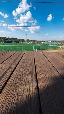

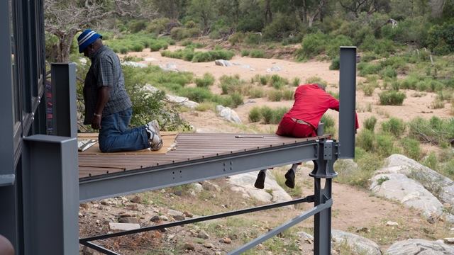

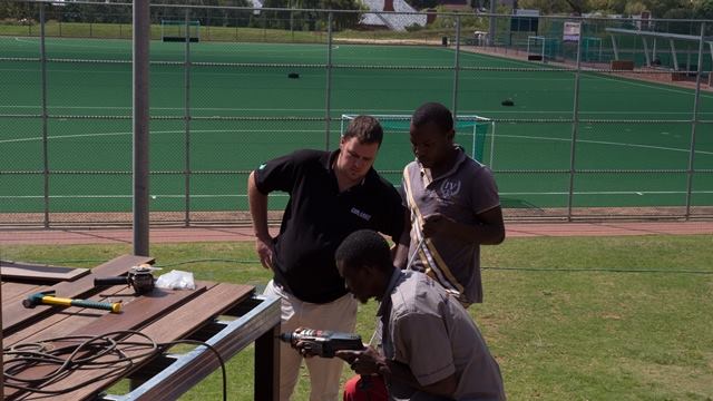

Nathan took us to a large private school where Eva-Last was sponsoring a dining deck for an upcoming sports event, and where I finally was able to take a look at the Eva-Last deck board. Like what you’d see on any construction site, the boards were dirty and strewn with tools, but I thought they still looked pretty good. The construction of the deck was with steel substructure. I was surprised at the narrow span between posts and the small size of the beams and joists. I would later learn their reasons.

Over a dinner of poijke and pap (pronounced poy-key and pop, it is lamb stew and firm corn mush), I learned the hows and whys of South African deck building. For one thing, pressure-treated lumber is milled from African Pine, which only grows big enough to make boards up to 2×6. This necessitates framing with 2x4s 16 inches on-center, supported by 2×6 beams screwed to the sides of pressure-treated gum poles (round eucalyptus poles 4 to 6 inches in diameter) that are located on 4-foot centers. The gum poles are buried in the ground two feet deep, and embedded in concrete. Because African pine warps and twists severely, South African deck builders have begun to frame with metal instead, using metal 3 ½-inch-deep steel joists supported by double 2×6 metal beams that are welded to steel posts spaced 4 feet on-center.

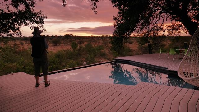

When Nathan and Marc formed Eva-Last about 16 years ago, they began by importing composite decking from the U.S., acting as a distributor. Composite decking was a new idea in South Africa, and they had trouble finding deck builders willing to build with it, so they started the construction arm of the company and began building decks themselves. After a couple of years in the harsh African climate, however, the American-made decking began to fail, they told me. I saw evidence of this as I sat on the CorrectDeck deck at the lodge in Balule Plains.

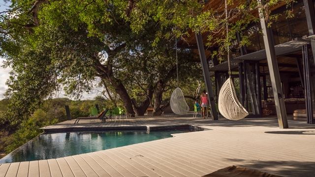

Relying on Marc’s expertise in the field of chemistry, they began manufacturing their own composite decking boards, designed specifically to withstand South Africa’s extreme conditions. Since then, Eva-Last has gone through 14 generations of deck boards, with the latest version being a capstock with a rotating wood-grain pattern deeply indented into the board on both sides. The look and feel is impressive, especially the deep, rich colors that are unlike anything I’ve seen in the U.S. market. The board is designed for a unique hidden fastener system in which the clips are designed to allow for expansion and contraction in the deck boards, and the clips can be removed and a board replaced in the middle of a deck without your having to remove all of the other boards.
Marc and Nathan claim that their product is holding up very well wherever it is used. Some projects of note include English Point Marina in Mombasa, Kenya, an expansive project with docks, boardwalks, and various levels of decks; Aqua Park in Azerbaijan, where their decking has been used to build a 1 1/2 –mile-long walkway along the Caspian Sea; and in Luangwa Valley, in Zambia, where their decking is used for both decks and floors—in fact, the Chinzombo Bush Camp was voted Best New Safari Property of 2015.
