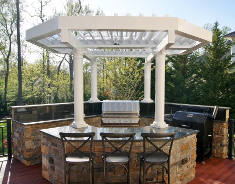

Granite countertops and stone veneer accent the top of the line stainless steel appliances on this composite deck.
Gustavo de la Cruz/Barrett Outdoors

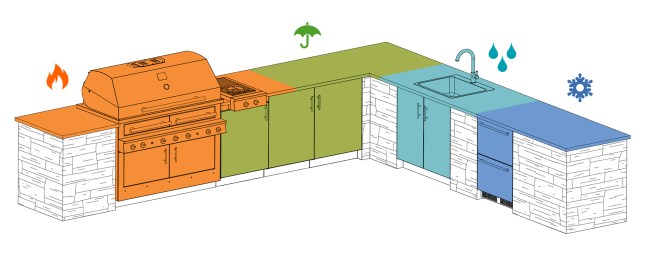

The perfect outdoor kitchen for entertaining is about more than just the appliances. Like indoor kitchens, outdoor kitchens are made up of functional zones. These include hot, cold, wet, and dry zones.
A large outdoor kitchen typically includes hot, cold, wet, and dry work zones. In smaller kitchens, cold and wet zones are often eliminated, though adequate dry zones are still needed for prep work and storage. Where zones are separated by an aisle, the aisle should be at least 48 inches wide (for a single cook) and 54 inches wide (for two cooks).
Kalamazoo Outdoor Gourmet
Hot zones, not surprisingly, consist of all cooking areas, like grills, pizza ovens, and cooktops; cold zones include refrigeration and freezers; wet zones include sinks and adjacent workspace; and dry zones are dry prep counters and storage. The key to designing an outdoor kitchen that functions well is planning for all four zones to work together, along with providing plenty of countertop space to support the “workflows” of prepping, cooking, serving, and cleaning. For example, the cold zone should be next to the wet zone, to facilitate moving food from the refrigerator to the sink to wash it and get it ready for grilling in the hot zone.

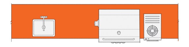

Ideally, you should provide your clients with free and clear “landing areas” on both sides of grills, sinks, and cooktops. This space can be used for ingredients, cutting boards, platters, colanders, and other items that the cook needs to have close at hand while using the station. When it’s time to pull the swordfish steaks off the grill, for instance, there needs to be space next to the grill where a platter can be ready and waiting.
Omitting landing areas on one side or both sides of key equipment such as the grill or the sink is the most common design mistake. Similarly, grills and sinks should never be placed at the end of a counter run; there should always be landing areas to the left and right sides of both.
To figure out how much space you should provide for your clients, you can use the following recommendations of basic landing-area dimensions for common outdoor kitchen workstations:
Grills. Be sure to keep 24 inches of open counter on one side and 12 inches on the other side.
Cooktops. Maintain 12 inches of open counter on each side. However, when you combine a grill and a cooktop into one station by positioning them next to each other, use the landing area recommendations for a grill (24 inches on one side and 12 inches on the other).
Sinks require 18 inches of open counter on each side, because your clients will be doing a lot of washing and cleaning in that area.
Pizza ovens. Landing areas are especially important for pizza prep work. Provide 24 inches of open counter on one side and 12 inches on the other side.
Kegs. Having room to place and set aside glasses is important for the keg tapper, so provide 12 inches of open counter on each side.
Under-counter refrigerator/ice maker. Be sure to have 15 inches of open counter above it.
To determine the landing area between two pieces of equipment, multiply the largest recommended landing area for one of the pieces of equipment by 1.5. In this case, the landing area between the grill and the sink should be 36 inches (24 inches x 1.5 = 36).
When multiple workstations are combined, the minimum landing area between two pieces of equipment may be determined by adding 50% to the largest landing-area width recommended for the two pieces of equipment. For example, the landing area between a grill and a sink should be at least 36 inches wide because the largest recommended landing area related to those two pieces of equipment is 24 inches next to the grill.

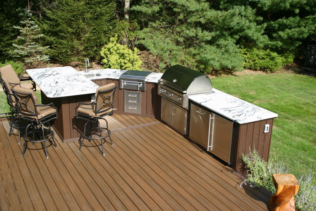

This outdoor kitchen features granite countertops and cabinets faced with stacked stone. Rain or shine, shelter is provided by an Equinox louvered octagonal pergola, supported by custom PVC columns.
Sean McAleer/Deck Remodelers
