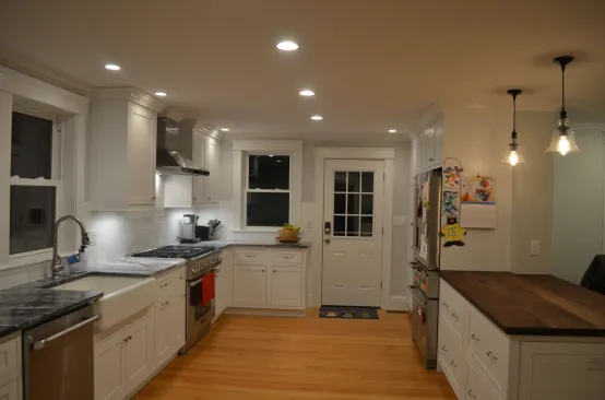

Ambient Light
Ambient light is the general lighting for the entire kitchen space, and it should closely mimic the natural daytime light in the room. When choosing ambient light sources for a kitchen, consider the kitchen size and ceiling height. The bigger the kitchen and the higher the ceiling, the more ambient light output is required, which usually means that more fixtures will be needed.
Fixtures for providing ambient light can vary, and different sources can be combined to create a pleasing balance. The important thing is to avoid creating dead zones—areas that are dim, with little or no light. At the same time, be conscious of creating hot spots where light from multiple sources overlaps and creates an overly bright area. Here are some typical sources for ambient lighting.
Recessed downlights are a common option for ambient kitchen lighting.
Carolyn Anderson
Recessed downlights are the most common choice for ambient kitchen lighting. They’re the most effective type of lighting, although in small kitchens, they should be used judiciously. Recessed downlights are typically spaced 4 to 5 feet apart, either on a grid or in a line depending on the kitchen layout and ceiling height.
Be aware that recessed downlights often serve double-duty as task lighting. So positioning of these lights above counters and cabinets is critical (more on this later, in the discussion of task lighting). If downlights are the only ambient light sources, 6-inch-diameter fixtures that have a wider spread of light are the best choice.

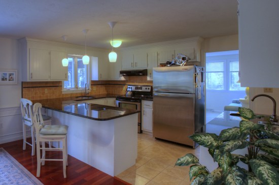

Ceiling-mount fixtures come in either flush-mount models that attach directly to the ceiling or semi-flush-mount models that drop a short distance below the ceiling. Either type is a good choice for an older, smaller kitchen with a low ceiling. In such a kitchen, a single flush-mount fixture can be placed centrally; or two fixtures can divide a larger kitchen into thirds.
These fixtures can also work well when supplemented by other light sources, such as pendants over an island or peninsula. In a home with low ceilings (7 to 7 1/2 feet), ceiling-mount fixtures can provide more comfortable light than downlights. These fixtures typically have translucent lenses or glass shades that diffuse the light throughout a room. Downlights, on the other hand, direct a more concentrated cone of light downward and tend to create uneven light in kitchens with low ceilings.
The lower positioning of semi-flush-mount fixtures lets more light reflect from the ceiling, but they work better with slightly higher ceilings because they hang down lower than flush mounts.
A flush-mount light in the center of the kitchen can work in concert with
pendants over a peninsula.

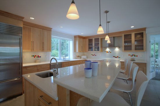

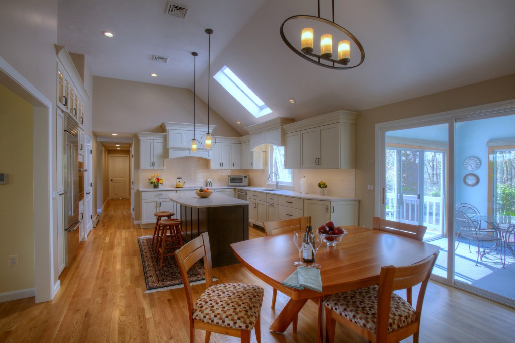

Chandeliers and pendants. For two-story, tray, cathedral, or pitched ceilings that are 10 or more feet high, chandeliers and pendants can provide effective ambient light. These fixtures bring light down to a more human scale in rooms with high ceilings and are often used to supplement other light sources. In addition to providing light, pendants and chandeliers can be a focal point in an otherwise simple design.
Pendants above an island can provide ambient light on their own.
Roe Osborn
For small kitchens, a single fixture may be enough, especially if supplementing downlights. If the kitchen is very large, two or more fixtures work well in areas such as over a large island. When multiple pendants are used for ambient lighting, they should be no less than 6 feet apart and no less than 6 feet from any structure such as a wall or upper cabinet. The bottom of pendants and chandeliers should be at least 7 feet above the floor so they don’t block views, and they should be controlled with a dimmer to be effective for ambient lighting. The output of these lights should be between 100W to 250W equivalent, bright enough to light the kitchen when it’s entered.

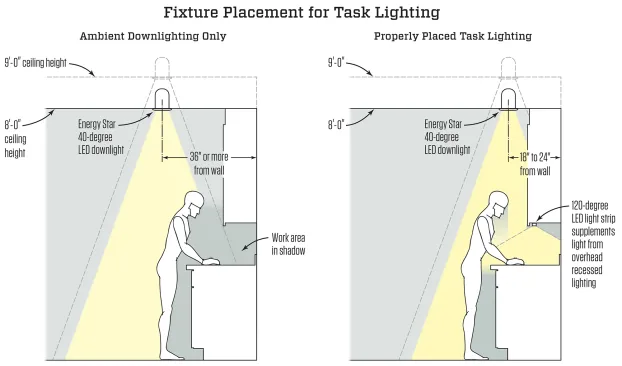

The illustration on the left shows the all-too-frequent poor placement of stand-alone ambient downlighting in a kitchen. In this scenario, the person working at the counter casts a shadow over the work area. On the right, downlights placed much closer to the wall light up the work area and are supplemented with under-cabinet lights to provide effective task lighting.
Tim Healey

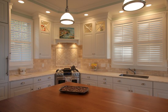

Downlights are placed in front of the cabinets in the ceiling.
Carolyn Anderson

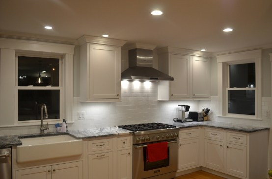

Recessed downlights. Earlier, I said that attention should be paid to the placement of recessed downlights that are used for task lighting. These fixtures should be placed 18 to 24 inches out from the wall to minimize shadows on countertops created by an overhead light behind the person working there (see Fixture Placement for Task Lighting, above). This placement means that with 12-inch-deep wall cabinets, the downlight fixtures should be just 6 to 12 inches from the face of the cabinet.
Or downlights can be placed in soffits for task lighting.
Roe Osborn
If they are more than 7 feet high and project out far enough, soffits above cabinets are a good place for recessed downlighting. And if the cabinets are white or light-colored, the reflected light from the cabinet faces will enhance the task lighting. I typically use 4-inch downlights for task lighting because they produce a more focused beam of light than the 6-inch fixtures I use for ambient light.
Fixture spacing should be a function of the ceiling height. The higher the ceiling or soffit, the farther apart the fixtures can be, but higher output is needed with the light source farther from the work surface. That said, I usually center lights on upper cabinets so the fixtures light the interior when the doors are open. Just make sure that the cones of illumination light the work surface evenly.
Under-cabinet lights hide behind a light rail
Carolyn Anderson
Under-cabinet lighting. Though recessed downlights can offer adequate task lighting by themselves, they work best in concert with under-cabinet lighting, which puts a light source below the upper cabinets, where small appliances and cooking implements are often stored and where food is placed as meals are prepared.
The under-cabinet fluorescent fixtures of 20 years ago have been replaced by low-profile dimmable LED strip lights that create pleasing, warm-colored lighting. Whenever possible, I specify upper cabinets with a light rail (a 2-inch addition to the lower face frame), with the light strips directly behind the rail. The fixtures I prefer are 1 inch wide and only 1/2 inch deep so they aren’t visible to someone sitting in the kitchen. Be sure that they provide a minimum of 60W equivalent light per cabinet. For corner cabinets, I often use a single puck light instead of a strip, also with 60W equivalent.
Pendant task lighting. Peninsulas and islands often offer the largest work surfaces in a kitchen, and many islands have prep sinks. Pendant lights in these areas can be a single fixture or multiple ones, or multiple lights suspended from a single bar. Pendants for task lighting should be 30 to 36 inches above the countertop height (66 to 72 inches off the floor) to avoid blocking the view. They should be placed 24 to 30 inches apart, with each light providing a minimum output of 75W equivalent.
Pendants come in a variety of styles and prices. These fixtures are often a distinct design feature, so be careful that they blend with the style of the kitchen. If you’re using chandeliers or pendants for ambient light in the kitchen, avoid replicating this type of lighting over an island or peninsula, to prevent visual competition in your design. If the kitchen opens into the dining area, make sure the fixtures in both rooms relate to each other in shape, finish, or style.

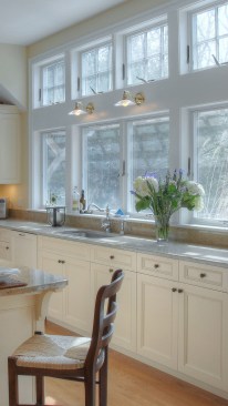

Sconces are a good over-sink option.
Roe Osborn

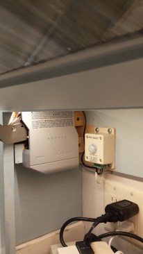

Magnetic switches can activate lights in dedicated-use cabinets.
Carolyn Anderson
Over-sink lighting. For safety reasons, task lighting over the sink is essential and should never be overlooked or skimped on. A 4-inch downlight, a pendant (12 inches out from the wall), or a sconce over a window can serve this purpose equally well 60W equivalent is fine here.
Walk-in pantry. If there’s a walk-in pantry in your kitchen project, place a downlight or flush-mount light in the pantry, controlled with a jamb switch or motion sensor. When a homeowner dashes into the pantry in the middle of preparing a meal, good lighting makes it much easier to find things. The cost for the fixture and switch is minimal, and a 60W equivalent should do the trick.
Motion-sensor drawer and cabinet lighting. For high-end kitchens or for clients with limited vision, motion sensors or magnetic switches for certain drawers and cabinets can provide extra light in places that are not usually well lit, or where extra light might be helpful for finding a small item (a typical junk drawer comes to mind). This type of lighting is also helpful for a dedicated charging station for mobile devices in a drawer or cabinet. A sensor switch automatically turns the light on when the drawer or cabinet door is pulled open. These applications don’t require bright light; because of its low profile, an LED light strip usually works well.

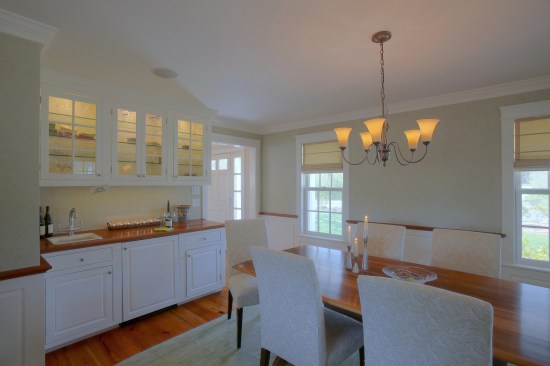

Lighted glass-front cabinets show off glassware.
Roe Osborn

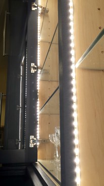

Glass-cabinet lighting. Homeowners often ask for glass panels in upper cabinets to display their finer glassware and china or their favorite ceramic objects while keeping them in a safe, clean environment. Interior cabinet lighting lends depth and dimension to cabinetry, while what is shown inside adds texture and interest to the kitchen design.
For this application, dimmable LED light tape or puck lights provide light inside and at the front of a glass-paneled cabinet. If the cabinets have face frames, light tape can be mounted behind the frame to direct the light back into the cabinet. For box-style cabinets without face frames, puck lights are the best option. For cabinets 36 or more inches wide, use two pucks to cast light onto, and not behind, the objects inside. Installed one-third of the depth into the cabinet, these fixtures cast light on the items inside.
Use glass shelving so the lights shine through to more than one level. Light levels for glass cabinets should be standard output for light tape and no more than 60W equivalent on the puck light.
Light tape mounts behind a cabinet face frame and glass shelves let light shine through to more than one level.

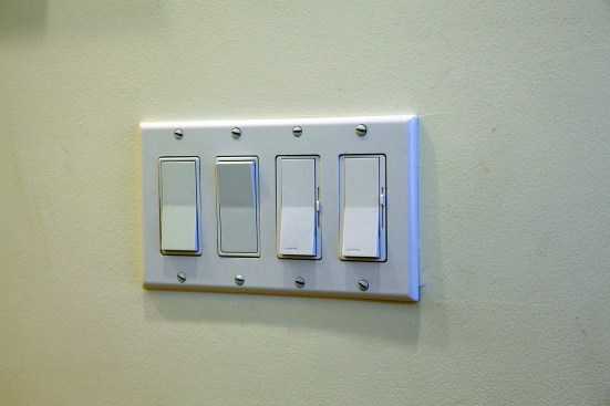

In a bank of switches at the entry to a kitchen, the first switch should always control the ambient lighting.
Roe Osborn

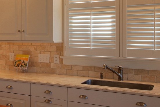

Switches near the sink control over-sink lights, while adjacent switches are for under-cabinet lights.
Roe Osborn
Switch locations. The one circuit that should be switched at every entry is the ambient lighting circuit. When you walk into a kitchen from any location, you need to turn on lighting to safely enter the room. Work with your clients to determine the entry or entries they are apt to use most commonly. Place switches for the overhead task lighting at these locations. Gang the switches for the sink light and the under-cabinet lights in the same box within easy reach of the sink. I like to put a switch for the pendants close to the island or peninsula, although a three-way switch at the most common entry is often an appreciated addition.
I find that multiple switch locations for controlling the accent lighting circuits aren’t necessary. Single switches for those circuits can be at the most commonly used entry.

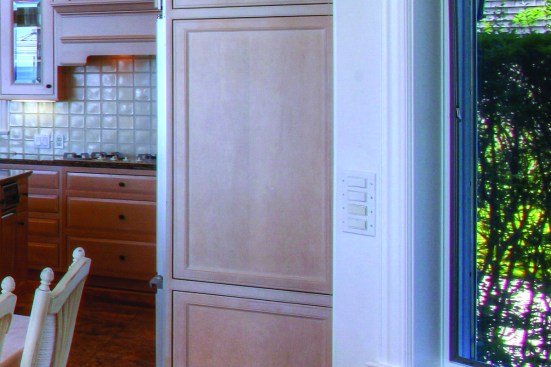

Don’t skimp on dimmers. When the kitchen budget is tight, one of the first things clients scratch off the list is dimmer switches. Dimmer switches—especially those designed to control LED bulbs—can cost four or five times what regular switches cost, so it seems like a logical target for reducing costs. But dimmer switches are something that I insist be included in every project.
Dimmers allow you to tune in the amount of light in one area or for a particular situation. For example, the amount of ambient light desired might be different for entertaining guests in the kitchen than for doing homework at the island. If people in the household have vision problems, the dimmer switch will allow them to dial up the task lighting to compensate, or lower it if their eyes are sensitive to light. Lowering light levels when not needed also saves energy and money. At these times, a dimmer switch will be worth every cent.
Keep dimmers together, if possible.
Roe Osborn
When possible, have the electrician put all the dimmers in one group of switches. This keeps things simple for the homeowner, especially when multiple switches are placed around the kitchen to control the circuits. I also have the electrician line up switches in terms of most common use: Ambient lighting always on the first switch, then task lighting, and then accent or specialty lighting.
