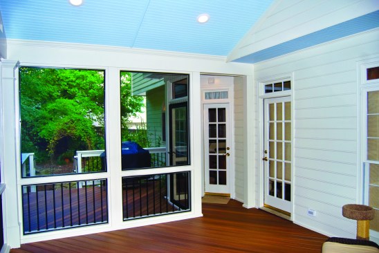

Try to locate the porch door away from seating areas, preferably on a side wall rather than an end wall. Sometimes the door can be located in an offset extension outside the main porch area.
Because most clients want to dine out on their new porch, I always try to capture a breakfast-nook or dining room entry door in the design. It’s better to carry food and drinks directly from the kitchen to the dining table, rather than take a roundabout route through the living room. Even better are French doors that open out onto the porch area, a great look that allows for a seamless entry and true extension into another living space. Sometimes, it’s possible to provide access to the porch from both dining and living rooms by “capturing” one or both doors with a porch roof offset.

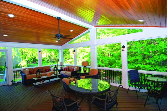

In 90% of my builds, I designed the porch to be wider than its projection out from the house. This makes it easier to divide the area into zones and arrange furniture. There’s a structural advantage too, as this configuration has more inherent lateral stability than a structure that projects out farther than its width.
The minimum suggested projection is 12 feet, though 14 feet or more is preferred (I can’t recall anyone complaining about their project being too big). To create a truly functional sitting and dining space, I recommend a 20-foot porch width. If more than 20 feet is available, the space can be divided into two zones, providing plenty of room for both sitting and dining furniture. If less than 20 feet is available, a single zone for sitting or dining could work in the smaller space.

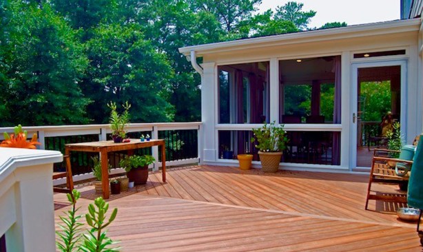

As a general rule, I like to plan a porch so that people can exit from the house, then turn left or right to travel to a screen door that is located close to the house. This avoids encroaching on the outside perimeter of the porch, where furniture can be located without worrying about traffic through the furnished area. It’s also easier to integrate a screen door into the design when it’s located on a side wall than it is when it’s located on an end wall, especially on a gable porch.
Every rule has an exception, of course, and some homeowners prefer to locate furniture near a house wall, facing out. In this case, it makes sense to move the screen door out away from the house, though trimming it so that it doesn’t stick out as an oddity can be a challenge.

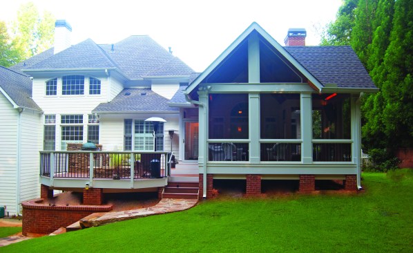

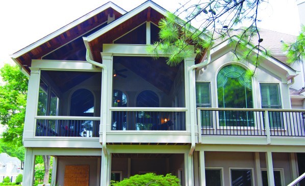

One way to blend a screen porch into the overall design of the home is to incorporate either front ...
One way to blend a screen porch into the overall design of the home is to incorporate either front …
... or side offsets into the design. Note too the use of fewer vertical supports, which opens up the view from inside the porch.
… or side offsets into the design. Note too the use of fewer vertical supports, which opens up the view from inside the porch.

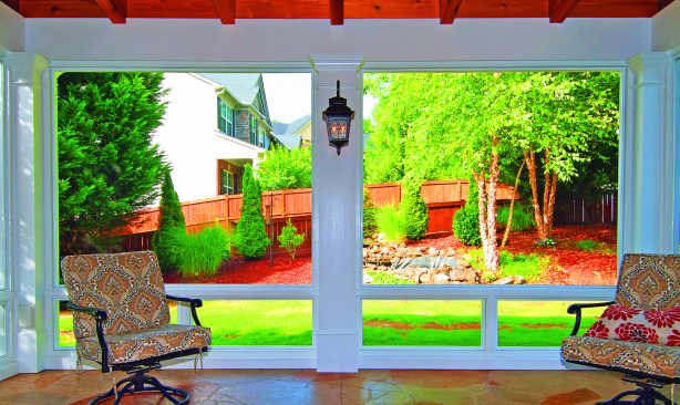

Undersized vertical supports result in a spindly look on any porch, so I typically wrap support posts at the outer corners and back at the returns against the house with PVC trim. Wrapped columns are also usually located directly under the ridge beam (when the porch has a gable roof) and occasionally to break up side wall spans.

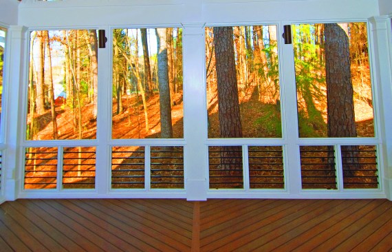

On many screened porches, you’ll see 4×4 posts located on 3-foot centers to provide frames for the screen panels. But to provide an unimpeded view from inside the porch, I prefer to use larger—but fewer—vertical members. To make sure they are capable of supporting the loads from the longer spans, these columns are typically framed with 6x6s rather than 4x4s, and finished with PVC wraps.
An open-style knee wall fitted with balusters offers enhanced views and ventilation.
A solid knee wall offers more weather protection and trim options.

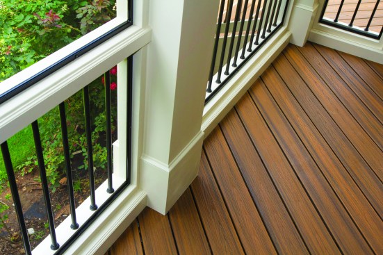

On a screened porch, I prefer knee walls rather than railings, typically building them with vertical or horizontal aluminum balusters or solid PVC panels. Baluster-style knee walls provide a better view for those who are seated and better airflow compared with solid panel options. On the other hand, solid panels offer more trim detail alternatives and can be designed to look like wainscoating or frame-and-panel trim.
Many PVC manufacturers offer 4×8 panels that are perfect for building knee walls. Unlike traditional materials such as cedar or pine, which can stain, bleed tannins, and sometimes rot, PVC doesn’t wick moisture, making it a great option for porch applications.

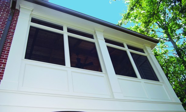

When tying in the new roof, existing overhangs will have to be addressed and (usually) modified, whether it’s a soffit underneath rafter tails, or a second-floor cantilevered soffit under a framed floor system. For example, if you were on a new porch and looked up to see fascia and soffit that was part of the original house, that would be a tip-off that the porch was not an original part of the house. Cornice overhangs, which are typically nonstructural, can be removed and reworked with siding or trim, while second-floor cantilevered floor structures can be modified by simply resurfacing the soffit area to match the porch ceiling material.

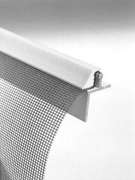

Like most contractors, I used a local fabricator to produce my screen panels (see “Screen Options for Porches,” Jul/Aug 2015). These typically have extruded powder-coated aluminum frames fitted with fiberglass or polyester screening. Other options include purchasing frame stock and assembling the panels on site or installing a base-and-cap-type system (shown left is the ScreenEze system). Motorized retractable screens are an interesting—but more expensive—alternative; these disappear entirely, so that the porch can be left open or closed off when mosquitos and other flying creatures become a problem. Regardless of the system, I recommend high-visibility screening, such as Phifer’s BetterVue or UltraVue products, which allow more light and air into the room.

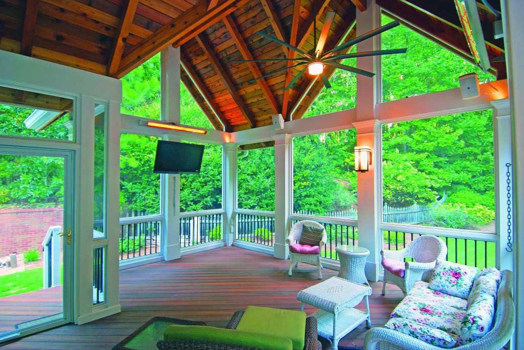

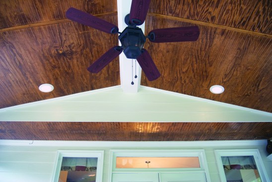

Regardless of the roof type, the key to interior ceiling design is to maintain balance with whatever you use to finish the ceiling. If the rafters are exposed or if there will be a beadboard treatment, determine in advance where lighting fixtures and ceiling fans will located so that the panels and breaks are oriented properly. It’s also a good idea to check existing electrical panel capacities to make sure there’s room for expansion before pricing and contracting a project.
Popular ceiling finishes include cedar with exposed rafters, beadboard underneath rafters, and even cypress. In addition to these traditional materials, homeowners can now choose from newer products, such as Versatex’s Canvas series PVC boards, a traditional-looking T&G profile with a natural-looking woodgrain laminate finish.
