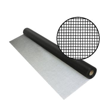

As the popularity of outdoor living spaces continues to grow, more and more homeowners are interested in enclosing their new or remodeled porches with screens. For a deck builder, this is a great upsell opportunity, especially with all of the screening and frame options that are now available to make installation easier. Metal screen fabric has largely been replaced by fiberglass or polyester screening, for example, which—in addition to separating humans from various flying or crawling critters—is better able to maintain air circulation, provide good visibility, and even reduce solar gain, if needed. Frames, too, have evolved, and while wood still rules in historic-district renovations, extruded powder-coated aluminum has become the frame material of choice everywhere else.

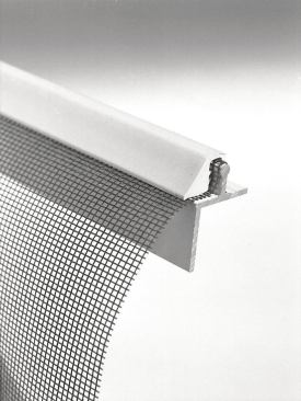

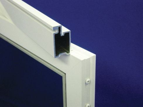

Extruded aluminum component systems are typically manufactured with a hollow box form that’s meant to be screwed to the existing porch structure. Although the profiles differ, their cross-sections generally range in size between 3/4 inch and 2 inches.. Almost all have a spline channel and can be mitered or butted at the corners. Concealed fasteners are usually the way to go, and many companies offer a vinyl cap that snaps over the screws.
One of the largest companies that produces these systems is Screen Tight (screentight.com). It offers three different lines of screens that range in price and appearance, an approach that some smaller, regional companies have repeated. Screen Tight has a wide distribution, thanks to its partnership with the two biggest-box home-improvement chains and many smaller lumberyards, so its products are readily available.
The other major player in the component market is ScreenEze (screeneze.com), which has come up with a unique approach to attaching the screen to the frame. Instead of using a spline, its aluminum frame stock is sold with a tight-fitting PVC cap that serves the same function. Once the piece is cut to length and screwed in the opening, the cap is popped off, then used to trap the screen on each of the frame sides. The system can be installed from the exterior or interior, and can support a frame size of up to 150 square feet, without additional cross-bars or supports.

In the interest of efficient work flow, many deck pros opt to buy manufactured screen panels that can be installed with a minimum of fuss. For simple screen panels, the frames are made of extruded aluminum that typically ranges in cross section from 3/4 inch by 1 1/4 inches to 1 inch by 2 inches. Frames are designed with flanges that fit over an opening or with a simple rectangular profile that registers inside the opening. Screening is splined into the frames by the fabricator.

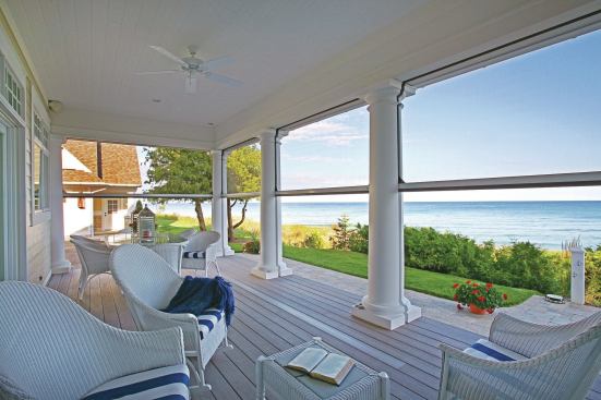

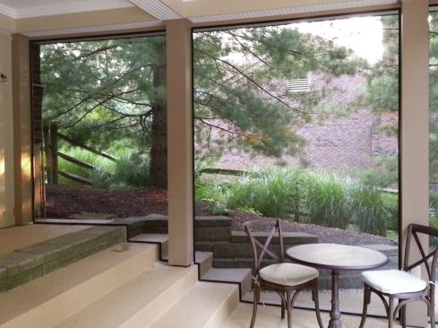

A third option for porches is a retractable screen. Related to those clever pull-to-the-side retractable screen doors, the screens operate horizontally like venetian blinds, and have weighted lower edges, sill details, and side-tracks to keep the screens insect-proof. They’re available in lengths up to 25 feet or more and can be used to reduce solar gain and glare and keep out the majority of wind and rain, in addition to excluding insects at night. When bugs are at bay and the climate is not challenging, a touch of a button activates the screens’ motorized transport, which rolls the screen panels up out of sight. (Many companies make manually-operated models as well.)
Going beyond the TV-remote approach, companies like Phantom Screens (phantomscreens.com)and Rainier Industries (rainier.com) offer a decidedly modern take on their systems. Programmable sensors that detect sun and wind loads will lower the screens to reduce solar gain and fading due to UV rays, or raise them to prevent damage to the screens due to high winds. By reducing solar gain, the screens can even qualify to earn LEED points in certain areas.
These panels are custom-fit to each opening, a process that often includes mounting the transport system into the head of the opening and even cutting track channels in vertical elements such as columns. Getting the details right can be tricky, so some manufacturers require an approved installer to do the work, while others supply a fairly detailed set of instructions.
