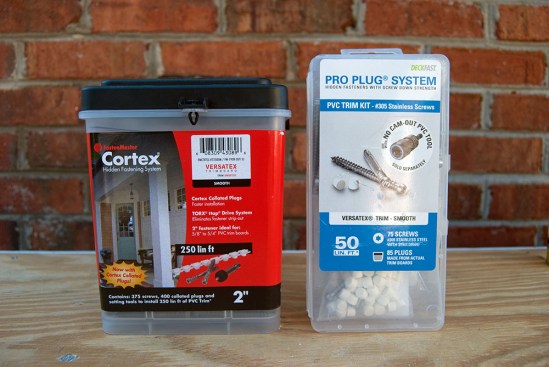

PVC trim can be installed with nails, screws, and plug systems, typically with the fasteners spaced 16 inches on-center. As a general rule, we use two fasteners every 16 inches for 1x4s and 1x6s, three for 1x8s and 1x10s, and three to four for a 1×12, but it’s always best to refer to the manufacturer’s installation guidelines.
While plugged fastener systems add to the cost of PVC trim installation, they provide a sure grip and are the best option for concealing the fasteners when the trim will remain unpainted. Some kits are color-matched to specific brands of PVC, with plugs that have both smooth and textured faces.

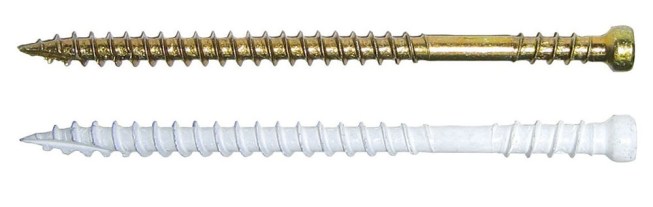

We prefer to use stainless steel rather than galvanized fasteners, sized so that at least 1 1/4 inches of the fastener penetrates into the substrate. While thin-gauge staples are not recommended for use with PVC trim, we sometimes use stainless steel finish nails along with PVC glue to make the running edge connections when building custom column wraps. Of course, some manufacturers now offer prefabricated column wrap kits that install easily without the labor needed for custom columns. In most cases, no nails are needed either, since there is typically a single running joint that only requires glue.
GRK's RT composite trim head screws have a special reverse thread near the head to prevent mushrooming. They're available in stainless steel, with a white powder-coated finish, or with the manufacturer's Climatek coating, which is AC257 approved for use with treated lumber.

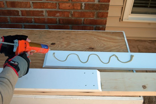

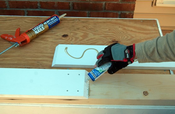

It is possible to create a PVC joint that won’t open up. To control movement at lapped butt joints—which I use when installing long runs of rail cap, outer band trim, or fascia—I employ a three-step process. First, I apply an outdoor construction adhesive (Versatex recommends Liquid Nails Heavy-Duty Construction Adhesive LN-903) to the back of both trim pieces, extending about 2 to 3 feet from each side of the butt joint. Then I fasten the first trim piece to the substrate with two pairs of fasteners, one pair an inch from the joint, and the next pair 2 inches behind the first.
To lock a PVC joint in place, the author begins by gluing the trim to the substrate with construction adhesive.
Bobby Parks

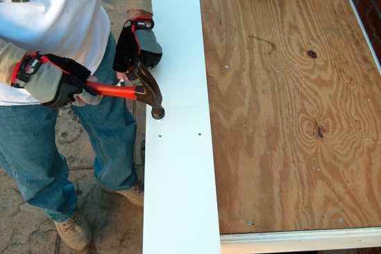

Next, I apply PVC glue (Weld-On PVC 705 works well) to the end of one of the two pieces being butted together. (Applying glue to both ends will weaken the joint by not allowing the two pieces of PVC to fuse together properly). Finally, I install the second piece of trim like the first, with a double set of fasteners. With the joint locked together like this, any thermal movement will be forced to occur away from the joint.

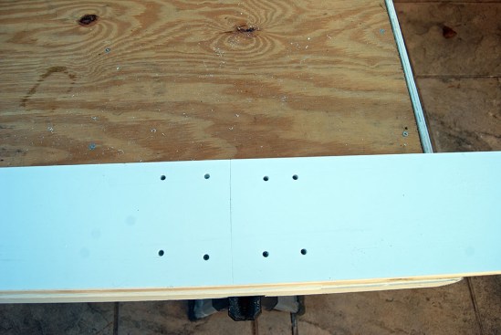

After locking the first length of trim in place with two pairs of countersunk trim screws, the author applies PVC adhesive to one face of the lap joint, which he cuts at a 45-degree bevel.

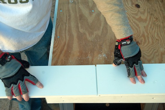

With rail cap and outer bands on decks, it’s not likely that there will be more than a couple of full lengths of run at a time. Even so, I like to make an allowance for expansion somewhere along the length of the trim, either at a corner or with a shiplap movement joint at one of the butt joints (explained below). If the run is fairly short (less than 14 feet) then I lock down any joints with the three-step process.
Four more fasteners are used to secure the second length to the substrate while the PVC adhesive in the lap joint cures.
Bobby Parks

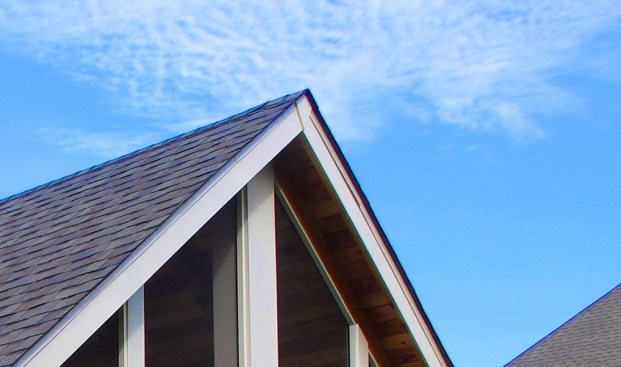

On gable fascia, I typically will install a chevron-shaped piece of decorative trim at the peak that hides the fascia joint and allows the two pieces of fascia to move.
The chevron-shaped piece of decorative trim at the peak of this porch roof conceals the joint between the two pieces of PVC fascia trim, which will open and close with changes in temperature.
Bobby Parks

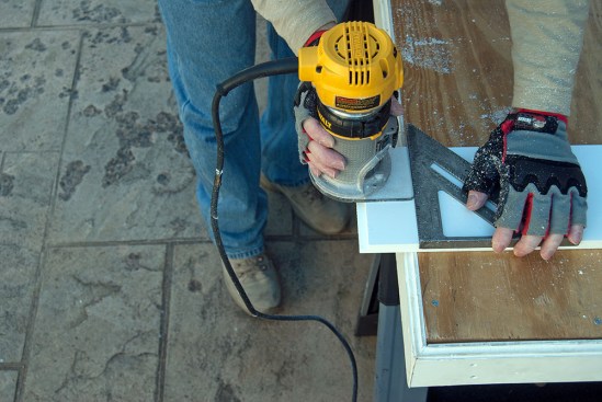

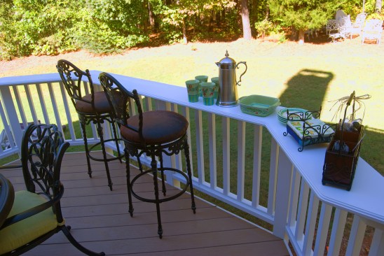

Shiplap Movement Joints
When there are longer runs with three or more boards involved, I make sure that at least one of the joints is a movement joint to handle thermal expansion and contraction. Instead of the three-step butt joint, I make a shiplap joint using a small router with a rabbeting bit. After making the initial cut into the middle of the board end, I let the router bite in and then use a layout square as a guide to keep the router from running around the corners.
Longer lengths of PVC trim require a movement joint, which the author creates by first cutting a matching shiplap profile on the end of each board with a router.
Bobby Parks
To allow for movement, I omit any adhesives and fasten the boards with single pairs of fasteners about an inch from the end of each board. Some builders fill their movement joints with a flexible sealant, but my feeling is that even if there is movement, there will still be material in the gap to block moisture from penetrating beneath the trim into the underlying substrate when it opens up. When possible, I try to locate shiplap expansion joints in the least visible areas.
It's best to place a shiplap movement joint in an unobtrusive location, as the joint will be visible in cooler weather when the boards contract. Some builders will fill the gap with sealant, but this step isn't necessary since the joint itself will block most moisture from penetrating to the substrate.
Bobby Parks

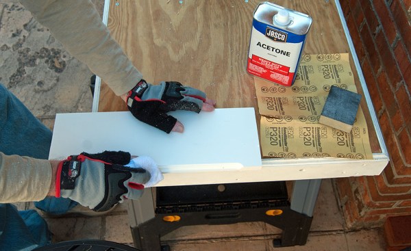

Closing Up the Cells

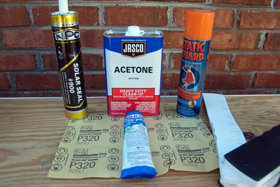

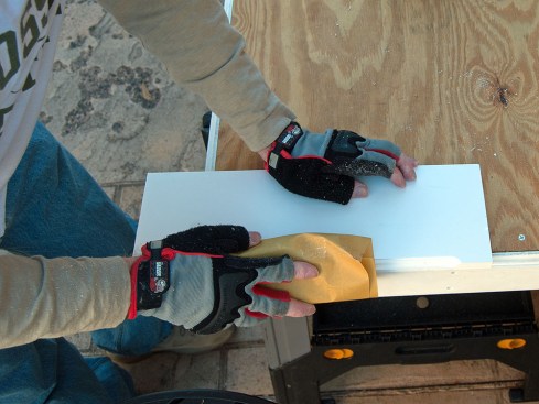

Routing and ripping PVC opens up cells in the material, which can then trap dirt and debris. The same thing occurs on end cuts that are left exposed. To address this problem, I lightly hand-sand cut or routed edges with 320-grit sandpaper, and then wipe with a cloth soaked with acetone. The acetone chemically reacts with the open cells, heating them and closing them up.
After cutting or routing PVC trim, the author gives the cut a light sanding with 320-grit paper.
Bobby Parks
After sanding, wiping the cut down with acetone causes a chemical reaction in the PVC that closes up the cells and prevents the cut edge from trapping dirt.
Bobby Parks
If a long rip cut is involved, a palm sander with 320-grit paper speeds up the process. But keep in mind that the goal isn’t to sand the material until it’s closed up, but only to get the process started. It’s the acetone that does that work.

Urethane caulk must be used with PVC trim; silicone will not adhere properly. If the caulk tube doesn’t have a metal end cap, it’s likely the wrong caulk. If we’re using Versatex and aren’t planning on doing any painting, we use NPC’s Solar Seal 900 because it’s color-matched to this particular product, and it has a lot of elasticity.

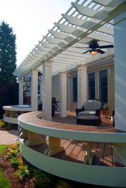

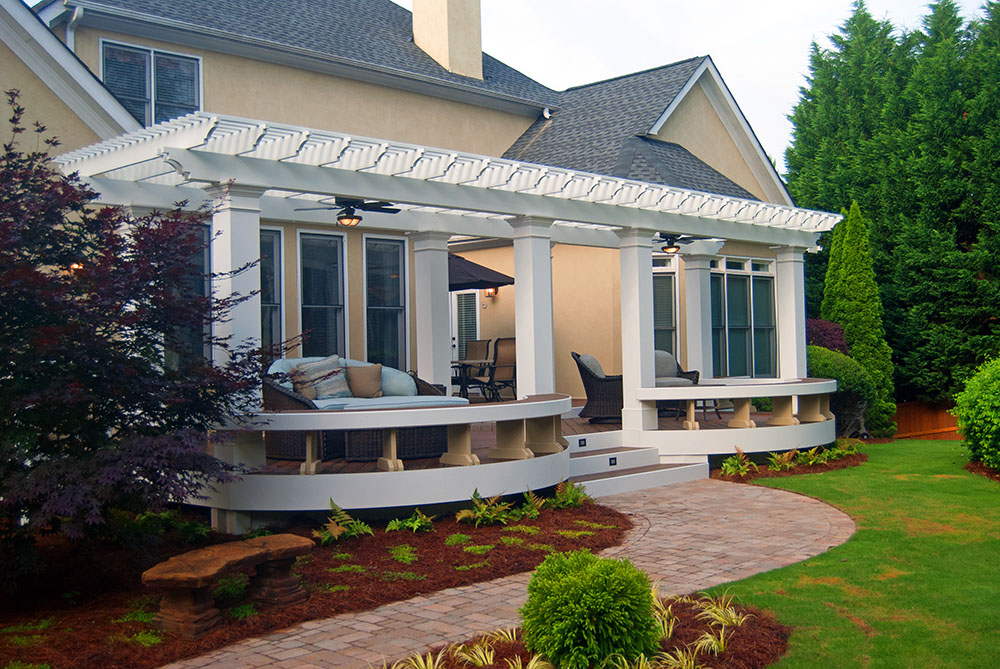

An Upgrade That Improves Your Bottom Line
I’ve since sold my Atlanta-area deck and porch company, but when I founded it, I created a short list of high-performance products that I wanted to incorporate as standard offerings to our clients. Cellular PVC trim was one of the products on that list, because I believed in its performance and felt that the value that it brought to a job was well worth the slight increase in cost (which will vary a lot depending on the project, the market, and local labor costs, especially if a screw-and-plug system is used).

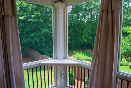

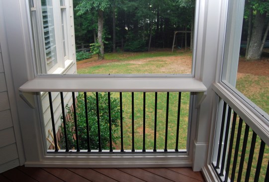

The beauty of PVC trim is its versatility; here it's used to create a maintenance-free corner nook on a porch.
Bobby Parks
Over the years, it proved to be easy to communicate that value to prospective customers, especially those who had dealt with repairs and maintenance issues in the past. In fact, one of the keys to my success as a contractor was using high-performing products such as cellular PVC trim, which did a good job of differentiating my company from my competitors.
