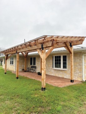

Framed as a freestanding pergola but with a clear roof, this patio cover is designed to allow plenty of light into the home.
We had closed in the original front porch to add some living space, so we designed the pergola to provide a new sheltered entry and some curb appeal as well. But while my aunt wanted a covered porch, she also wanted to allow natural light into the front windows of the house, particularly the front kitchen window. These considerations guided her choice of a clear cover. Our research led us to Regal Plastics’ Hercules System, which consists of commercial-grade, four-walled polycarbonate sheets and the accessories needed for their installation.

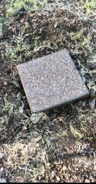

Since the concrete patio that we had placed wasn’t deep enough to support the posts for the front beam of the larger porch roof, we formed and poured in place three 20-inch-deep 16-by-16‑inch concrete piers (there’s no frostline in Waco) reinforced with a simple #4 rebar grid. These piers are located 10 feet from the front of the house and have a washed aggregate finish so that they will blend in with the owner’s future landscaping plans.

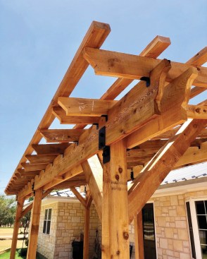

We framed the roof structure with rough-sawn western red cedar, using 6×6 material for the posts and diagonal braces, 2×12 stock for the two double beams that bear on the posts, and 2×6 stock for the rafters, which are spaced 24 inches on-center.

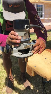

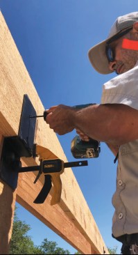

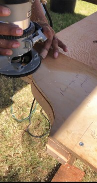

Beams. Prior to installing the double 2×12 beams, we profiled their ends using a router guided by a jig that my dad had made for previous projects. After lifting the beams into position, we connected them to the posts with black Ozco hardware that matches the post-base hardware. I’ve been fortunate to learn from multiple talented old-school crafts­people, so making jigs to minimize human error has become a natural part of the way I work.
The author used one jig to shape the ends of the double 2×12 beams…
… and another one to shape the tails of the 2×6 rafters.

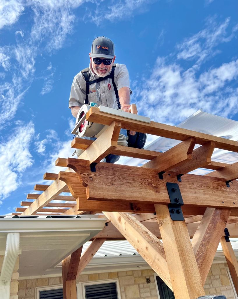

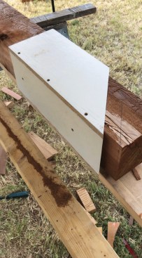

Diagonal braces. We don’t build a lot of pergolas or work with large timbers often and don’t have a beam saw with the capacity to cut through 6×6 stock in one pass. So I made a quick 45-degree jig to make the cuts for the diagonal braces; along with the jig, I used a circular saw to make clean cuts on both sides of the workpiece and then finished the cut with a reciprocating saw. To ensure nice fits, I cleaned up high spots as needed with a 24-grit sanding pad fitted to an angle grinder. I used Simpson Strong-Tie Outdoor Accents structural screws to fasten the diagonal braces to the posts.
A simple guide made out of scrap material allowed the author to make the clean and accurate 45-degree-angle cuts needed for the diagonal braces that reinforce the post-to-beam connection.

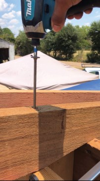

Rafters. After making the seat cuts on both the upper and lower ends of the rafters, we profiled them using a router and another jig with a slightly different profile than the one we used on the beams. We fastened the rafters to the beams 24 inches on-center with 8-inch-long Simpson Strong-Tie structural screws. On the low side of each beam, we added Ozco rafter clips, which helped plumb the rafters.
Decorative hardware was used to hang the 2×12 beams from the pergola’s 6×6 support posts.
Long structural screws were used to fasten the 2×6 rafters to the beams.

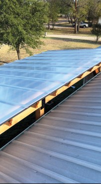

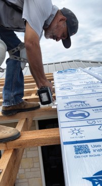

Everything needed to install the Hercules roof panels was supplied with the order, and the panels proved to be fairly simple to install. They come with a protective film on both the top and the bottom of the panel; we removed the bottom film prior to panel installation. We left the top film in place until the sheets had been installed, and even then only partially removed it along the edges to install the seam covers. Only after we finished the install did we fully remove the top film. Following the manufacturer’s instructions, we covered the top edge of each panel with the supplied vent tape, then installed the flute covers over the vent tape prior to lifting the panel up into position.
The panels are installed starting at the center and working towards both ends. They are fastened to the purlins with special metal clips.

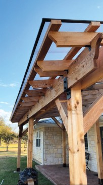

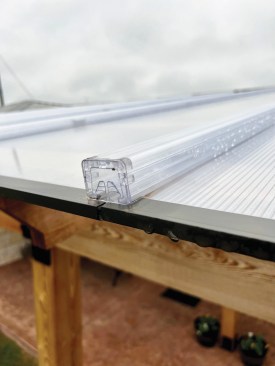

Starting at the middle of the porch, we installed the first panel using the supplied metal clips along both edges. Then we worked toward both ends of the porch, connecting each panel along one edge to the clips holding the previous panel, and fastening down the other edge with more metal clips. As each new panel was installed, we used a rubber mallet to tap down the connector caps that cover each seam. Those caps then were fitted with end caps.
Friction-fit connector caps are tapped into place with a mallet to cover the raised seams between panels and prevent leakage, then plugged with matching end caps. The ends of the hollow panels are covered with a special vent tape followed by a flute cover, allowing for ventilation while blocking access to insects (above). The outside edge of the last panel is cut to fit, then covered with a metal U-edge profile that is screwed to the purlins (right).
Raising the inner beam of the free-standing pergola above the eaves of the home’s hipped roof allows for air circulation as well as the recommended slope (1 inch in 4 feet) for the polycarbonate roof panels.
As anyone who has installed metal roofing panels can tell you, roofs are rarely perfectly square. Because these panels arrived a few inches longer than their nominal length, we could easily trim them to length and—at the edges of the porch—to width with a circular saw. Those cuts were later covered with edge U-profile trim pieces, which added another 1/2 inch to the length and width of the panel (and thus must be accounted for when calculating the size of the end panels). Stainless steel screws driven through the metal trim pieces—but not through the panels themselves—secured the perimeter of the roof covering to the framing. ❖
