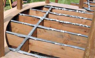

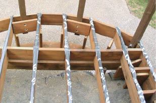

There are a few ways to protect the tops of doubled-up joists. One way to stop water from collecting in the groove in between them is to space the joists apart with pressure-treated plywood spacers (Figure 3). Because I usually flash the tops of the joists with peel-and-stick flashing, I don't need to space them (Figure 4). There are some pre-manufactured flashings on the market specifically designed for deck joists (Grace Deck Protector being one, and Joist Jackets another), but I usually cut my joist flashing from larger rolls of peel-and-stick membrane that I have on hand anyway. This saves a bit of money and gives me more flexibility for sizing the pieces when I feel more protection is needed.

Figure 4. Flashing the tops of joists with peel-and-stick membrane protects them from water and seals penetrations from decking screws.
Another advantage of the peel-and-stick flashing is that it seals around the decking screws, keeping the screw holes from taking on water over time as the framing expands and contracts. I've seen framing rot from water entering screw holes, even in pressure-treated lumber.
