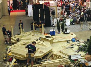

Five crews built five outstanding decks for the Deck Design Contest at Hanley Wood’s Remodeling Show in Baltimore in September. Azek, A.E.R.T. (MoistureShield), DryJoist, Tamko, Tiger Claw, and Viance sponsored the competition, and the decks were built by Maryland Deck & Hot Tubs, Westminster, Md.; the Holloway Company, Sterling, Va.; T.W. Ellis, Baldwin, Md.; T&A Contractors, Burtonsville, Md.; and Exteriors Plus, Terryville, Conn.
A panel of judges reviewed the decks, and based on overall design, chose as Best in Show the deck sponsored by Tiger Claw and Viance and built by Exteriors Plus.
The contest signaled the upcoming co-location of Deck Expo and the Remodeling Show. The first combined Deck Expo and Remodeling Show will be held in Indianapolis in November 2009. — Andy Engel
