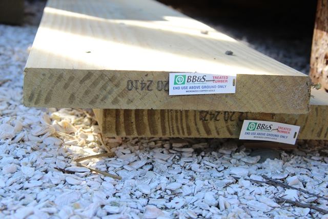

A mid-Atlantic area building materials dealer announced that its yards would no longer stock PT lumber that is not rated for ground-contact use. Maryland-based TW Perry says that it is replacing all of its above-ground UC3B-rated dimensional lumber, decking, and fencing with UC4A-rated products this winter, in time for the spring building season. The company also says that it will switch from UC4A (ground contact, general use) to heavier-duty UC4B-rated PT posts, which are suitable for severe environments and saltwater splash zones.
According to TW Perry’s treated lumber buyer Chris Purdy, the move will allow their customers to buy any piece of treated lumber from their yards without having to worry about what application the lumber can be used for. TW Perry primarily stocks Wolmanized micronized copper azole (µCA-C) treated lumber. The retention level for UC3B micronized copper azole is  0.05 pcf, while the retention level for UC4A material is 0.14 pcf. The retention level for UC4A material is 0.23 pcf.
