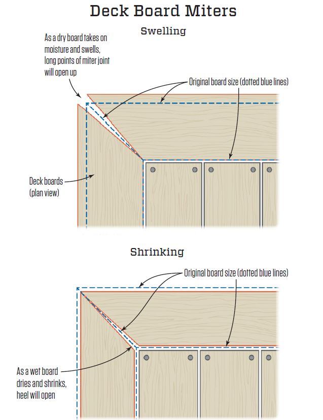

Wood acts differently. As its moisture content changes, wood expands or shrinks across the width of the board (Figure 1). This causes the miter to open at the toe (the pointy end of the cut) or the heel (the not-so-pointy end of the cut). Which part of the miter will open is related directly to the moisture content of the boards when they are installed. A wet board will dry out, causing the heel to open up. A dry board will expand as it takes on moisture, causing the toe to open up.
The dotted lines on the illustrations show the original board sizes. As a dry board takes on moisture and swells, the long points of the miter joint will open up (top); as a wet board dries and shrinks, the heel will open (bottom).
Figure 1. The dotted lines on the illustrations at left show the original board sizes. As a dry board expands with added moisture, the toe of the miter joint will open up (top); as a wet board dries and shrinks, the heel will open (bottom).
