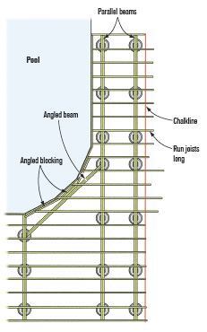

Rectangular Pool Decks
I build pool decks with beams and cantilevered joists (as opposed to structural rim beams) for a couple of reasons. When the outside and inside rims are used as beams, the footing locations need to be perfect or the posts won’t hit the corners properly; with beams and cantilevered joists, you have more flexibility. Also, when framing an aboveground-pool deck, it’s important to keep the footings at least 12 inches away from the walls of the pool, and a structural rim would require footings right next to the pool. It isn’t good to undermine the pool walls with a footing hole because it’s very easy to puncture the vinyl liner with a shovel. And if the electrician has already done his job, there may also be a continuous grounding wire close to the edge that we don’t want to cut.
My company builds mainly two types of aboveground-pool decks. One is a large rectangular deck around an oval pool (see illustration). All the decking gets installed in the same direction, and the footing and railing installation is the same as for any other rectangular deck, but with angled sections that go around the pool’s curves.
The tricky parts are handled simply with cantilevers and blocking. A pair of beams run parallel to the long wall of the pool, and shorter beams handle the load at the short end. Near the curve of the pool runs an angled beam, over which joists cantilever toward the pool. My crew will set all of the joists except the outer two without trimming them to length. Once all joists are set, a chalk line is snapped from one end to the other and the joists are cut to length in place. Angled blocking between joists, with a minimum 2-inch clearance from the edge of the pool, keeps the framing from twisting and provides solid nailing for the decking.
