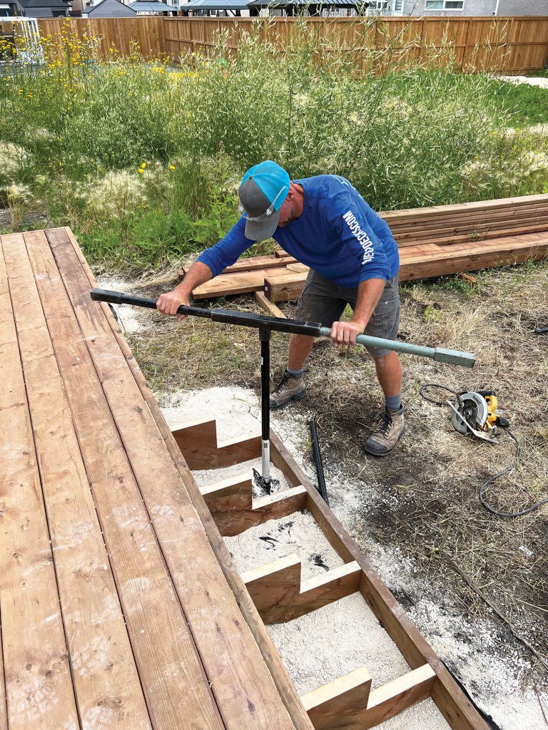

The manufacturer offers a T-shaped fitting that fits over the shaft of the screw pile; longer lengths of steel rod can be added to the fitting for more leverage (above). Once the pile is embedded in the ground, the adjustable saddle is added to the assembly (right).
It usually takes only one man to screw the pile into the ground, though a second pair of hands can be used when a little more leverage is needed. We prefer not to install the piles with our big drill, which can create too much torque and actually break the shaft. As we screw the pile into the ground, we occasionally compact the soil under the disk by using a sledgehammer to pound in a block fitted to the saddle.

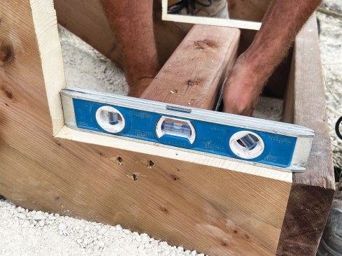

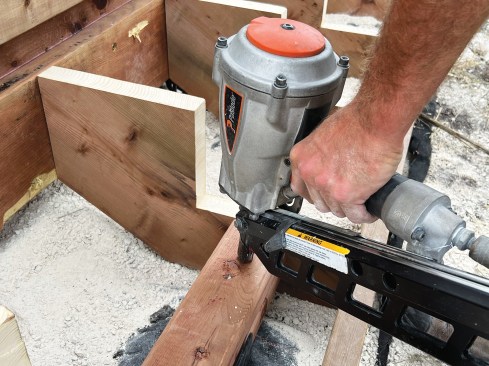

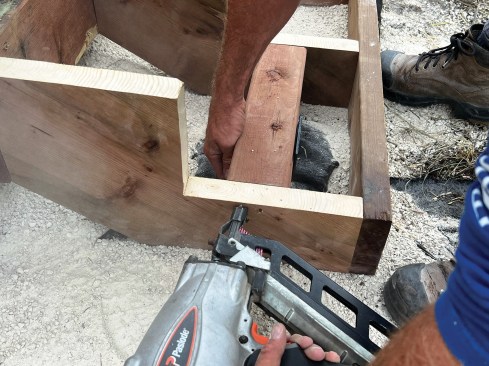

Once the top of the shaft is flush with the ground, we drop in the adjustable saddle, which can be raised up to 6 inches if needed. The saddle accommodates double 2-by pressure-treated blocking installed horizontally, which we cut to fit snugly between the stringers. After checking that the stringer is level and adjusting the saddle as needed by turning the nut on the threaded shaft, we nail off the stringers into the blocking. We also drive structural screws through the saddle into the blocking.
Here, the author is installing double 2-by blocking cut to fit between a pair of stringers.
Nails are driven through each pair of stringers supported by the screw pile into the blocking.
Once the double blocking has been nailed to the stringers, the author uses plenty of nails to fasten the pieces together.
The saddles can be adjusted by turning the nut underneath until the stringers are level. The author repeats the process for each pair of stringers until the stair is level from side to side and from front to back.
