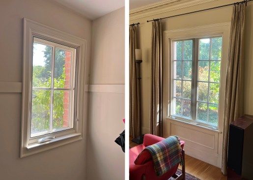

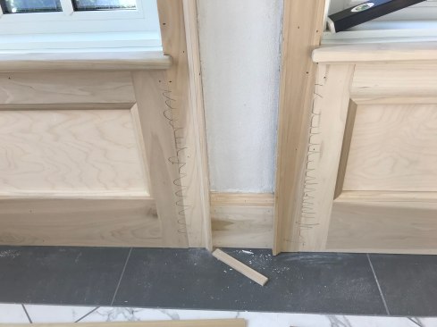

Casing that runs past the sill and continues to the floor. If the window is low to the floor, it’s not uncommon to have the side casing run all the way down. It’s worth noting that in most cases, the casing runs to the floor. It doesn’t run just to the top of the baseboard. Instead, the baseboard is interrupted by the casing so the panel infill reads almost like a “separate furnishing,” or like a door. The area below the window is filled by a stile-and-rail panel that is independent from any baseboard or wainscoting that may or may not be included in the room.
A picture-frame casing with an overlapping stool. When the windows aren’t close to the floor, I sometimes see (and reproduce) a picture frame around the entire opening with a stool added below the window. In that case, the stool has very short “horns” that lap onto the face of the side casings. These overlapping horns do not extend past the side casings, as is typical for a traditional window stool. For the amount of overlap, I’ve seen a range, from about 1 inch of overlap down to about 1/4 inch.

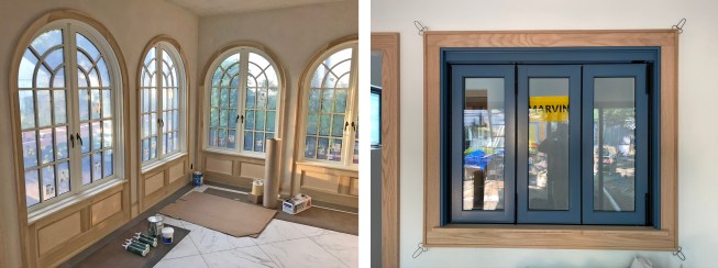

While common for ornate interiors, such as this Tudor Revival interior trimmed out by the author (left), the modified stool also suits the clean lines of a Spanish Colonial Mission style home (right), where the author reproduced the trim style found throughout the home around an interior window separating an office space from a glassed-in porch.

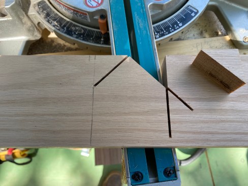

Once I have the window set and my jamb extensions are figured out so they flush to the interior wall, I case the window. I rarely miter the corners when picture-framing a window unless that’s already an established look in the home. Most of the time I butt join the corners because it’s more stable, and staying true to the period of the older homes I typically work in, it’s how most traditional casing was typically done. Miters tend to open either at the toe or the heel as wood shrinks across the width of the board. With a miter, this shrinkage of both meeting boards adds up. A butt joint, on the other hand, “sees” only half of this shrinkage. If the casing has a profiled edge, I typically cut a jack miter where only the profiled edge is mitered and the flat of the board is cut straight to receive the butt end of the meeting board.

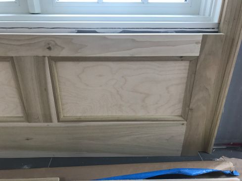

If the area below the window will be filled, I set all the panels between the casings before I install the stool. The panel can be tricky sometimes because the stiles are often flush to casing, and depending on how flat the wall is, these two don’t always track together and may need to be sanded flush.

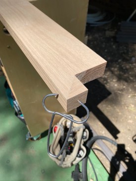

When installing the stool, I almost always cut a miter return on the ends of the overlapping horns, particularly with stain-grade work. That’s because on stain-grade work, the end grain will stain much darker and always ends up looking like the proverbial sore thumb—unless you cut a miter return. For painted work, you can round over the end grain at the end of the horn, though the painter may need to fill this grain to smooth it out. The horns are a small detail, but they make the difference between a seamless finish and one that draws the wrong kind of attention.
