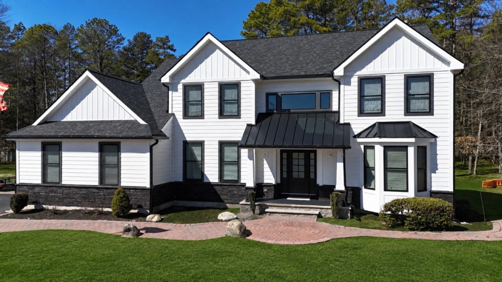

That mindset has shaped Monmouth Vinyl’s reputation over 52 years in business. The company completes roughly 60 projects a year, and LaPietra now works alongside his son, Joseph, and daughter, Jenna. But the company’s identity was built around a particular idea: Vinyl siding does not have to flatten the character out of a house.
“As a siding contractor, we cut our teeth on siding,” LaPietra says. “The thing we’re most noted for is the details.”
It didn’t always used to be that way. For years, vinyl siding was not especially sympathetic to older homes with distinctive trim, deeper shadow lines, or historical exterior details. Homeowners who wanted maintenance freedom often had to accept a simpler look.
That began to change in the early to mid-1980s, when manufacturers introduced more detailed vinyl components—crown moldings, beaded soffits, window lineals, corner posts with cove moldings, and other profiles that made it possible to get closer to the original design.
Monmouth Vinyl gravitated toward those products immediately. The work was more demanding, but it fit the way LaPietra wanted to build. Every house had its own quirks, and every detail had to be thought through rather than covered over.
“A lot of customers don’t want to change the look of the house,” he says. “They just want to make it maintenance-free. Now we can do both things—make it maintenance-free and preserve the details.”
