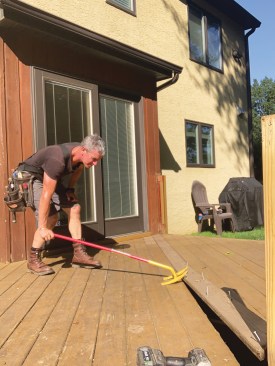

Put a bunch of deck building carpenters in a room, and you’ll get 10 sets of preferred methods, tools, and levers for quickly dismantling a deck. I’ve tried approaches such as cutting up the existing decking with a circ saw or chain saw (definite “no thank you” to the chain saw; I prefer not to be feathered in the rooster tail of chips shooting out everywhere). I’ve also tried various levers, none of which I find better than the uber-useful and effective, carpenter-designed NestorBar wrecking bar I prefer. It works both as a breaker bar and a lever.
The author began by removing the rails. Then he used a NestorBar to pry up the decking, starting from the center.

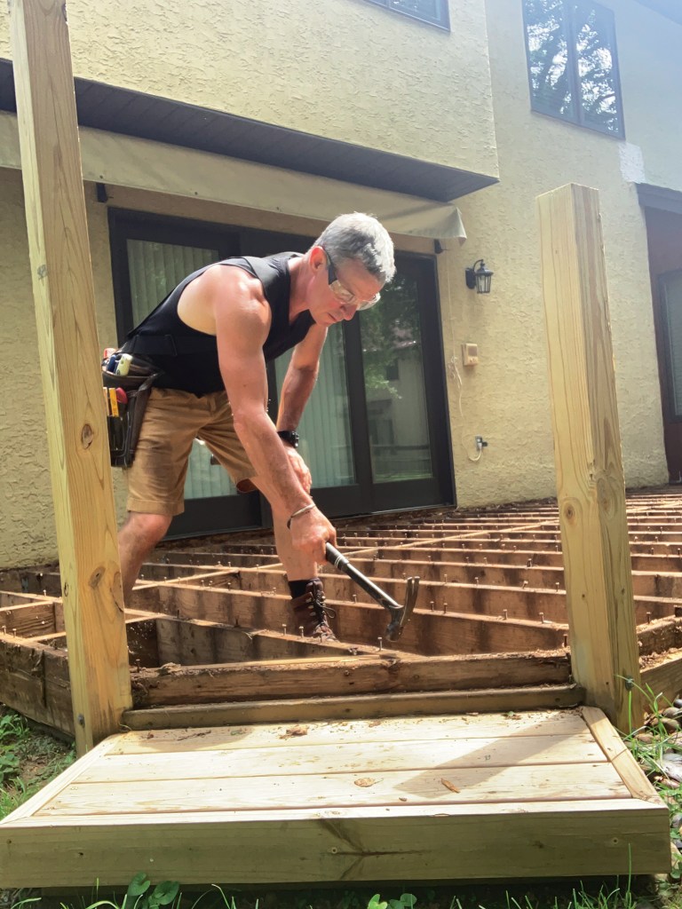

First, though, I try to back out any fasteners I can, especially with PT decking. Some screws come out. Others … well, the second the bit skids out, that’s it, and I’ve found there’s no payback in trying to get after it. For cedar, like the deck shown in this article, it’s almost moot. The NestorBar’s perfect fetch pulls boards right through the screws and I break them off later.
On diagonal decking, I like to start on a long board in the field. Using a NestorBar and a set screw, I can lift a board, get some levers under it, and pop it off. Then, with the NestorBar’s front and back claws, I can work from the center in either direction.
Some guard rails can be pulled apart by hand; those that can’t, I unbolt and unscrew. Bashing stuff might save time upfront, but I lose it in the end picking up splinters and shards and fixing what I moved or broke.
Pulling up deck boards often leaves screws embedded in the framing. When the author can’t break off a fastener with a hammer, he cuts it off flush with the framing with an angle grinder.

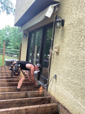

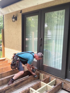

With the frame exposed, I inspect whatever connections I can and make an assessment. That typically means driving a pair of structural screws per joist bay into the ledger. I use 5/16-inch-diameter, 6-inch-long Spax PowerLags with a washer head; they invariably suck the ledger tightly back to the house.
On a deck with post-to-beam connections, I drive the same screws into those connections to reinforce them. On the project shown here, a patio deck over a concrete slab, I dropped a few 2×6 blocks to the slab to help support some longer spans and stiffen things up (Figure 2).
Once the existing framing is exposed, the author reinforces it with additional structural screws driven through the ledger into the rim joist and blocking as needed.
A lot of organic debris had built up in the quarter-century this deck had been in place. Disrupting it made me cough up a lung, so I spent a couple of hours blowing off the debris and rinsing off the slab. I’m the only person who knows those couple of hours were spent doing that, but I sleep better at night when a jobsite is clean and tidy.
Fasteners and joists. What fasteners don’t break off with a hammer—hello, eye protection—I beat back into the framing. Fasteners I can’t reach with my Estwing I cut flush with the framing using an angle grinder.
After the fasteners are gone, I apply joist tape to the tops of the joists and beams. I’ve used brands that have writing on them or that peel like duct tape, but I prefer Spax peel-and-stick, pressure-sensitive tape. It’s easier to use and doesn’t have lettering that shows through the gaps between decking boards. Whatever tape I use, I’ve found that a sharp, 25mm, snap-off knife is by far the best tool to cut it.
Last thing, I make sure to roll flashing tape along the top of the ledger and up the side of the house a little ways. Most of the time, the ledger is unflashed; 25 years ago, nobody gave a second thought to flashing.

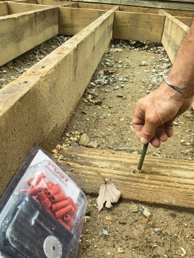

Added preservative. The chemical treatment in deck and fence posts degrades just at and below grade over time. I visually inspect posts and poke them with an awl, and they are almost always intact. However, that condition can’t last forever, so I’ve started using Post Proservative, a product new to the consumer market but one that utility companies have used for decades to re-treat utility poles. It’s a dehydrated stick of fungicide and wood preservative in the form of a fused glass rod that inserts into a drilled hole. Here, I used it in the grade beam, but I’ve also used it on PT support posts that extend below grade. Once the wood reaches the right moisture level, the chemical liquefies and is drawn into the wood fibers via capillary action. It’s a simple add-on and upsell.
To extend the life of the PT framing that is in contact with the ground, the author inserts Post Proservative rods containing a fungicide and wood preservative into holes bored into the wood.

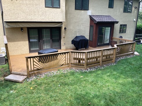

New Decking

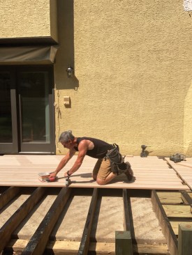

Using Acre on this deck allowed me to get the tight looks composite installation techniques deliver—namely, parting boards and nicely divided sections of decking rather than just an ocean of deck space.
And I can skip most of the difficult, time-consuming elements associated with composites—blocks galore, fighting picture-frame miters closed—with no sacrifice in overall look. Acre is uniform all the way through, so there’s no need to hide the ends or cut edges.
While many deck builders insist that decking should start at the outside band and work inward, leaving a ripped board at the house, I prefer to start with a full board at the house. Getting as parallel as I can to the front band is my main layout concern when I snap the chalk line for the starter board.
After covering the tops of the joists with self-adhering flashing tape, the author installs the new decking. On this project, he used Modern Mill’s Acre decking, a composite material made from upcycled rice hulls and PVC that can be cut like wood and can be stained or painted.
Another thing I like about Acre is that it is not shiny. If there is a low joist or the deck frame is lumpy, there is no penalty to me. When there are low spots, like at a parting board, I keep some 30-pound felt paper handy like flooring installers do and pack it up as needed.
Camo. On this project, I used Camo hidden fasteners (I always tell customers they’re harder to see; they’re not invisible). With easily 1,500 screws on a deck like this, I try to root out any wasted motion mercilessly. The number of moves required to position your body, the tool, the clips, and the fasteners is not nothing. Finding a way to move all those things in four moves instead of eight (times 1,500) puts money in my pocket.

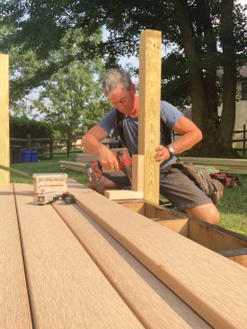

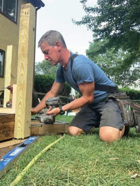

I start by screwing an L-block made with scrap 2-by stock 9 inches up from the bottom of the 4×4 post. Then I drive three 5/16-inch-diameter, 6-inch-long Spax structural screws with washer heads into the post. After setting the post tight to the band joist, I drive a single 3-inch screw in through the L-block into the band, which holds the post in place while I check it for plumb. Then I just snug one structural screw, replumb the post in both directions, and set the second screw, shimming as needed. This second one I drive home, crushing the 4×4’s wood fibers. I recheck for plumb, adjust and shim as necessary, then drive in the third screw. The top and bottom screws I set on the left side of the post; I set the center screw on the right. Using structural screws instead of drilling holes for through-bolts gives me 100% wood-fiber engagement, such that when the wood shrinks, and even if the shims fall out, the post remains slammed in.
An L-block temporarily fastened to a post helps to hold it in position ….
… while the author drives structural screws through the post and into the framing.
Is this detail drawn in the code? No. Will hobbling this connection cause catastrophic damage to the deck frame? 100%. Do I spend money and time on hardware that’s arguably not necessary? Nope.

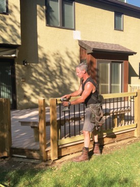

Balusters. The DekPro aluminum baluster and bracket system is fast and easy to install. Layout is a snap. It’s tough as nails and just as easy to maintain after the fact. I use it on new construction as often as I do on re-skins.
The author likes to use DekPro's aluminum balusters, a low-maintenance alternative to wood balusters that are available in both round and square profiles.

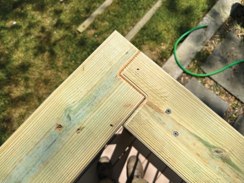

Top cap. For those of you proud of your miters in PT the day you finish building your decks, you should be. You dialed them in. Two weeks later, however, as the lumber dries, the toes of each miter shrink toward each other while the heels retreat, resulting in a miter that opens about 3/8 inch.
I’ve landed on an alternative I call a “stepped” transition. I use it to transition mid-span rail caps and to get around corners. The basic idea is that all the opposing grain moves together. If it all shrinks, the opening is even along the step. If it all swells, same thing. Basically, however, it stays where I put it.
To hold it in place, I screw it down to the post. I also predrill two 1-inch pilot holes with a 3/8-inch paddle bit in each ear and drive #10 x 3-inch screws into the pilot holes.
On the top rail, the author uses the stepped transition shown here at corners and when joining two top rail sections together mid-span.
