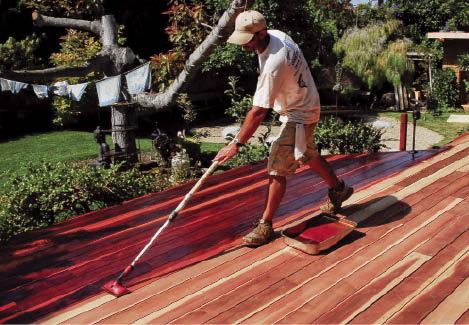

Figure 1. While traditional water-repelling clear finishes allow wood to gray from the sun, colored products block UV-rays for further protection. Toners, like the red shown here, and semi-transparent stains allow grain to show through. Solid stains, like the white and the blue, hide the grain and provide the most protection from UV rays. Photo by The Thompson's Company.
