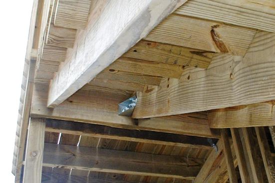

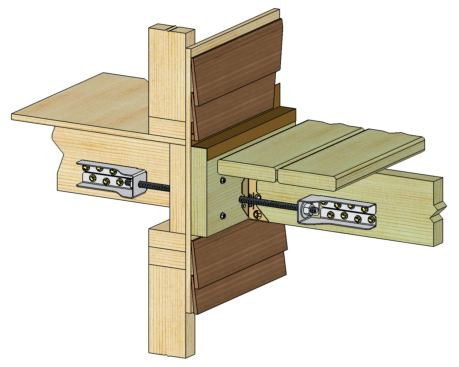

If your jurisdiction has adopted the lateral attachment details in the 2009 and 2012 IRC, you’ll need more than just bolts or screws to attach the ledger to the house. Unless you have an engineered solution that your building department will sign off on, combatting the lateral forces that a deck is subjected to requires special brackets that bolt through the ledger and band joist to mechanically attach the deck joists to the house’s floor joists.
None are simple to install and all require access to the house’s floor-joist system — not fun if you’ve got a finished floor and ceiling to deal with. Simpson’s bracket, the DTT2, takes a 1/2-inch-diameter machine bolt and USP’s DTB-TZ bracket can take a bolt or threaded rod. For these brackets, the manufacturer’s details show the house and floor joists in line with each other. There are alternative details that allow these brackets to work when the ledger is parallel to the joists, but it’s up to the local building inspector whether or not to accept that installation (Structure, January/February 2012).
A bracket made by DeckLok can also be used to provide lateral support. Two DeckLok brackets are needed at each lateral-support location. One bracket through-bolts to the deck joists and through the deck ledger and band joist. A second bracket through-bolts to the house joist and through the band joist and ledger, locking all members together. One advantage is that the house and floor joists can be offset. A disadvantage is cost: Compared with Simpson and USP brackets that cost approximately $11 a pair, DeckLok brackets cost $22 a pair (or $44 a pair for stainless). None of the manufacturers include the necessary machine bolts or threaded rod with the brackets.

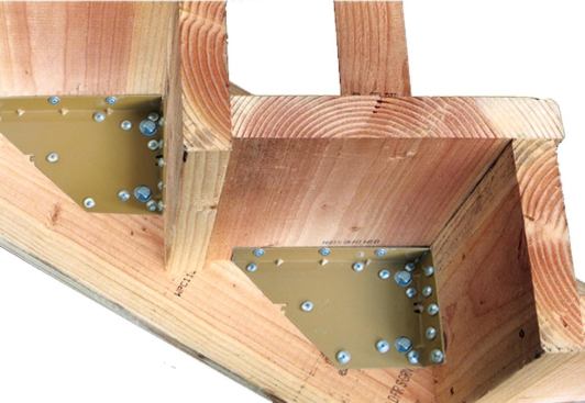

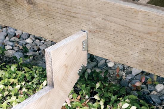

Not surprisingly, there is also structural hardware to attach stair stringers to deck framing. (The code prohibits toenails or “nails subject to withdrawal.”) Simpson’s adjustable LSC brackets get fastened to the framing and then bent onto and fastened to the bottom and sides of the stringers. Left- and right-hand brackets are available so that the hardware is concealed to the inside of the stringer. USP’s stringer bracket, CSH-TZ, is similar but reversible, so “handed” versions are not necessary for concealment. Adjustable stringer brackets cost about $5 each.
DeckLok brackets can also be used to secure stringers to framing. These brackets have one bolt hole on one leg of their L-shape and two on the other leg. The company’s president, Jim Miller, says, “It’s important to remember that the two-hole leg of the bracket always gets fastened to the floor joist or stringer — whatever member would be most subject to withdrawal. The one-hole side of the bracket gets bolted to the rim joist or ledger.”

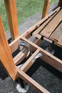

It’s easy to understand why people worry about railing-post failures. If you wanted to pry apart a deck frame, you’d probably use something long with a lot of leverage — like a typical railing post.
Hardware can help offset the leveraging power of the post by transferring it to the floor-joist system. Simpson, USP, and DeckLok lateral support brackets can be used for post-to-framing connections (“Code-Compliant Railing Posts,” May/June 2011).

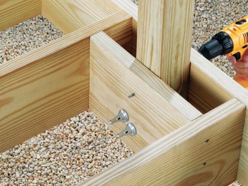

EZ Stairs makes bracket sets that take the guesswork out of building stair stringers (Decking News, March/April 2008). A single EZ Stairs bracket can be used to make a strong, code-compliant (according to the company’s website) post-to-stringer connection on a set of stairs.
To use the bracket, sandwich the stringer between post and bracket with two through-bolts. The post gets its ultimate strength from the bracket being screwed both to the blocking between the stringers and to the stair treads. A pair of EZ Stairs brackets (enough for two posts) costs about $13, fasteners not included.
